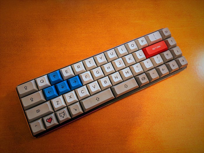

This is a good example of using a standard keycap set on a Qisan 49.
You’ll likely want to avoid keycaps with a sculpted profile as some of the sculpted keycaps (left side mods and 1u novelties) will be the wrong profile for the row they end up on.
Welcome to the world of 40s and non-standard layouts. I’d recommend looking for uniform profile (DSA/XDA/Uniform SA/etc) keycap sets if you don’t care about legend accuracy as it’s a lot easier to mix and match that way (uniform blanks are especially good with crazy layouts). In that case, you would just need to count the number of caps at each size and make sure the set has enough. Unfortunately sculpted sets like Cherry and OEM are not going to be easy to find physical compatibility. edit: if the backspace is 1.5u, I believe https://novelkeys.com/collections/keycaps/products/osa-sleeves will work. but might be worth double-checking
huhsh: Where did you get those keycaps in the picture? Looks like they might be close to what I want.

Not mine in the picture, I pulled that from the article I linked. They appear to be DSA Granite or a clone though. If you are just trying to replace the alphas (characters,letters) something like these could work and come in a range of colors to choose from. I have a set of the pink ABS keycaps that I’m using on just the alphas/numbers of a prebuilt TKL.
