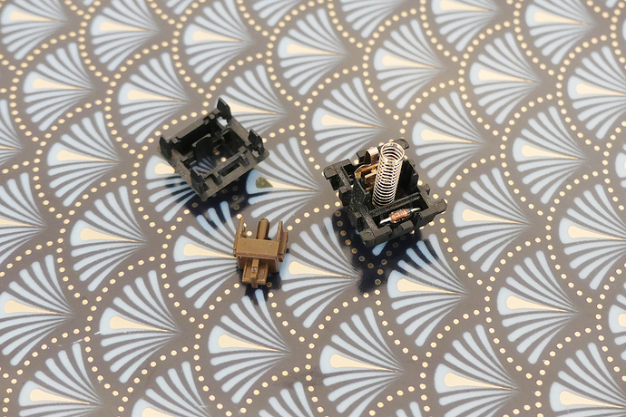

Question about old Cherry MX

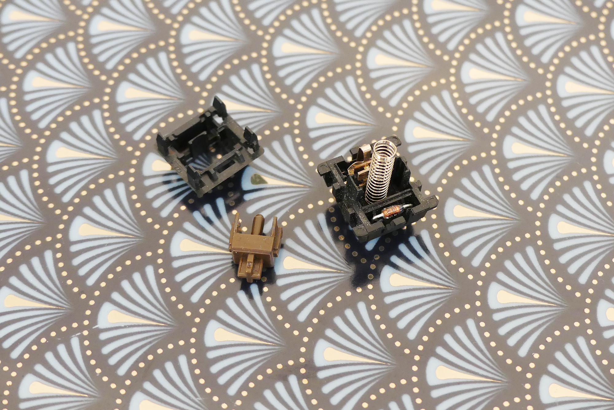

Hello, i have a question about old cherry MX Brown switches from old G80, they have an electronic component in place of the LED, i’m a noob in electronic, can you say me what it is and why it’s here ?
Can i remove it if i want to use that switches on a modern DIY keyboard ?
A real big thanks for a stupid question :blush:

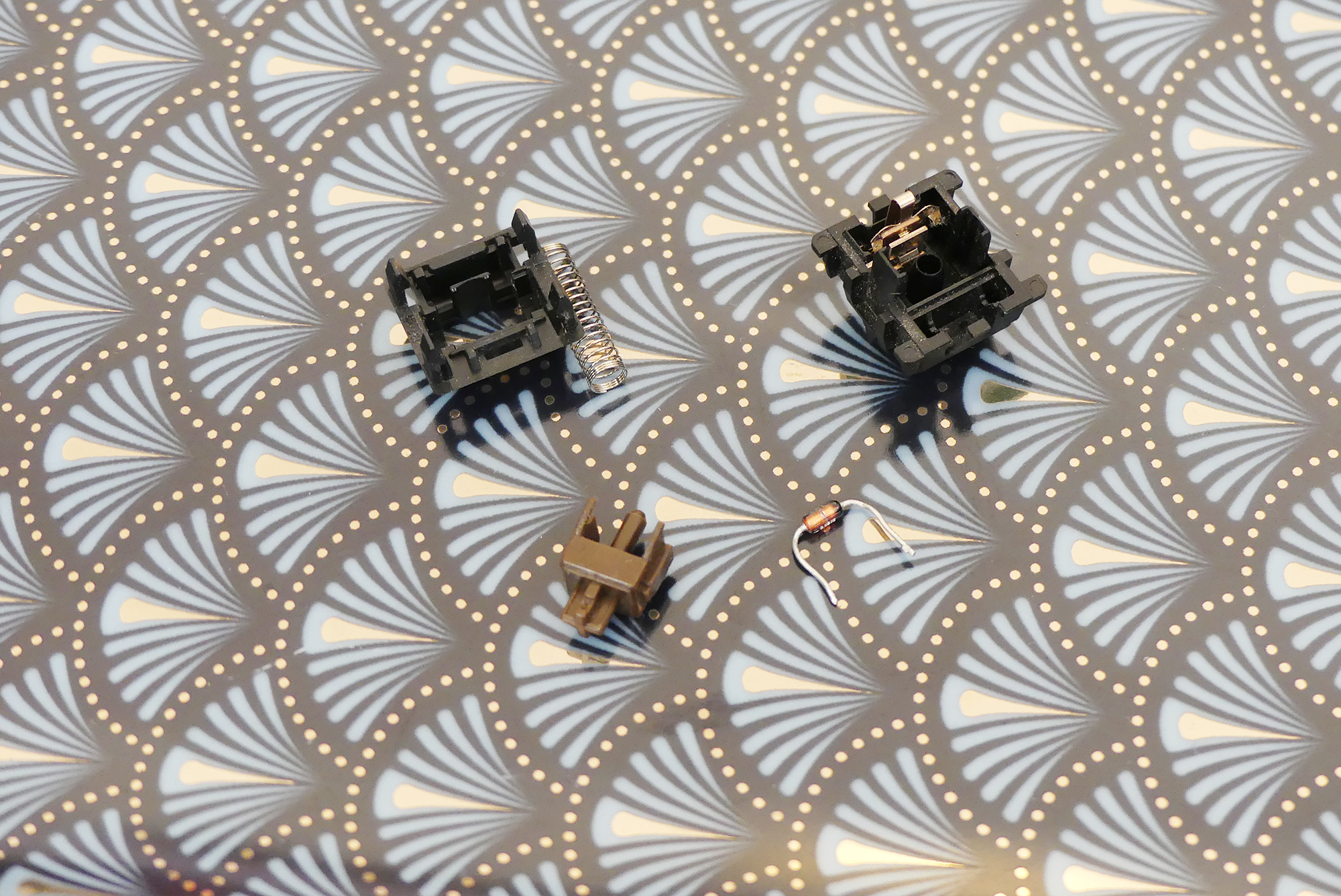

That looks like a diode, used to have Nkey rollover. You can remove it.
A big thanks :slight_smile:

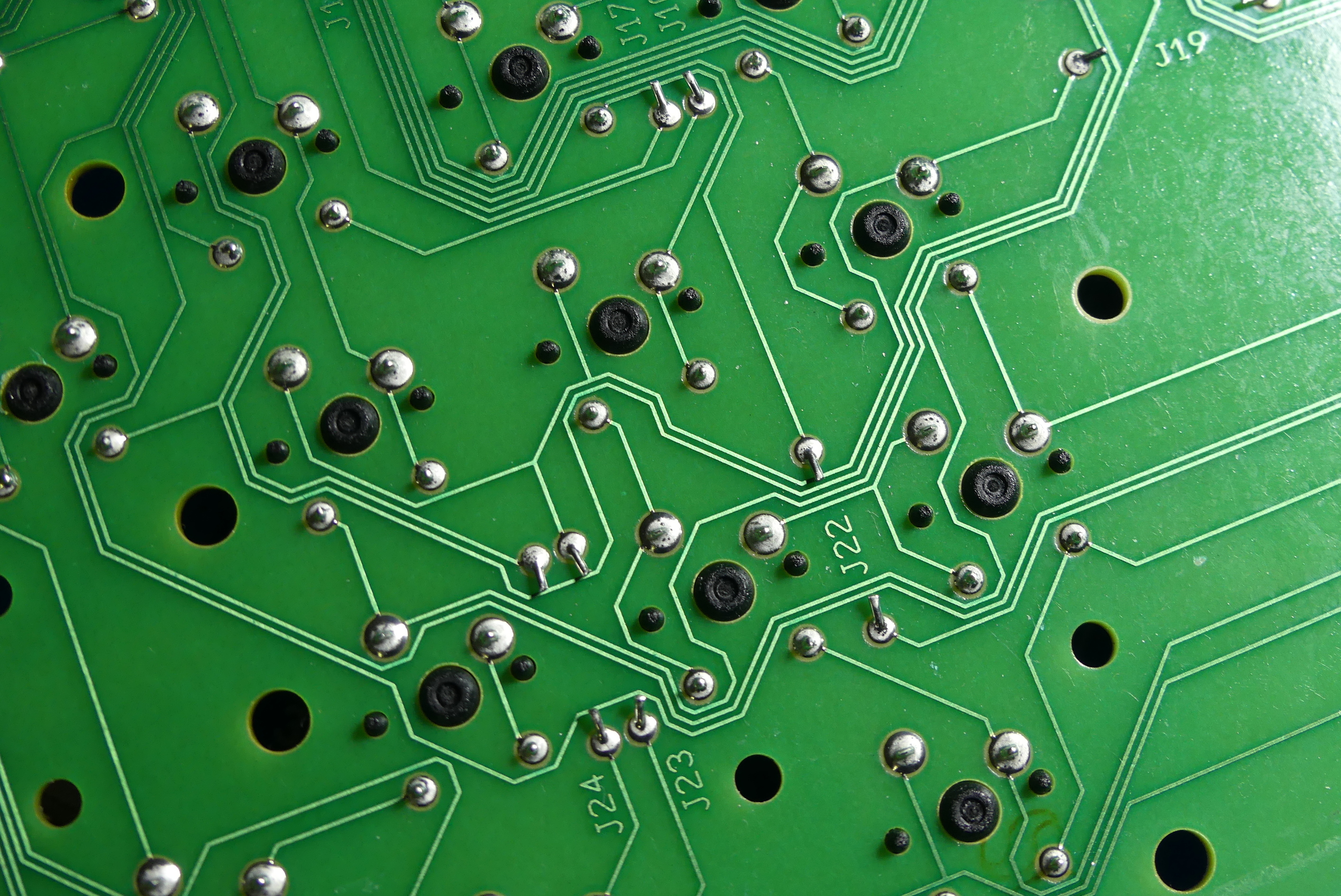

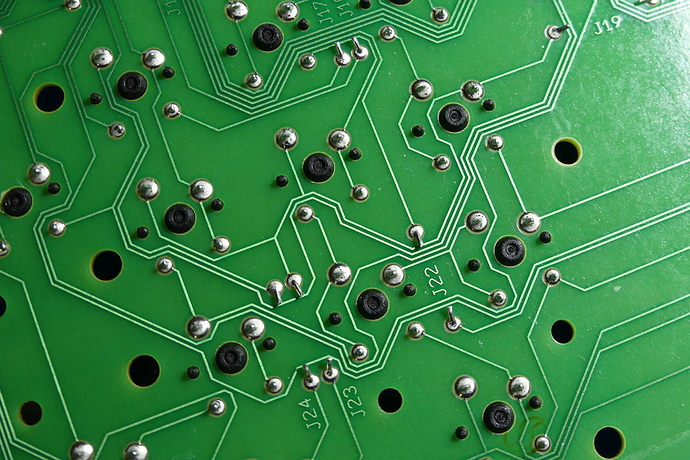

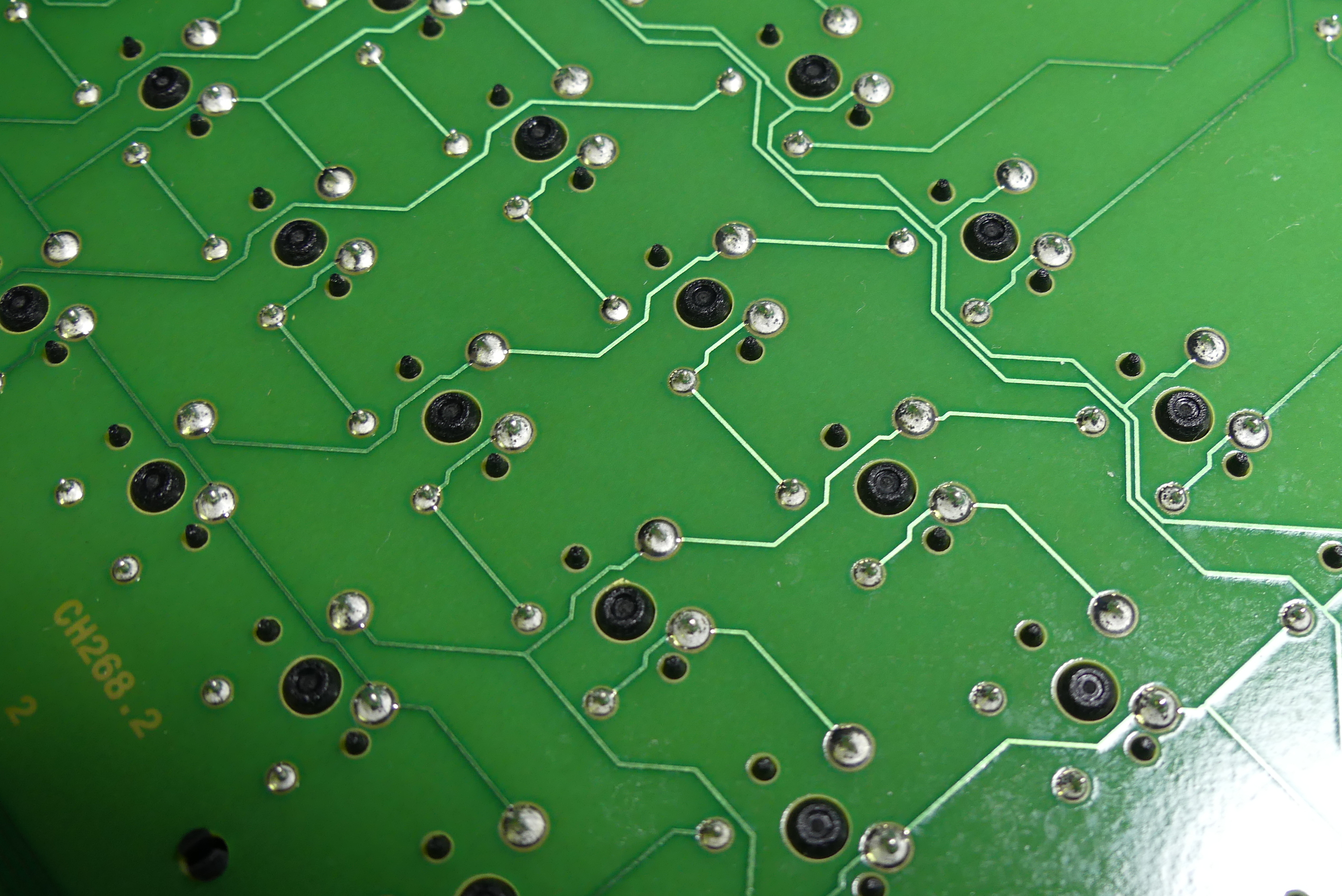

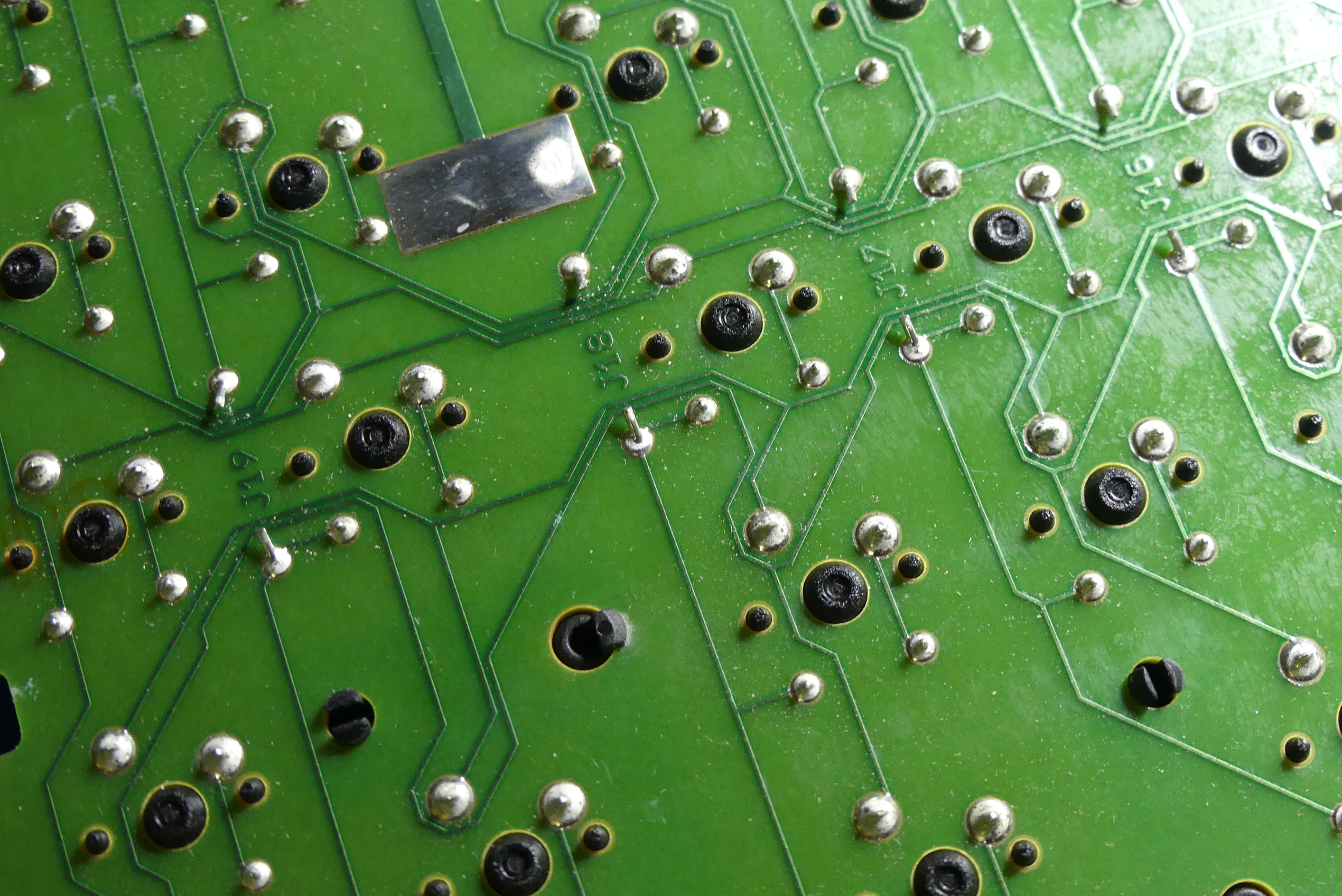

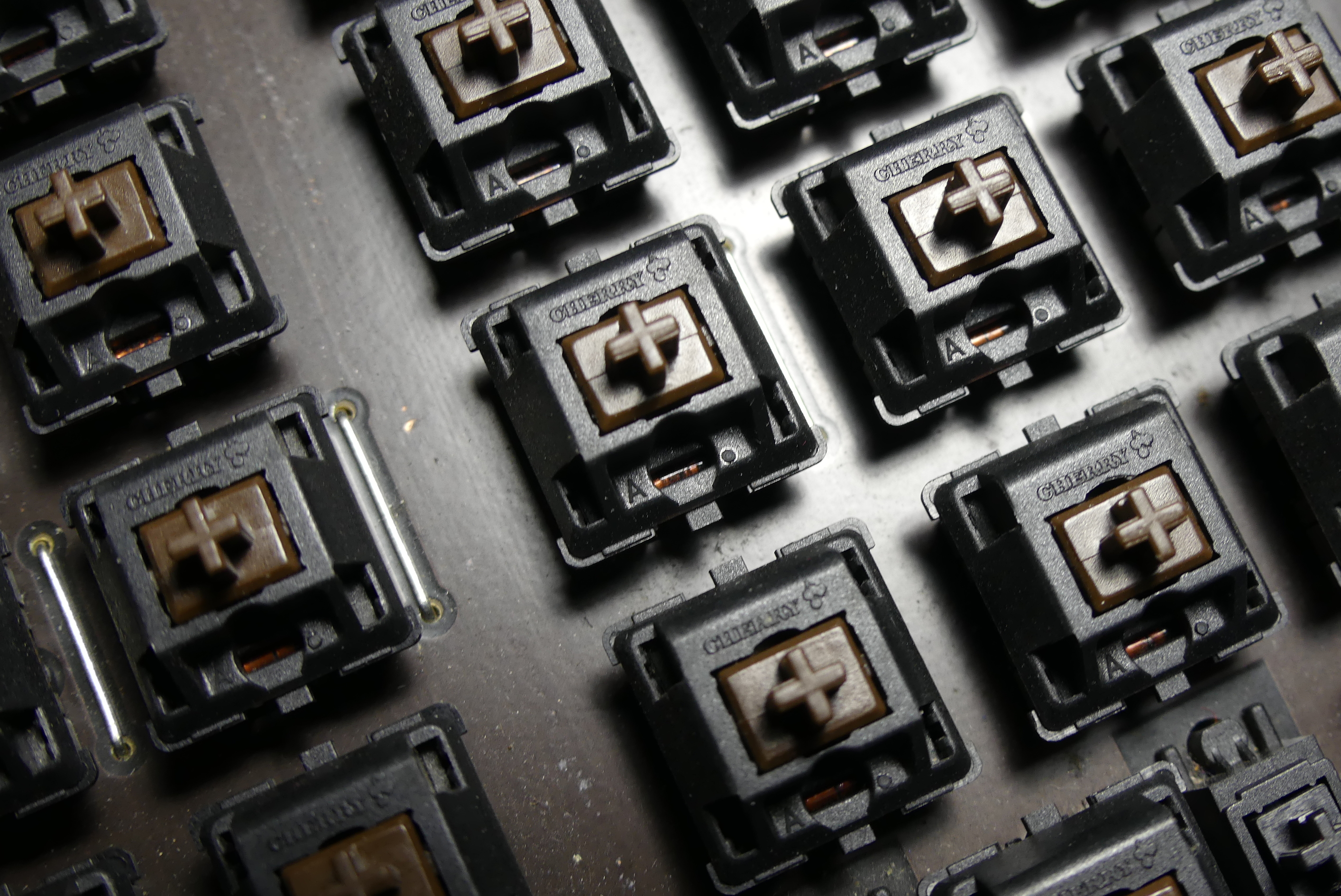

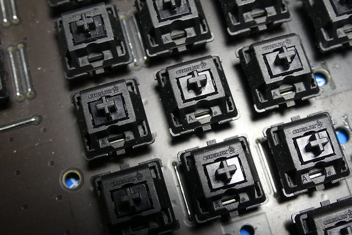

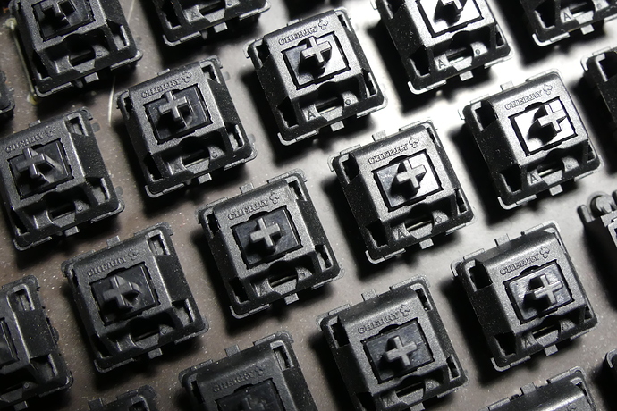

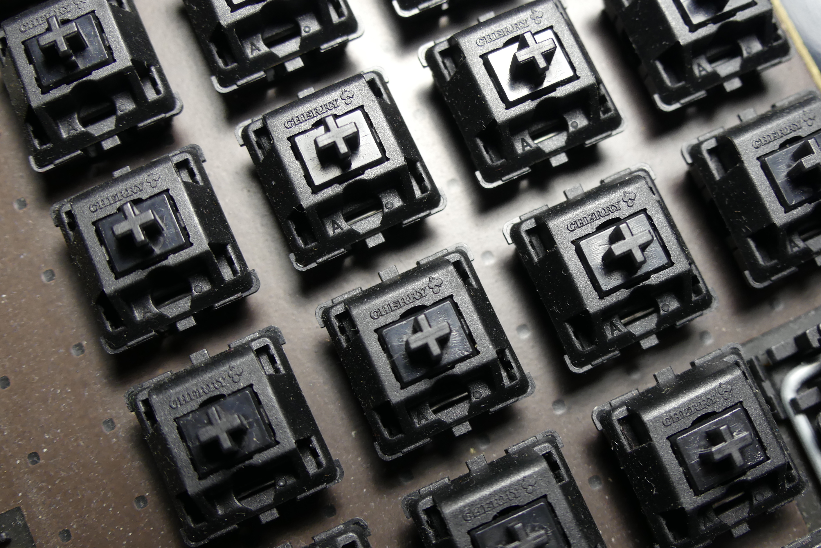

I have made pics of some of the Cherry boards i have :slight_smile:
1) G80-3000 MX Black, no Diode but a "U"
2) G80-8200 MX Brown, Diode
3) G80-1800 MX Black, no Diode but a "U"
4) G80-11900 MX Black, no Diode but a "U"

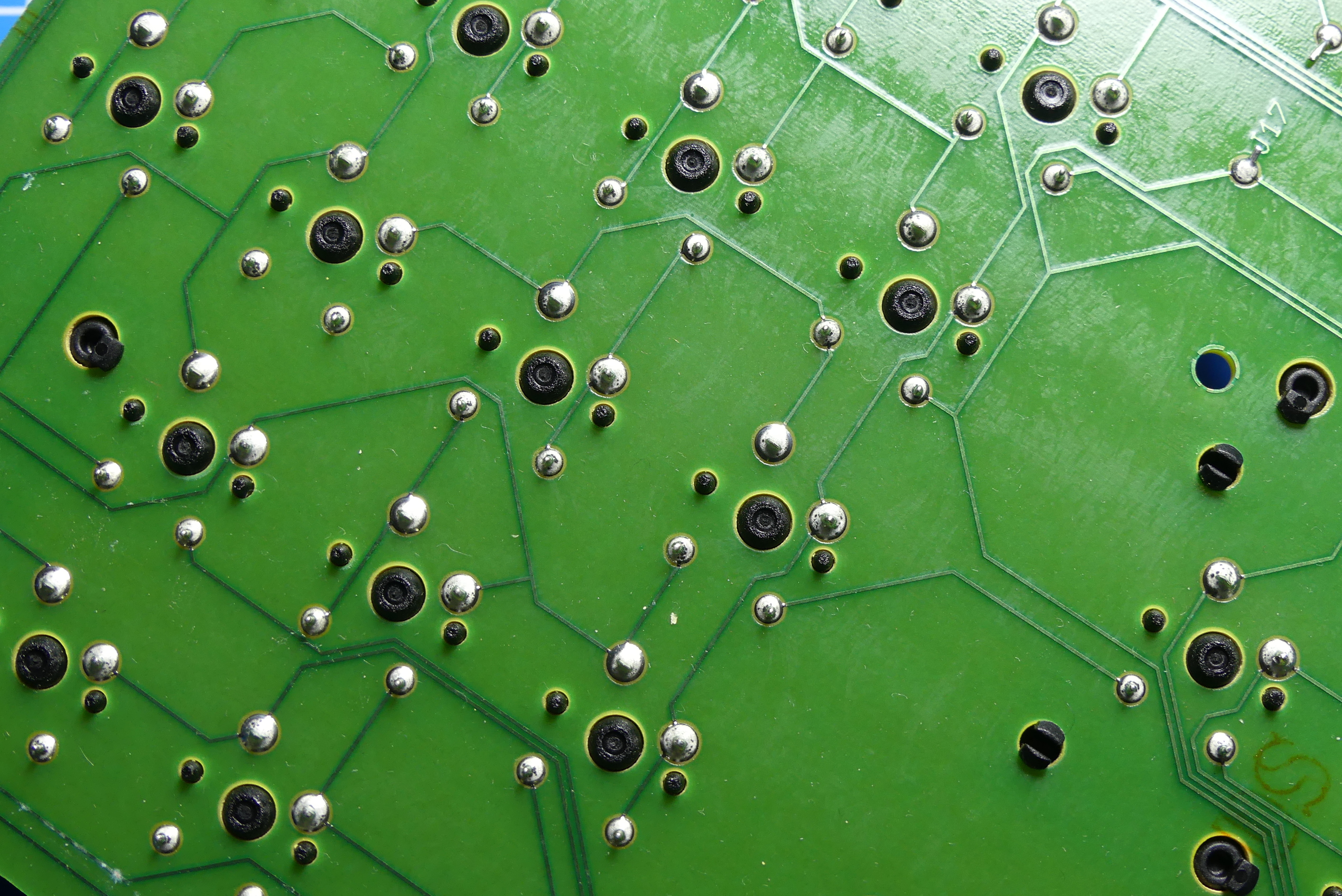

For all the boards, no diode on the PCB… And we can see that the “U” are also used on the CPU, they are connected.
Wait, the metal bar IS connected?
It’s seems, look at the last PCB, on all switches, the two big soldering points are the for the switch and the two smalls are for the metal bar in “U”.
What in the world could that be for, then?
Looks like possibly making the PCB design simpler? Not all of them are connected to anything, and the ones that are seem to be bridging a connection that would otherwise have to go on a different layer because of other traces going between those points.
No idea, it’s why i ask the question, can i remove them ? Now it appears that on modern PCB, we don’t need them, so, i can open all the switches and remove that strange metal bar or diode before mounting them on a modern PCB :slight_smile:
That’s what i’m thinking too, making the PCB simpler and stabilize the switches by 4 soldering points instead of two.
