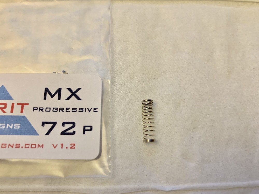

I have build a few switches using these [usually Spirit 63.5 and 68P] and I am placing the tightly-coiled part of the spring towards the top.
This issue was discussed here previously, as seen in this photo of the ‘correct’ orientation:
So is this the ‘correct’ orientation?
