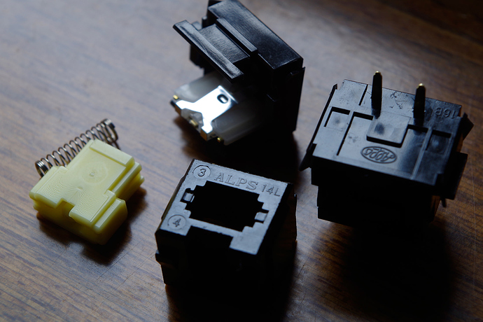

If you want some good linear Alps switches, you may want to take a look at these SKCL Yellows from China. These are the more desireable and better complicated variety of Alps. I have them myself in a Zenith handwiring project that’s on hold, and they are very smooth, but I really suggest you lube them. They require 58.8cN of force, which was 60g if I remember correctly.
I personally don’t think they are as good as SKCL Greens, but they are still great switches, especially new old stock.
Link to the page that has them
(image belongs to DrClick on Deskthority)
