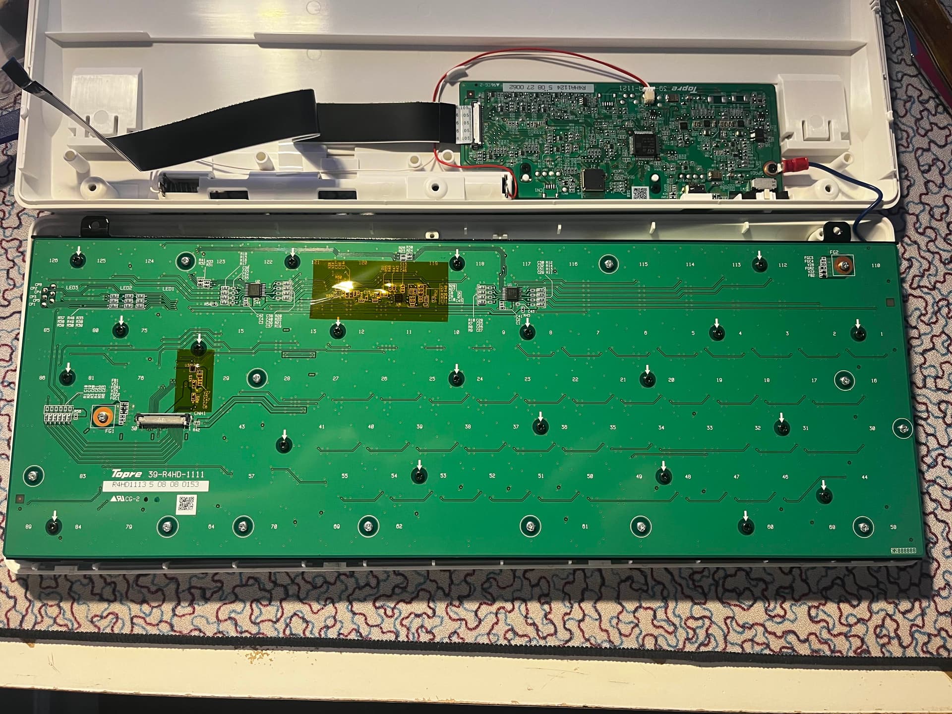

Here is a pic of the bottom of the PCB. The black tape was a bit weird.. It was just covering some components which on other spots of the PCB are not covered.. There was no spot of interference with the case or wires that I could see for why they put it there.. I just left it alone since it’s not in the way.
21x black screws - seem to be the same as any other RealForce board.
12x silver screws - seem to be the same as any other RealForce board.

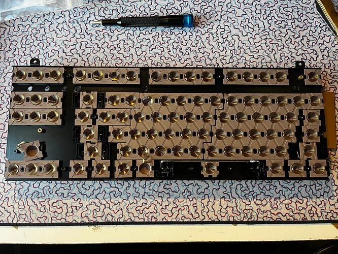

Now we are inside! Nothing too crazy in here.. They only lubed the spacebar with what looks like 205g0. No purple 2u on this one.. very odd they only did that for the RC1. Also we see normal spacebar housings on this one. Everything seems pretty standard and normal… Well… Except one thing..

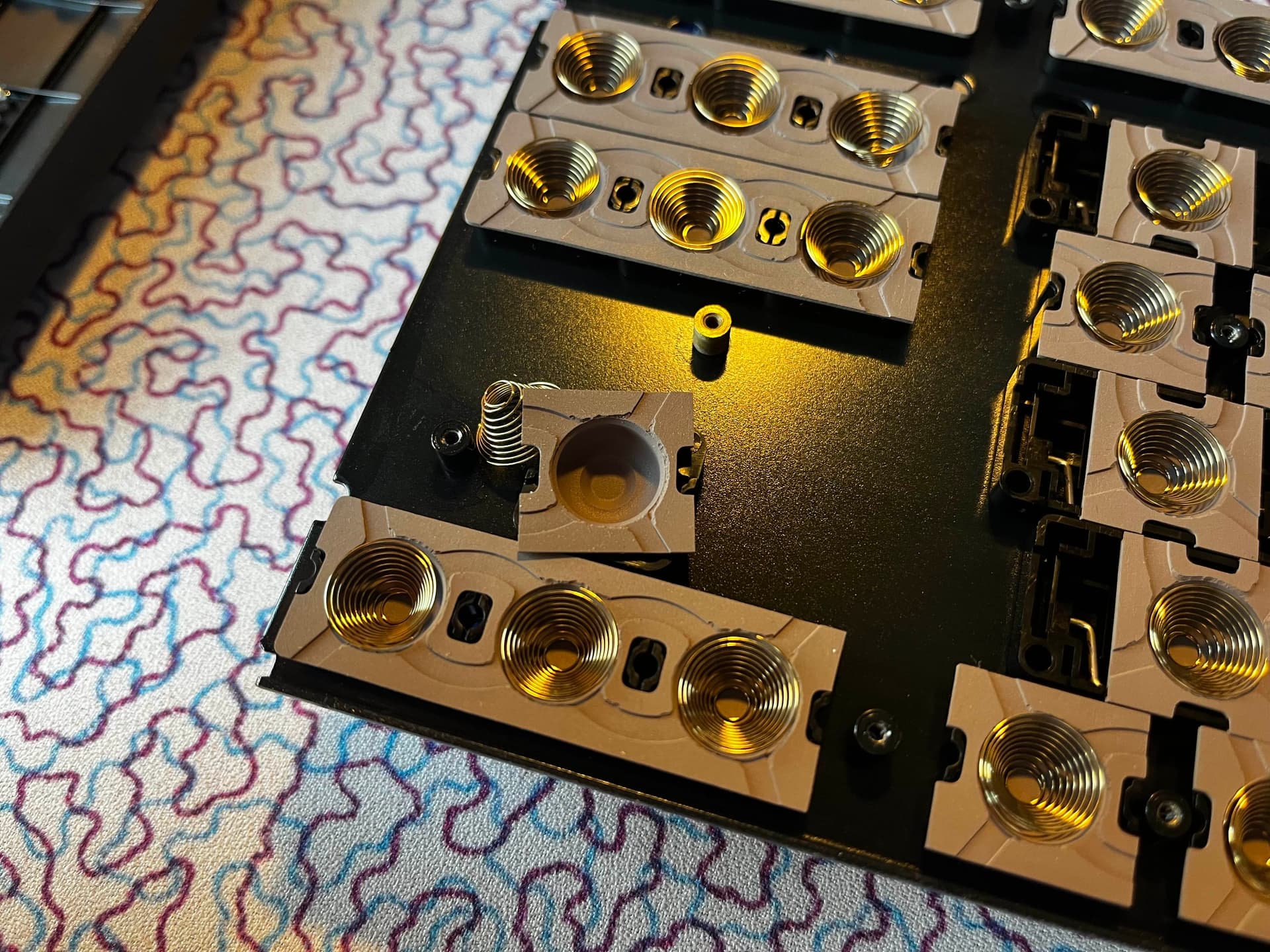

The domes are very… unusual. They seem either poorly removed from the mold that made them (possible these are getting old now), or degraded for some reason.. Also the texture is weird. They are SUPER sticky/grippy compared to other RealForce generation domes. Totally different feeling, and honestly really hard to get the alignment of the spring due to the grip they have. I don’t know why they are like this, they feel normal when typing but clearly are different.
Here is a comparison of the R4 domes (right) and a pair of domes from an R2. You can see how degraded the R4 ones look compared to the older R2 domes.. and the feel.. you can’t capture it on a picture. It feels like they are a new or different material, or mine were just covered in some adhesive or something…

Those domes look really rough. Strange.
Thanks! Yeah I don’t understand why they are like that… Again they feel fine when typing, just very odd. Maybe old molds that aren’t releasing as well.
The material looks different in those pictures. Seems like a risky thing to mess with the formulation. I think it’s also possible their molds might be in need of replacement.
Indeed, I wonder how those dome passed inspection.

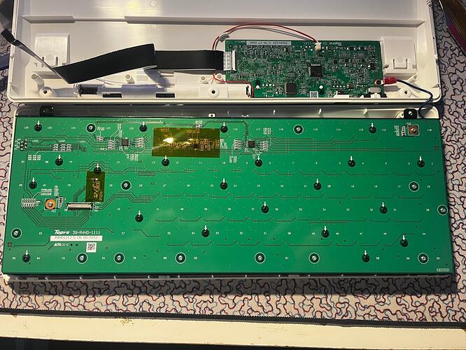

After seeing the state of your domes I had to crack open my R4 to check and see if yours was just a fluke.
One notable difference was the use of cellophane tape on my PCB instead of your black tape, achieves the same effect I guess but an odd thing to change nonetheless.
Sadly it looks like my domes are pitted as well. Holding them in my hands i can definitely see what you were talking about when you said they were sticky, they almost feel like sticky tack.
Another thing I noticed was that while the dome sheets are also oddly sticky they aren’t pitted at all while every one of the 1-4 dome strips are pitted. This means (to me at least) that their molds are worn out and its not this weird new rubber formula they’re using causing the pitting.

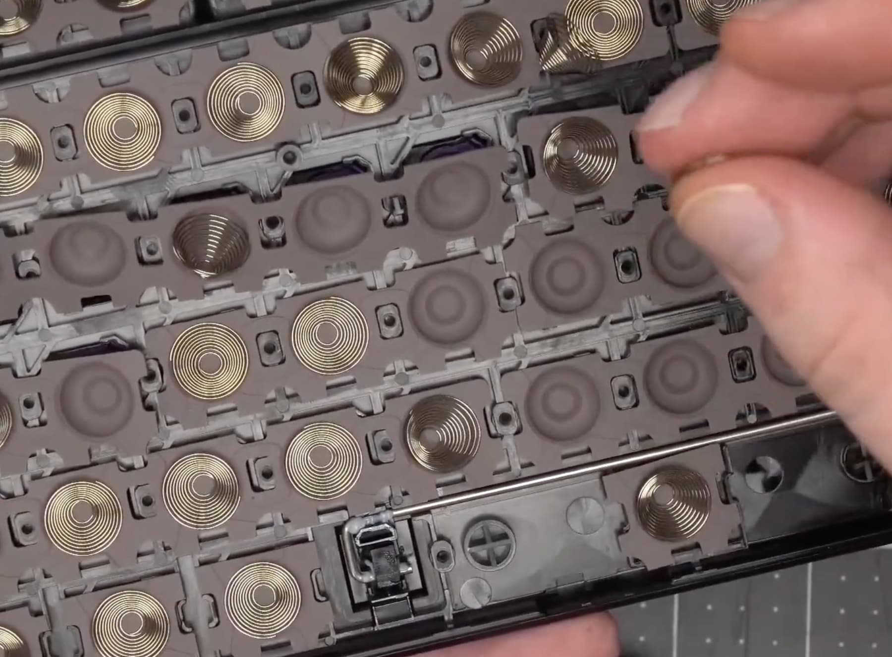

I find it fascinating, the Unreal Keyboards teardown showed different domes, which they had loud complaints about:
