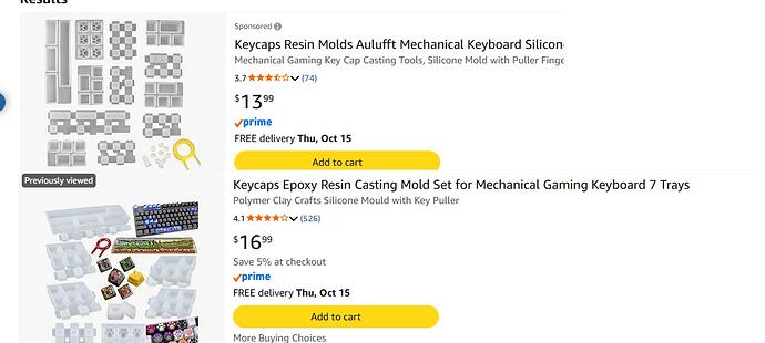

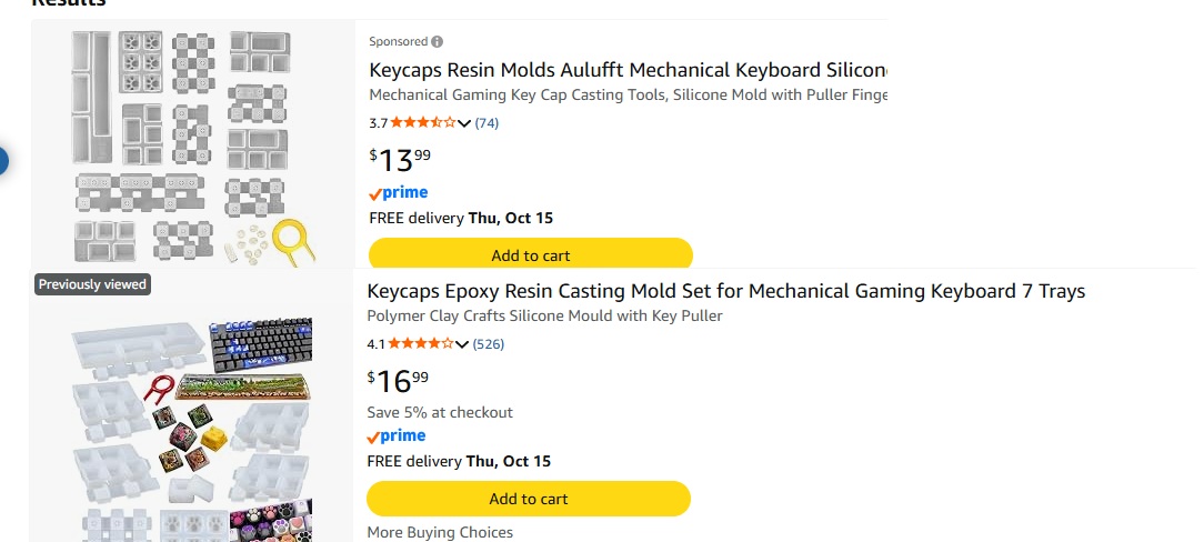

Hello! I was hoping for some recommendations for a keycap resin mold or kit that has all the keys from 30% all the way to 100% or several smaller ones If need be. I see several “kits” on places like amazon but I am not sure if they contain all of the keys would also prefer cherry profile for ergonomics but not a requirement. But I dont know if they even exist, as im just diving into this stuff. My whole idea behind it is I own a comic and card shop and eventually would like to offer custom keycap sets for my customers. Any advise or whatever would be greatly appreciated I hope you have a blessed day and thank you for looking!
Welcome to the resin rabbit hole. Those cheap tray kits from your screenshot are a decent way to practice before committing to a full set. I cast keycaps in resin, and bubbles cost me more time than anything else early on, so I would plan for a lot of failed pulls before selling anything. If you want to get rid of bubbles for good, a pressure pot is worth getting: curing under pressure squeezes any trapped bubbles down so small they are hard to see. Are you thinking blank caps with printed legends, or sculpted designs tied to your comics and cards?
