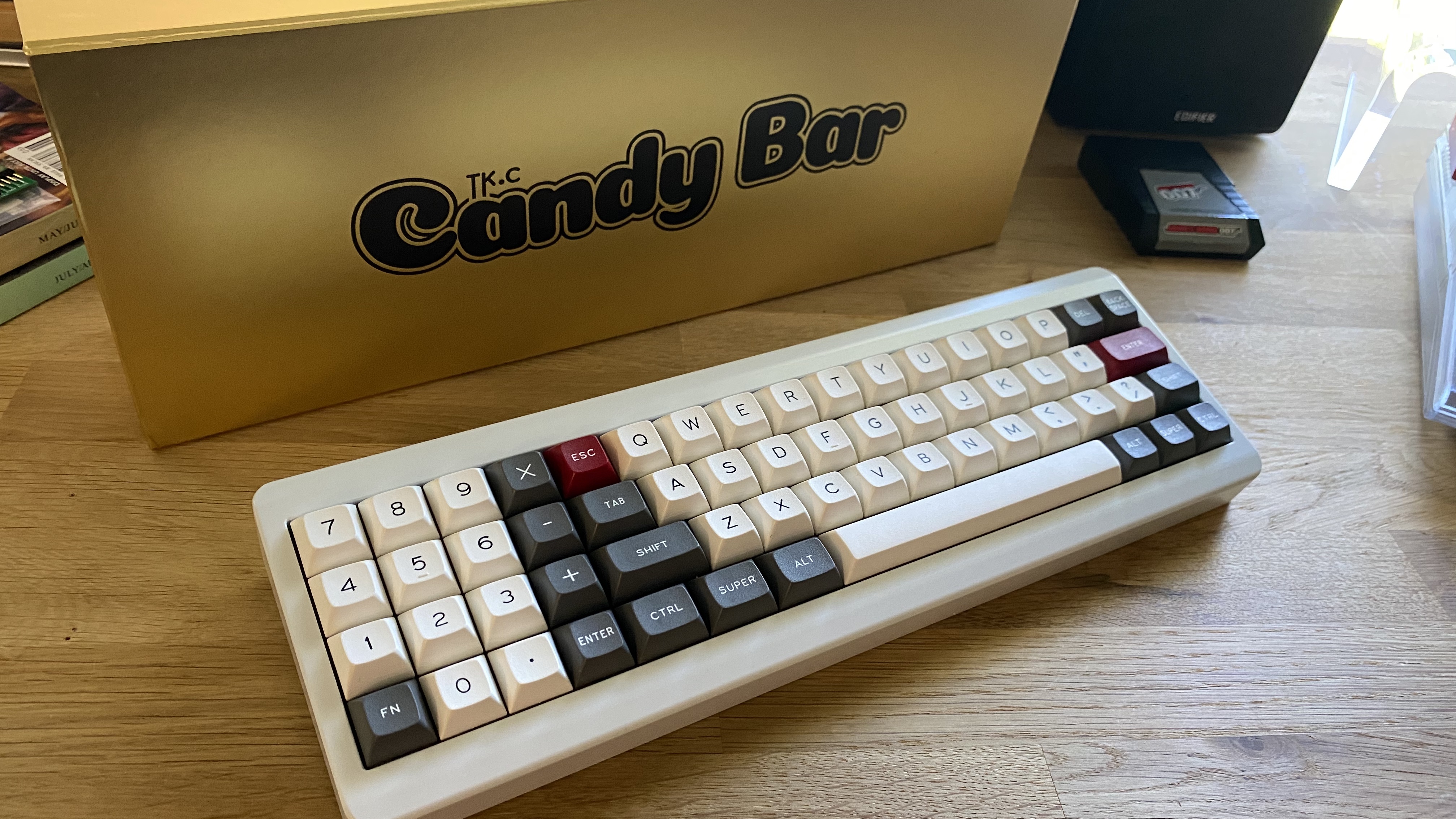

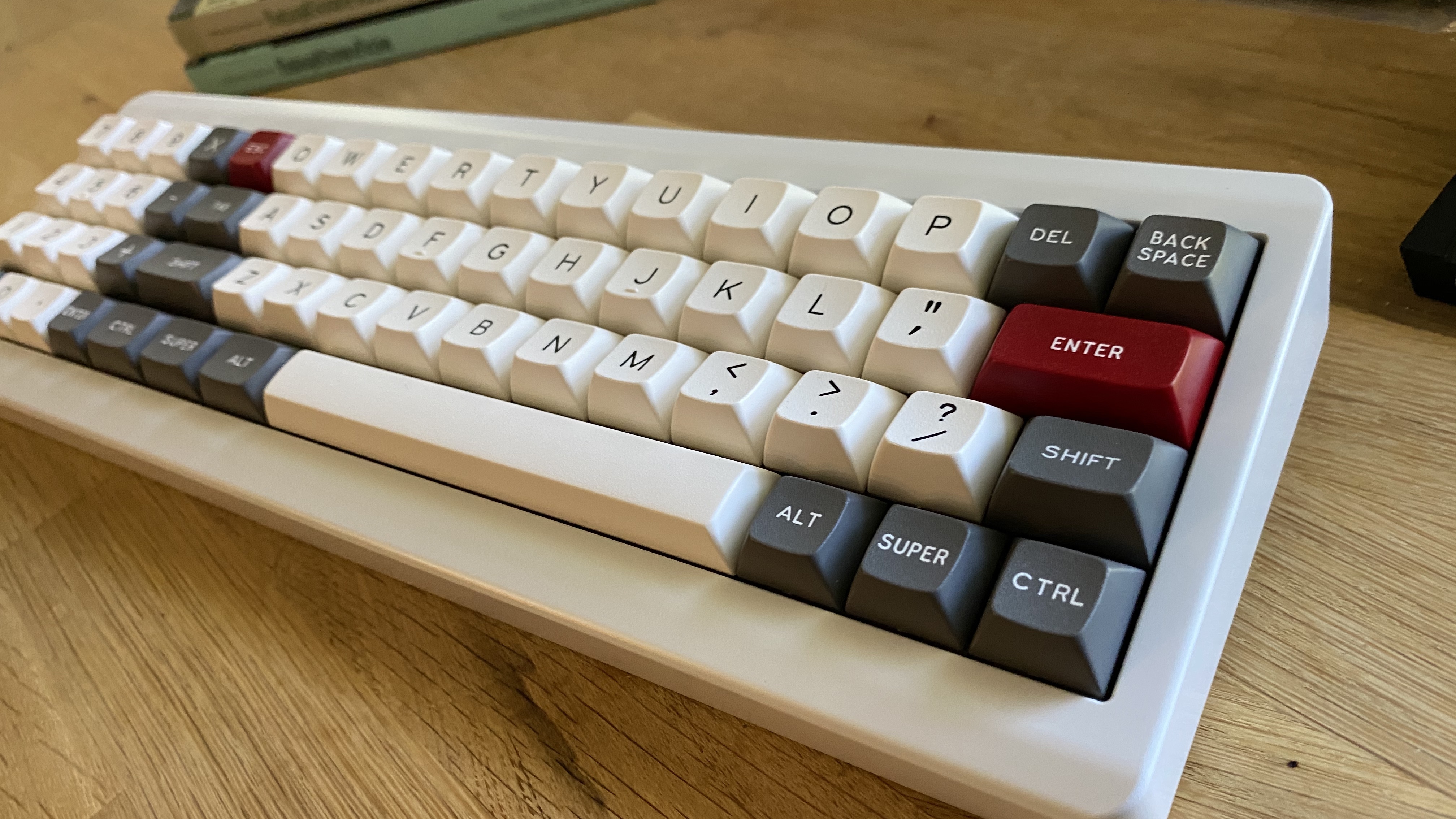

Since it was released last year I have been intrigued by the TKC Candybar - I love 40% keyboards and southpaw keyboards, so this seemed like a natural fit for me. I was not a fan of the round 1 colors, but recently picked up a round 2 in white.
Yes it is tray mount, but in underserved form factors like 40% Southpaw I think it is perfectly acceptable.
I have been using it for the last 24 hours and I think I have a good handle on it.

I built mine with Holy Pandas and ABS DSS Honeywell and the results are LOUD!
