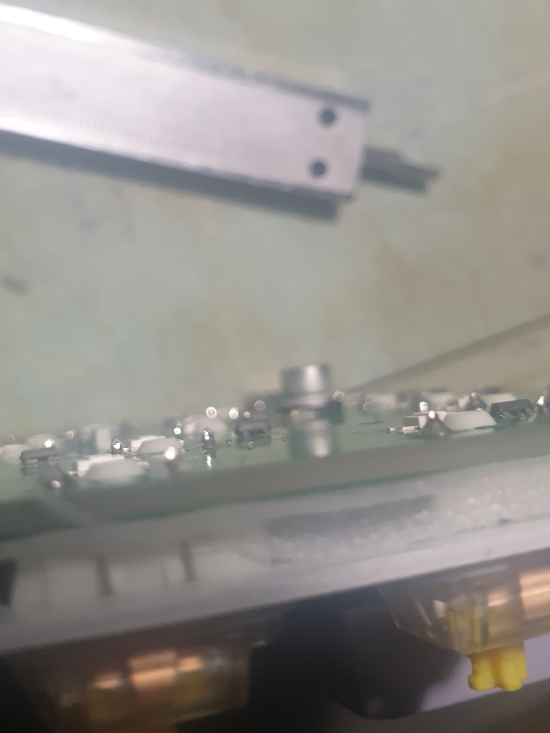

I just did as you said with warped pcb. Changed stab wires. Pressed on the edges and soldered 4 corner switches and one center switch. Others were soldered without pressure. However i still found that some of the remaining switches could be pressed just a little bit further with very minimal difference. So i though that it shouldn’t be a problem. But stabs are still scraping.
On the photo you can see the most drastic difference i can find between left and right switch. Could this be the reason for stabs to scrape?
Unless it’s the stabilized switch for the stab that is scraping I doubt that small height difference would matter. It sounds like the plate or PCB is just too warped to be used honestly.
