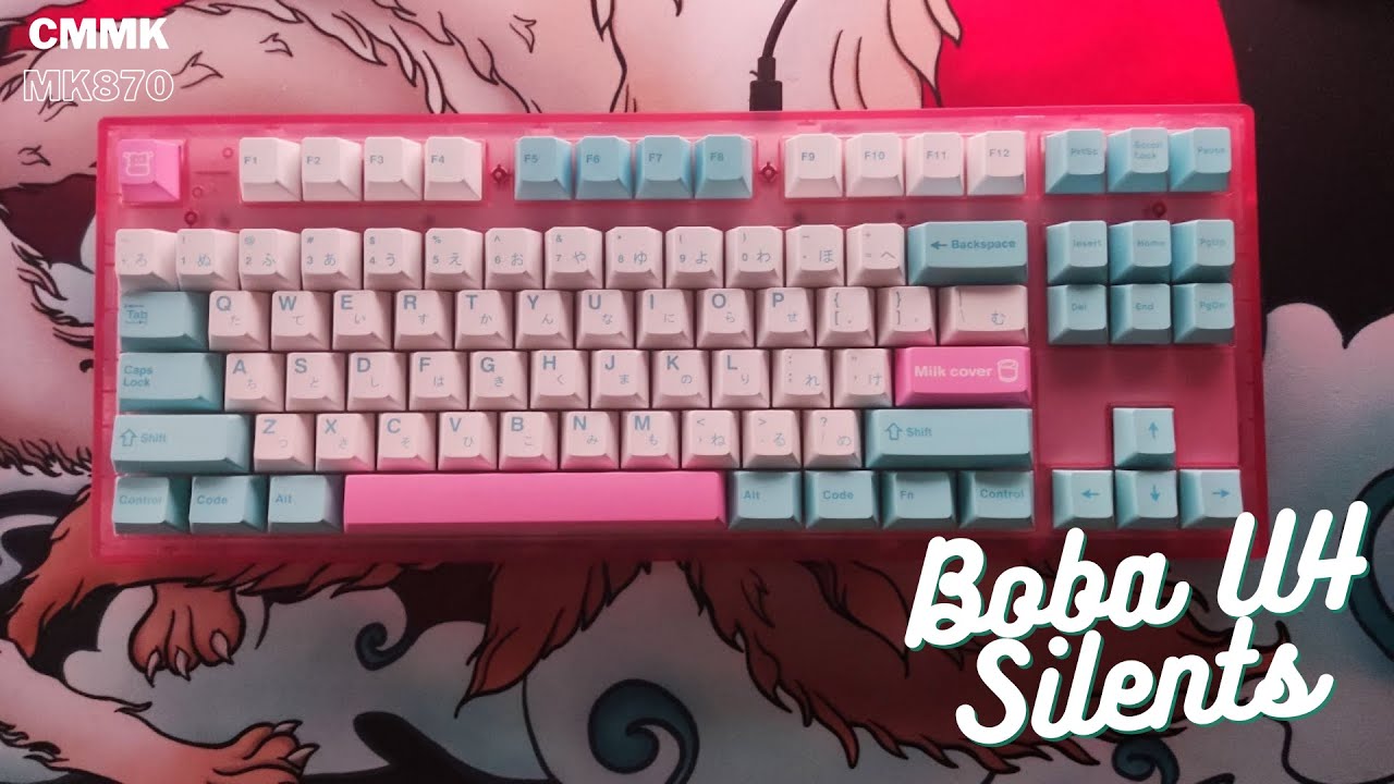

Another board for you to seriously consider is the FL ESPORTS MK870.
https://www.aliexpress.com/item/1005003366650362.html
They are about $58 USD right now, but I’ve seen them go almost $15 lower during sales. Like, maybe after the Chinese New Year festivities end, there will be another sale.
I have one, and they are spectacular value for-the-price. Better than anything you could get at that price even a year ago. South-facing LEDs [which is the best for avoiding weird noises and other problems], pre-lubed stabilizers that are actually decent.
Mine is modded already [polycarbonate plate, PCB-mount stabilizers], I didn’t even test silent switches with the stock configuration.
But I’m getting another one in a week or two, in stock configuration. I could tell you then if silent switches are quiet in the MK870. I already know that clicky switches sound fine in a stock MK870 I customized for a friend. So if silent switches are good in default configuration, it could be even easier than AK87.

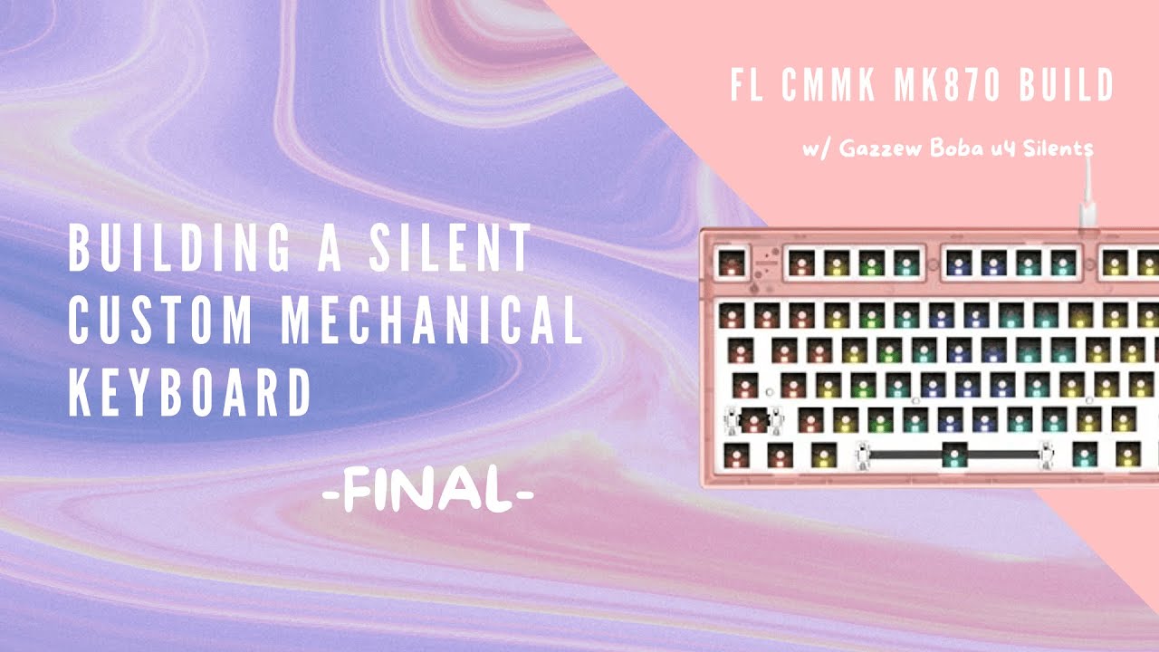

EDIT: UPDATE
If you look at the following videos, you’ll see that some people have ‘built’ the MK870 as a silent keyboard:
It seemed to need some extra stuffing, but judge for yourself:
I don’t know if it’s quite as quiet as my AK89, but this could be competitive. There are a number of videos on Youtube of people taking apart and modifying their MK870. It’s a great board, but uses clips/tabs to open, which is annoying.
