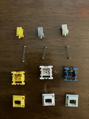

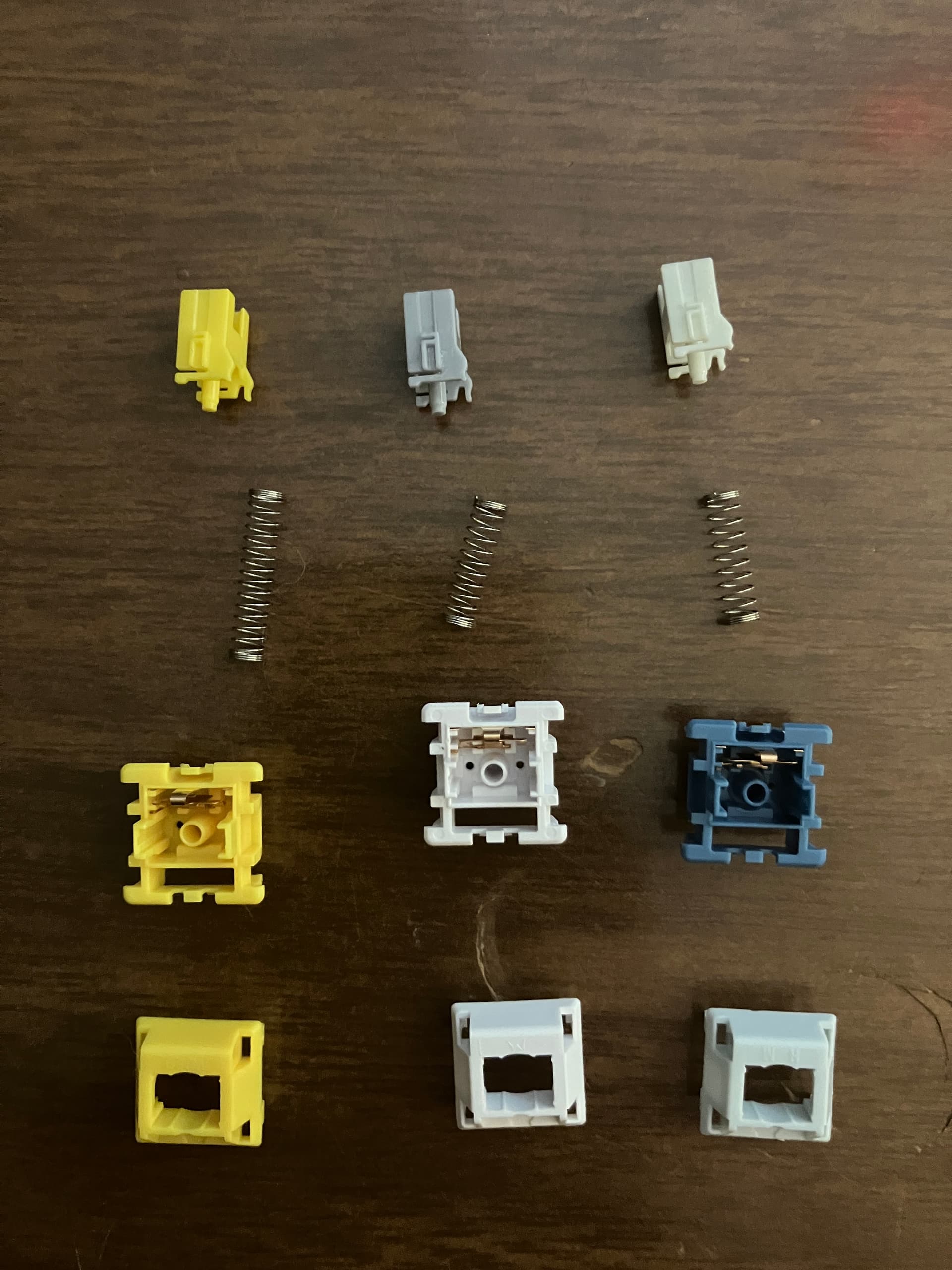

They all use the same mechanism, yes, but they definitely don’t feel the same. I use the Geon Yellows on my daily driver – they have slightly more tactile feedback than the Whispers or WS Silent Tactiles, IMO.
Taking a few I have on hand apart, they seem pretty similar.
Main differences I can tell:
  1. The Geon Yellow’s use a longer (18mm) spring vs. the WS and Whispers (14mm)
  2. The material for the WS housing is different from the Yellow and Whisper – it’s slightly stiffer and has a more matte appearance vs. the shiny of the Yellow and Whisper. I don’t notice much of a difference in the sound but you/others might.
If you’re willing to spring swap, then it would be almost exactly the same. But in stock form, the longer spring for the Yellows does make a difference.
