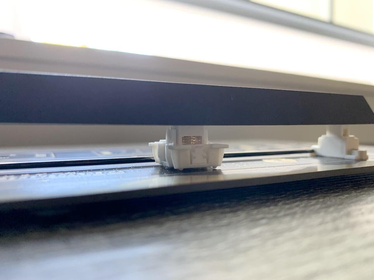

FWIW, I just tried the 0.5mm thick pads in a build for all of the stabilizers, using the 6.3mm center cutouts exclusively. The stabs were clipped. I didn’t notice any reduction in travel. I’ve used vinyl electrical tape before, and compared to that, I think this has a nicer feel - the vinyl tape muted the sound a bit but didn’t really absorb the impact, whereas these pads absorb just enough impact for the sound and the tactility to seem more consistent with each other, if that makes sense. Hard to beat peel-and-stick for ease of installation, too. I liked them, and will probably continue to use these for other builds going forward.
Some follow-up cautionary advice with the 0.5mm silicone pad mod. For many builds, I’ve been able to get away with placing the pad under the stabilizer housing and having the housing rest on the pad as I screw the stab in; the additional vertical displacement of the stabilizer due to the compressed silicone pad sitting underneath it hasn’t been an issue. Until now. With a Tofu HHKB build, the spacebar wire is close enough to the integrated plate that the additional displacement causes the stab wire to hit the plate.
At least three possible solutions:
Remove the silicone pads and go without this mod, which is what I did for the time being.
Trim the pad so that it fits cleanly within the walls of the stabilizer housing. Doable, but possibly a finicky operation.
Find a thinner silicone pad or sheet, with adhesive.

I’ve only used this mod with plate mount stabs. With some PCB mount stabs it allows the stab slider to pull out of the housing.
