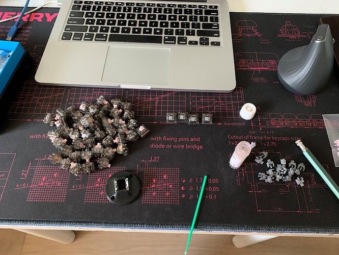

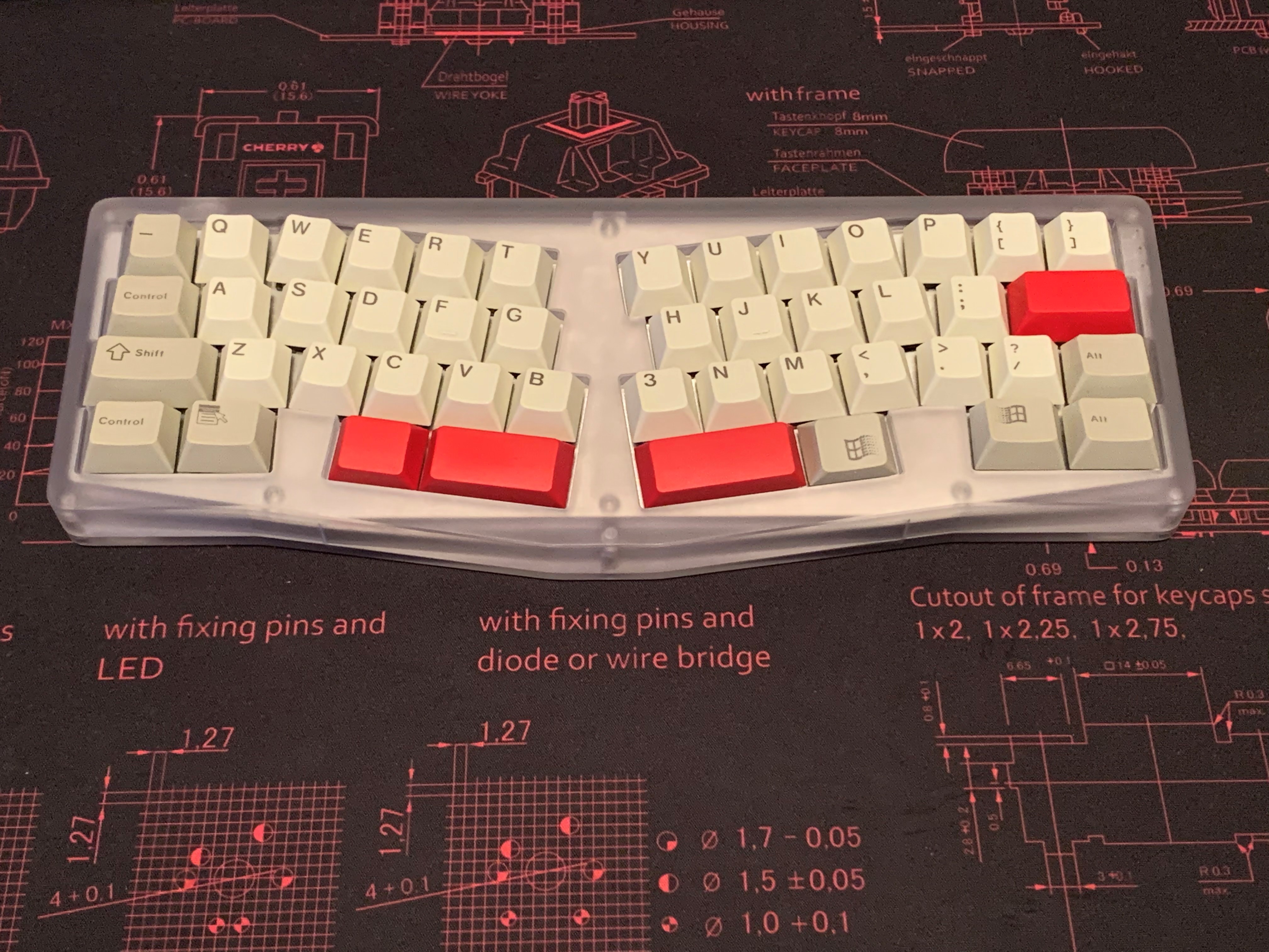

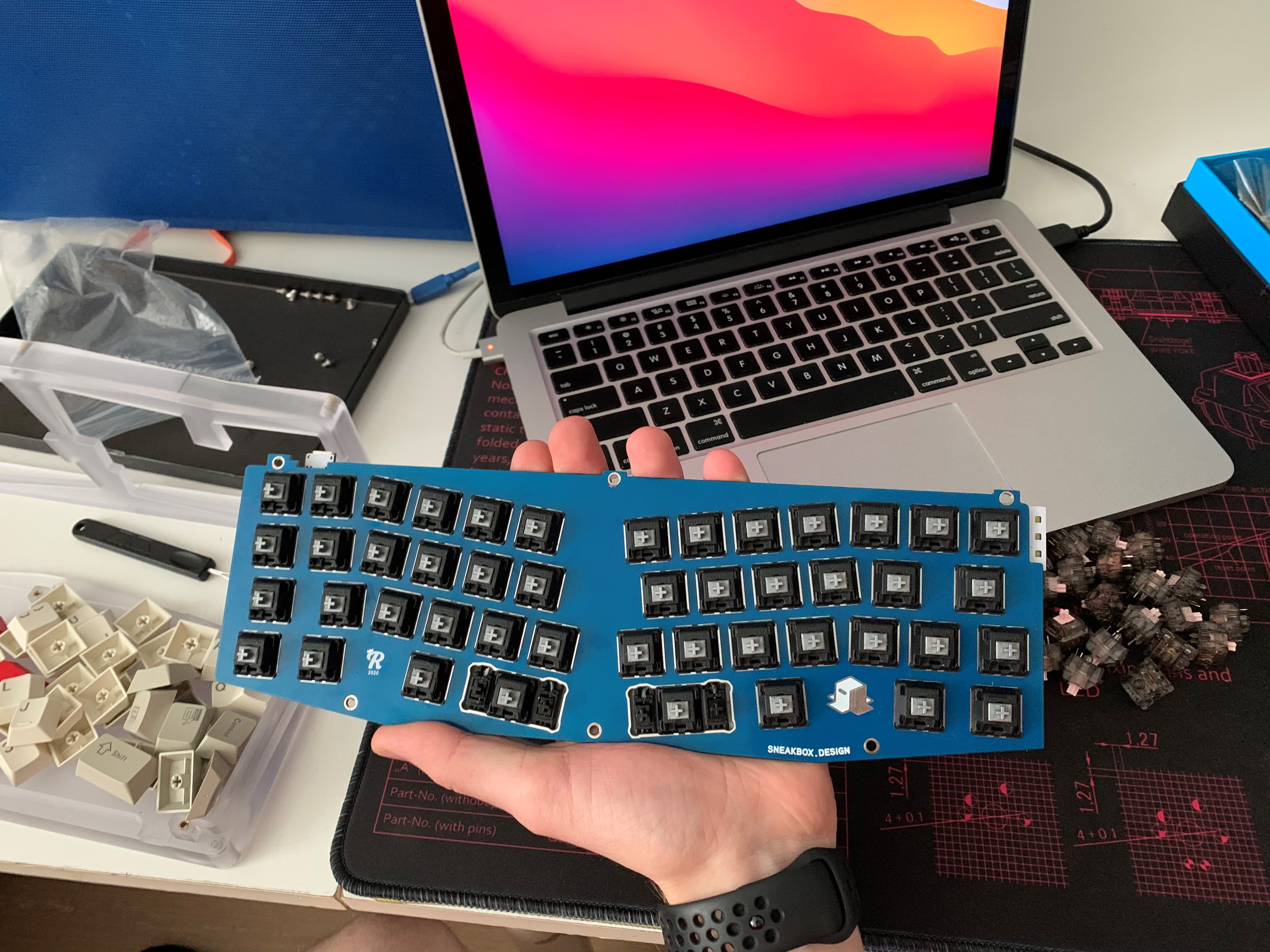

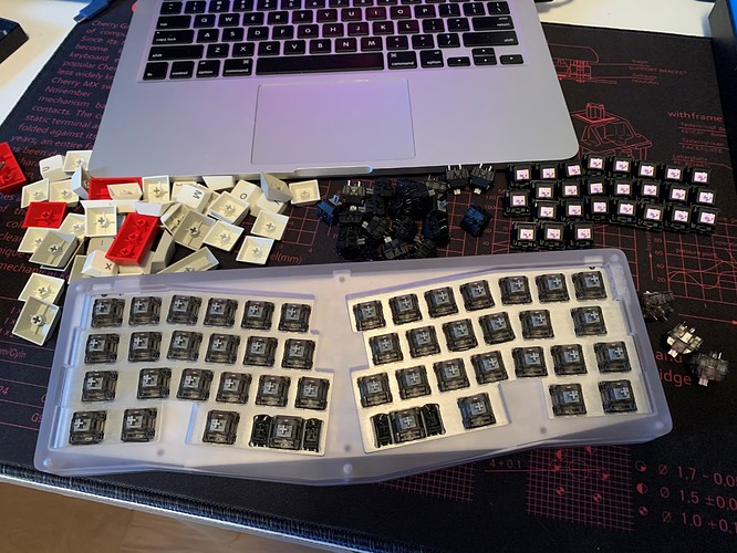

After using the Silent Gazzew stems in some cherry housings for the past couple weeks, I finally got sick of that ol’ cherry scratch and took the time to transfer the stems into my silent alpaca housings, and oh boy was it worth the 3 hours of work.
The board as it was before.
The work ahead.

All done up with the POM cherrys and some crimson cadet space bars

SPECS:A silent Gazzew stem lubed with krytox 205 in a JWK PC housing, with aftermarket 55g springs lubed with krytox 105.
T&P: These switches are top of the silent switch game for me, they combined the improved stem silencing mechanism of the gazzew stem over that of the alpaca’s gasket variety, with that classic JWK slick glide, resulting in a dead silent, and perfectly smooth switch, save for the gentle plocks they issue on bottom out.

Dang that sounds great man. I’m might have to do the same swap.
Edit: thanks btw!
