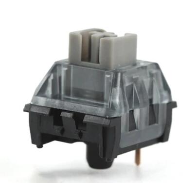

The Kailh silent grey you tried were those?:
qweq
Kailh’s switches have longer stem poles that in regular housings hit the bottom of the switch, in the Creams housing they should fit fine.

My apologies, OUTEMU silent grey, not kaihl. They have kaihl housing hence why I said that.
And yeah, I can somewhat handle medium tactiles like Ceruleans but the bigger bump ones (comparable to holy panda, T1’s) are too tiresome for me.
These are the greys I have:
Ah, okay. I have heard of the OUTEMU Silent Gray, but never got around to getting them.*
