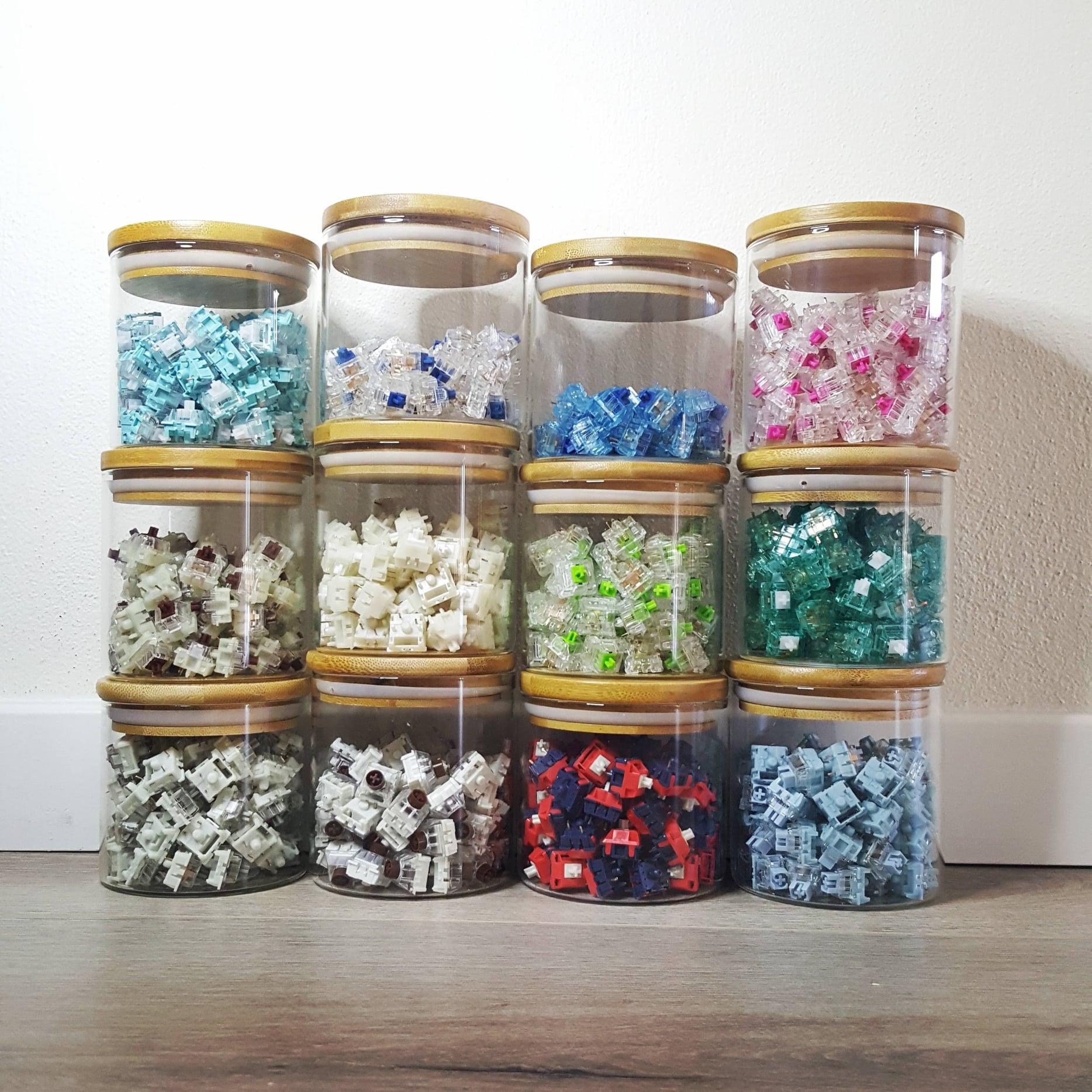

Silent MX-style tactiles
Top row from left: Outemu Silent Forest, Zilents, Aqua Zilents, Aliaz
Middle row: Gateron Silent Brown, Gazzew Boba U4, Tacit., T1 Shrimp
Bottom row: Outemu Silent Gray, Kailh Silent Box Brown, Bushi, TTC Bluish White

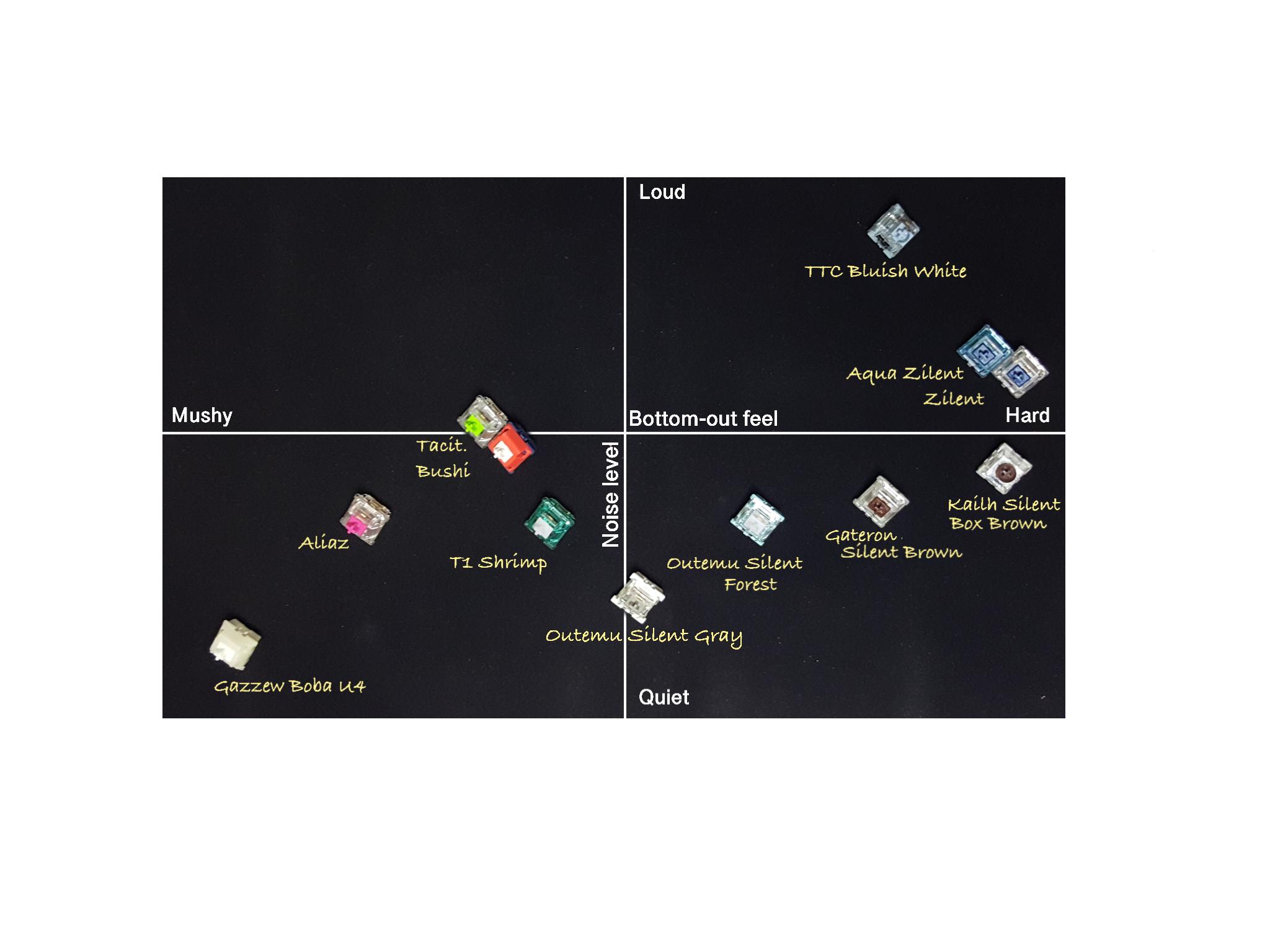

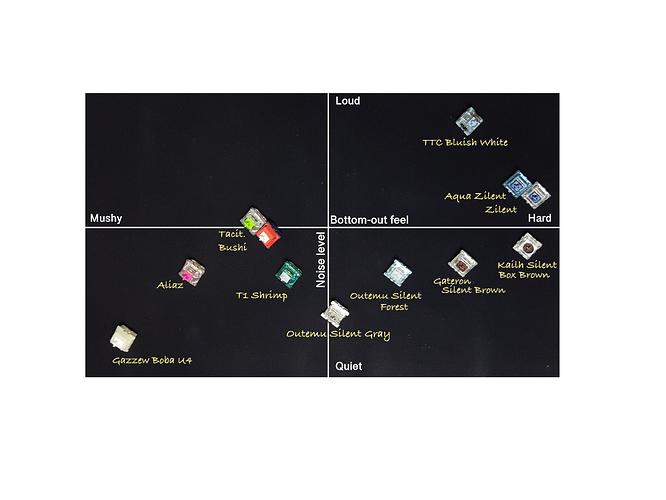

Added a mushiness versus noise level graph.
Your mileage may vary, of course!

That’s awesome! At least for me, relative comparisons like this are really helpful. I’d never heard of the T1 Shrimp - but thanks to your chart there, I have a good idea of what it might be like compared to other switches I have tried.
On that note - what do you think of them? :shrimp:
They are good, but still has the spring and leaf crunch common to Durock T1s. Though I
think I prefer Tacit, which also uses a T1 stem. In terms of price, Shrimp over Tacit as the overall difference is marginal.
@keyves wow this is really cool! Just as @HungerMechanic and I were just talking about silent tactiles over on this thread Topre/Nopre for a Boba U4 user - #27 by HungerMechanic
Quite curious to see that you ranked Boba U4 as quieter than Aliaz! I have a board with modded Aliaz (Aliaz stem in Cherry black housings, 205g0, 60g) and they are significantly more silent than my Boba U4s. Boba U4s have a thud when bottoming out, while modded Aliaz had none. I should do a sound comparison one day - it’s quiet to the point of being almost unsatisfactory
That said, Boba U4 is the superior switch to me, with much better tactility (Aliaz is pretty weird, where actuation happens after the tactile event instead of during)
Can the TTC Bluish White really be the loudest of the lot? :thinking:
the top out doesn’t have any silencing so it’s just a regular sounding top out with a silent bottom out. would’ve been cool to see it be the other way around
Only because it’s only half-silent (bottom out), so the return clack is really noticeable compared to others.
Yes!

That’s really interesting about your findings re Aliaz vs Boba! You might be right too, of course. But I feel that the bec Aliaz is less tactile, I might have been bottoming out more. (I bottom out with the force of a thousand storms).
I prefer the harder rubbers (right of graph), and am not a fan of the mushy ones. Please don’t hate me. Hahaha
