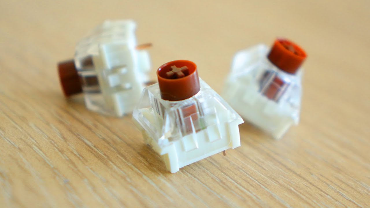

  • Kailh Silent Box Brown - so, depending on which batch these are from, these are either really mild or pretty punchy tactiles, and I’m not really sure where the inconsistency comes from - but I mention these because they have better dust resistance than other switches that just have boxed stems. Kailh’s Box switches in particular have a semi-sealed compartment for their contacts and have an IP56 dust resistance rating. These have a similar volume to the last two, but with some added noise thanks to the extra parts. This is the pick if dust resistance is the most important thing.

  • Box franken: Kailh Silent Box Brown top on a Box Royal bottom; what you get is a Silent Box Brown with a punchier tactile event. The only downside is the tendency of Kailh Box switches to increasingly make light clicking noises as the lube wears off of the contact pusher. It is a sharp sound, but it isn’t loud. If consistency is more important than quietude, you can use a thin / light lubricant on that part to encourage the clicking. I’ve had less consistent results trying to discourage it - if I find a good way to do that I’ll share. If that modest noise level is acceptable, this might be the overall closest option to the use-case.

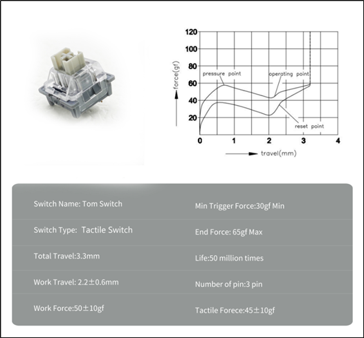

I think the Silent Tom is more of a medium tactile, closer to Silent Forest than U4.
@Deadeye The IP56 dust rating and seeing the switch interior in below video got me convinced that this is indeed the best boxed silent tactile switch for this particular application. Even more so, as the switches will be soldered to the board. To make them heavy, I will swap the springs out with 71.5g Box Kailh springs.
I don’t think so. As explained in below video, the Outemu TOM top housing is of an older, inferior mold that produced some issues.
Thanks for the video, didn’t saw it with others I saw in the past months, but from it seems like Creamy Yellow could be definitely more silent.
Anyway, since I’ve already bought a 90 pack of TOM will try then anyway and see the outcome :crossed_fingers:
Is strange that from a test pack of Outemus I took on Ali, trying a Cream Yellow stock on my IK75 didn’t gave that silent feel that Ocean and TOM gave me (already stock too, with the former not factory or hand lubed while the latter is factory lubed).
I suspect the top-out ticking on the Toms comes from a little play in the top housing; lubing and filming the Toms should give you a plenty quiet final product.
