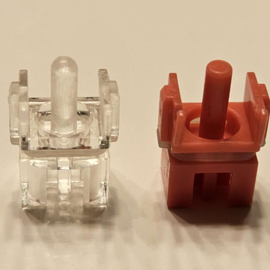

For a milder and quieter BOX Silent Brown, there’s also the Cookies & Cream mod:
Maybe the ideal BOX silent tactile for me would be Cookies & Cream, using aftermarket Kailh springs close to MX Brown [45/60 G].

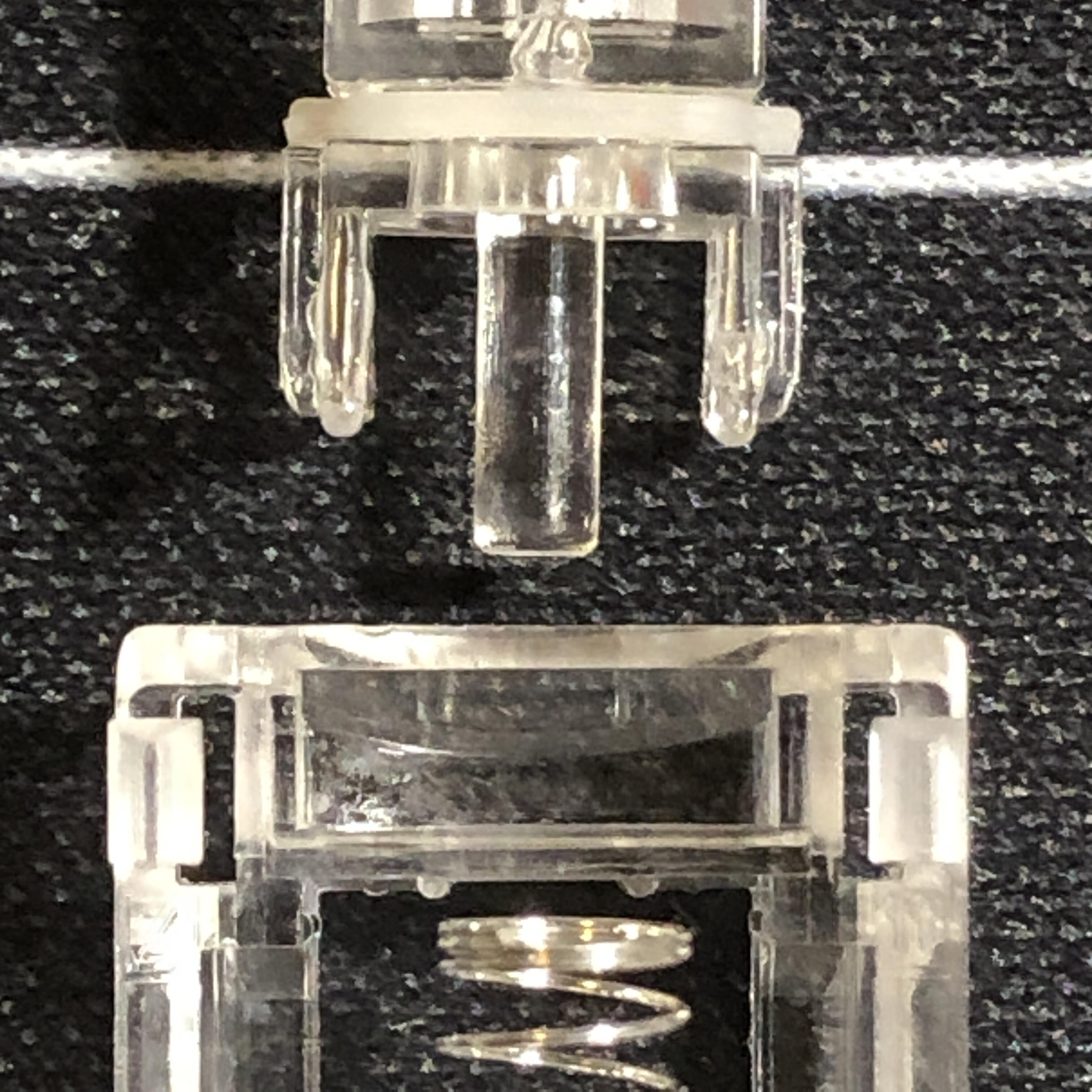

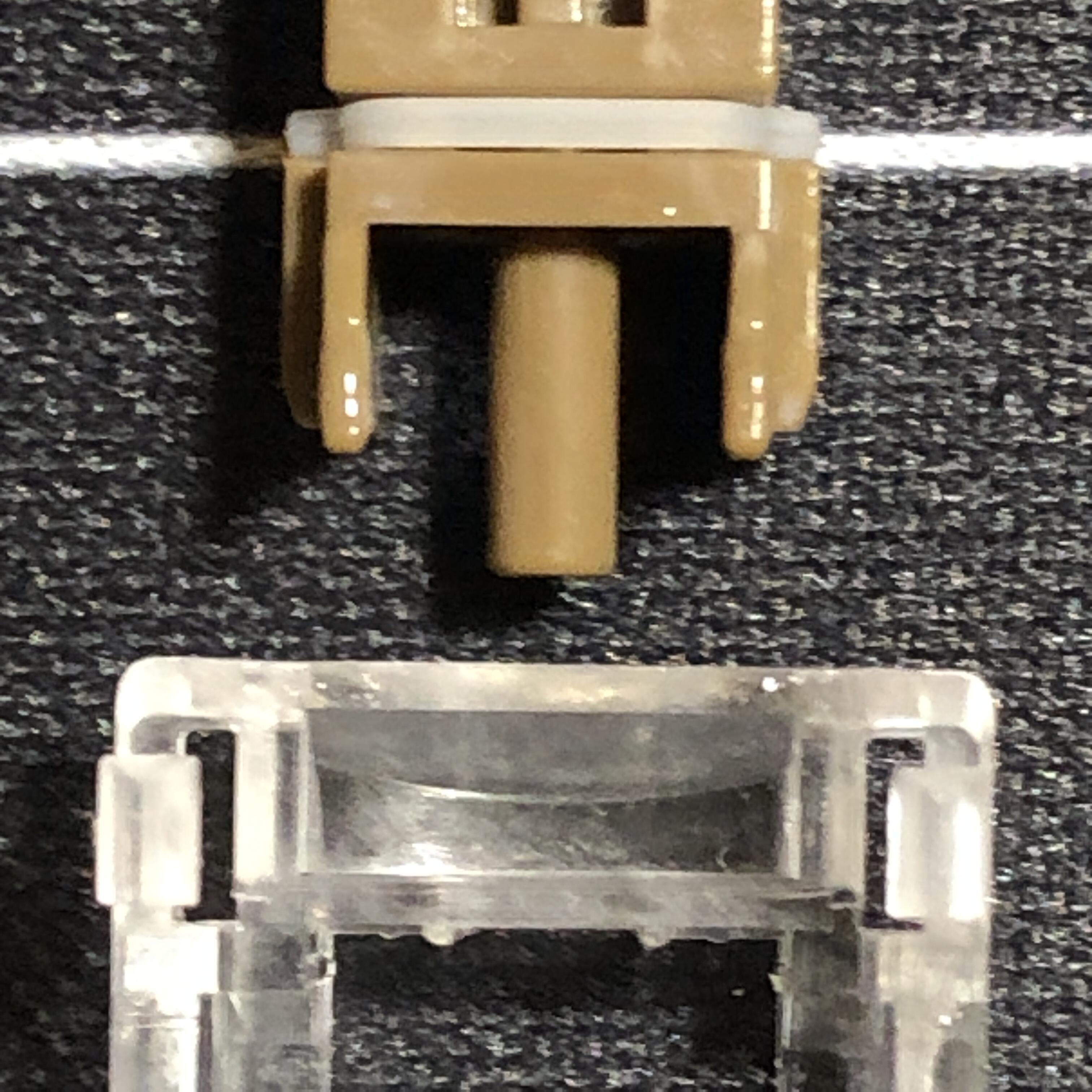

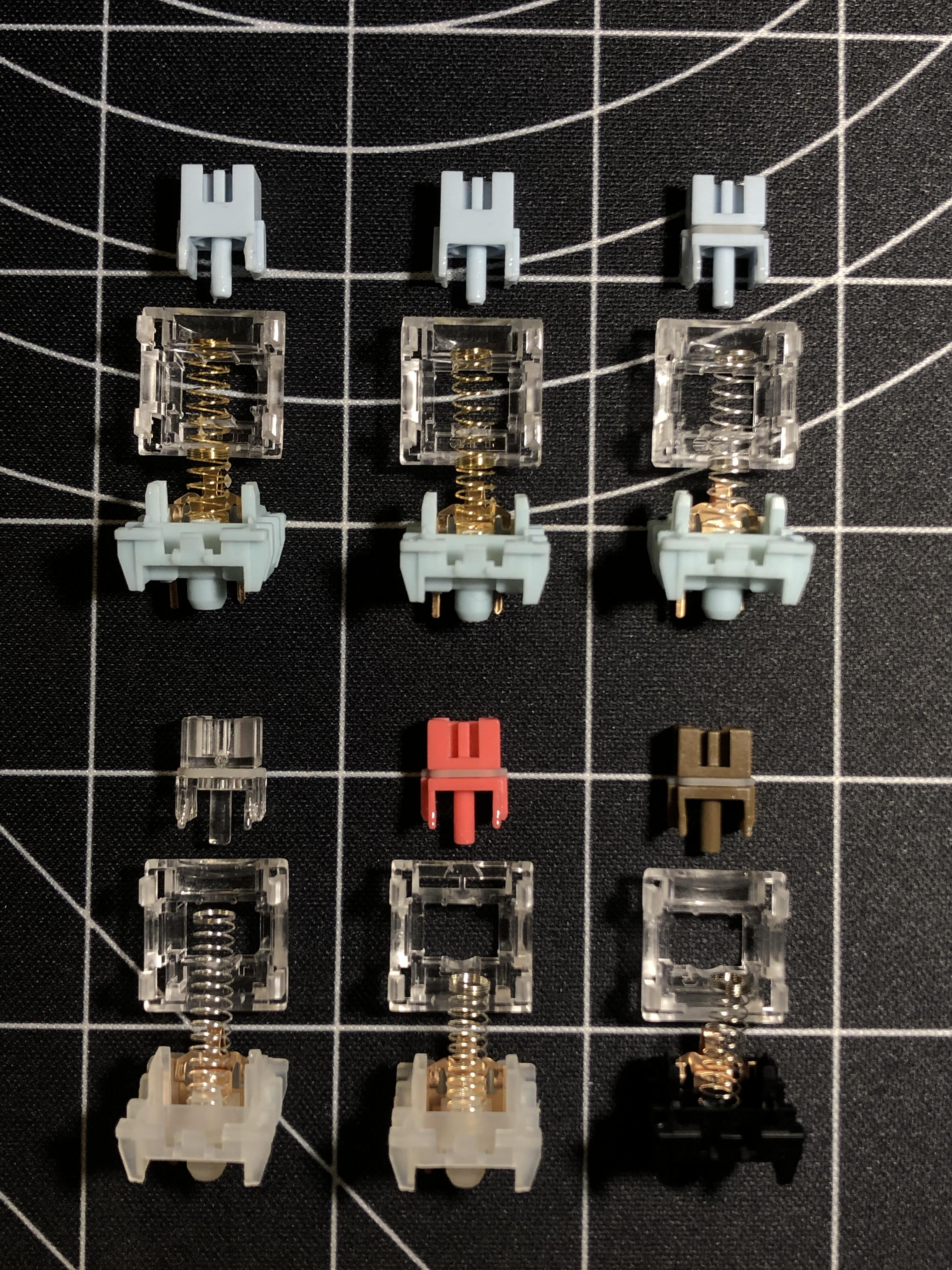

The whole round vs flat bottom business had me fascinated so I decided to look at all the TTC silents I had on-hand. Most if not all of these are going to be less-recent side, relatively speaking:
Top-left to bottom-right:
  • Bluish White (non-dampened top, gold spring)
  • Silent Bluish White (full-silent, silver spring)
  • Silent Brown V2
  • Frozen Silent V1
  • Silent Red V3

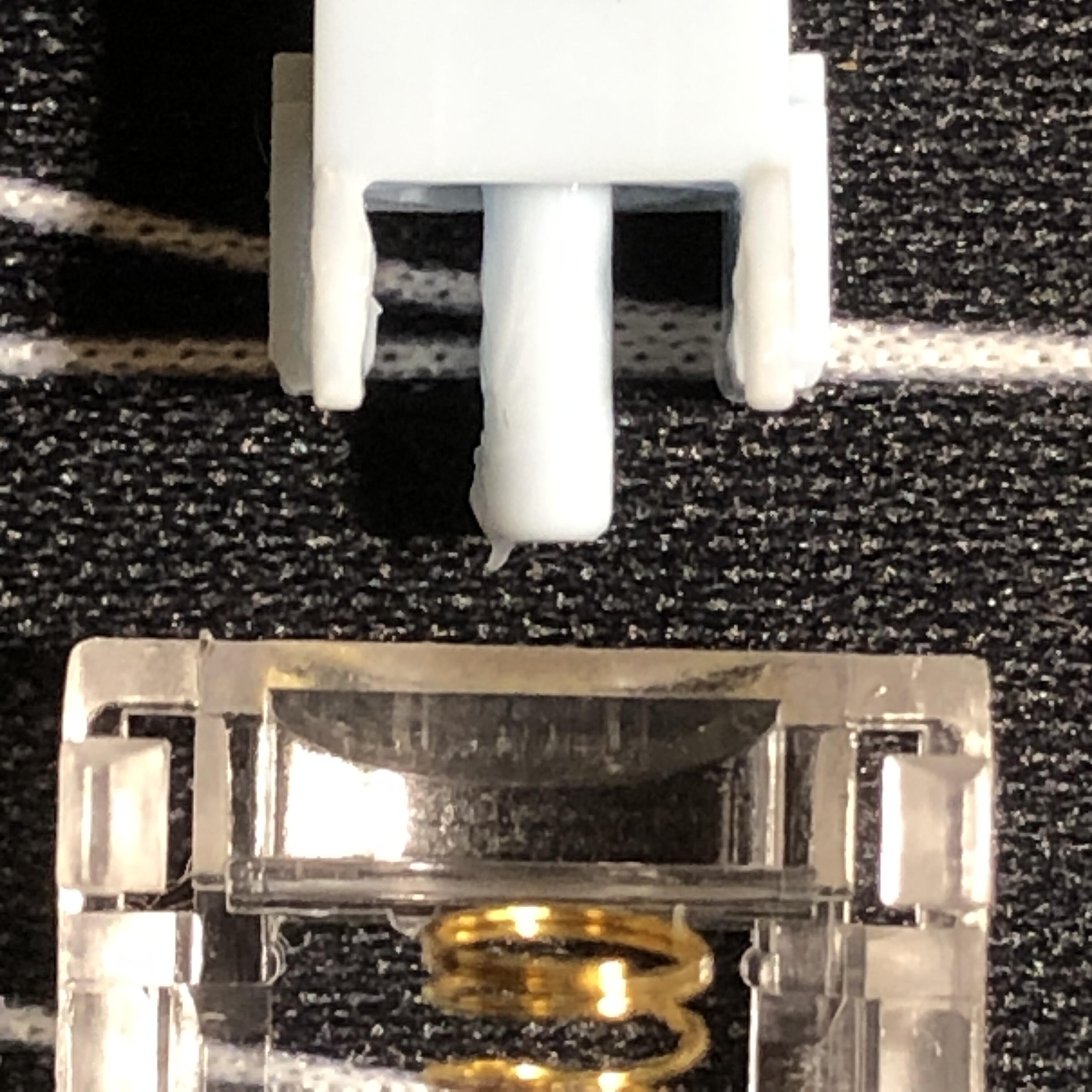

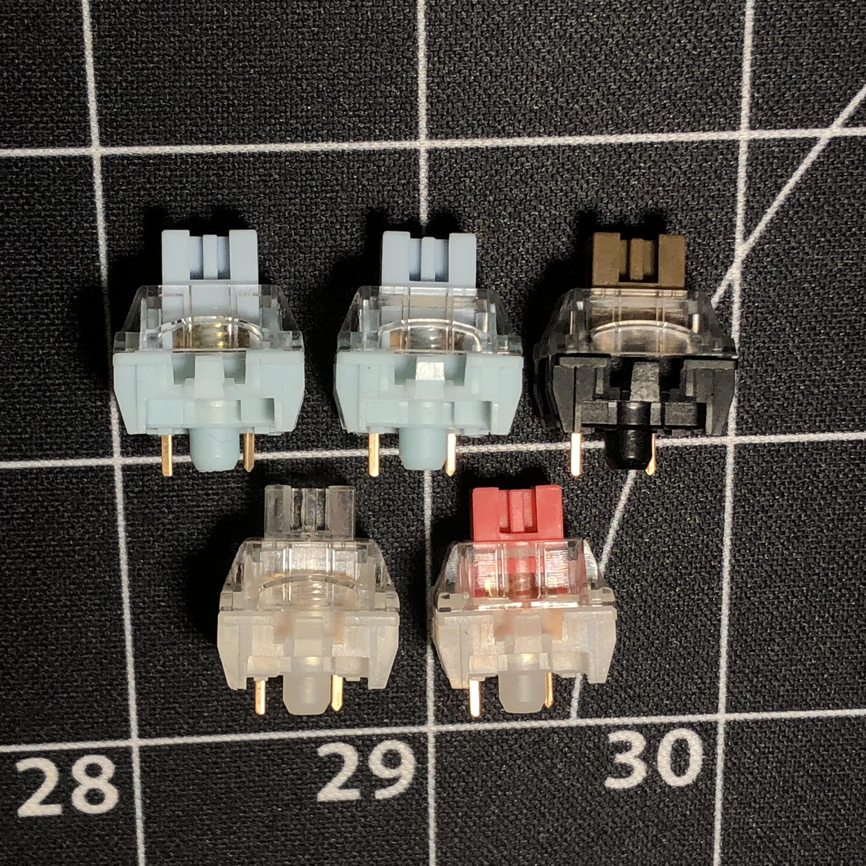

I ended up adding another regular Bluish White from my extras bin to the comparison when I realized the one in my Oddities jar might be a V1.5;
  • Bluish White (from the extras bin)
  • Bluish White (from the jar)
  • Frozen Silent V1
  • Silent Red V3
  • Silent Brown V2
It looks like none of the examples in my collection have a fully-round bottom; the closest to it is a slightly tapered one that might be a 1.5 - still flat at the bottom though, just a smaller surface area.

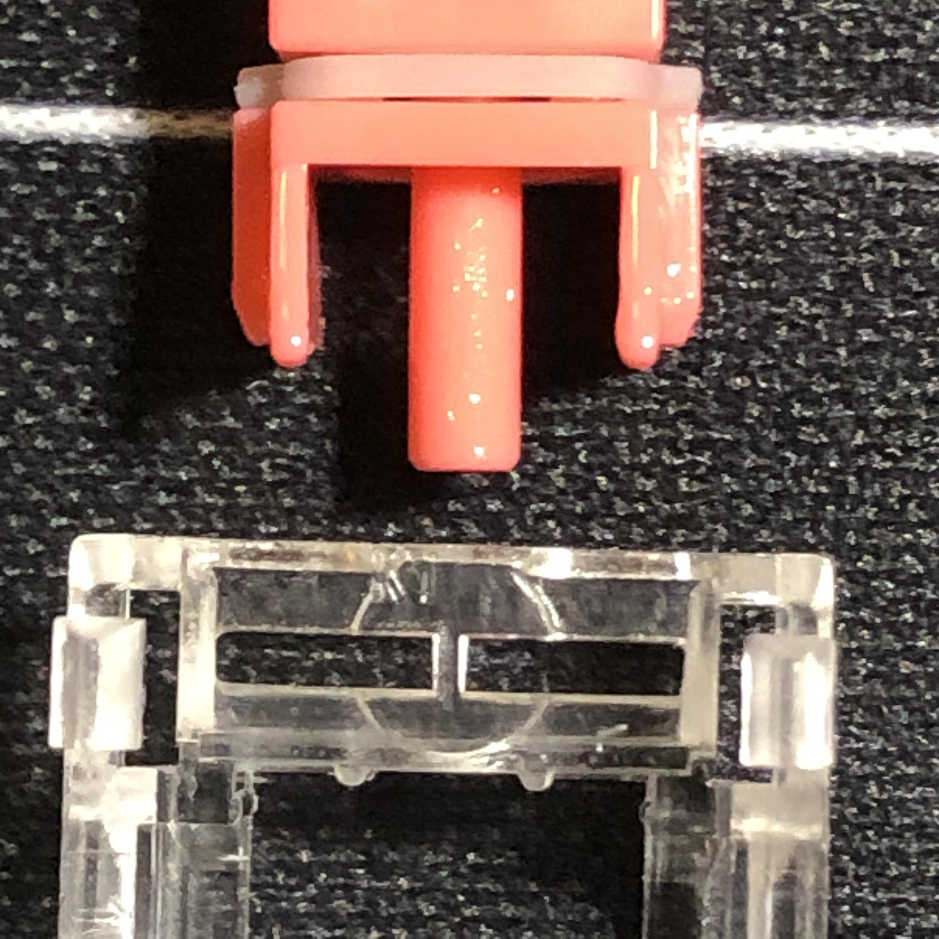

Closeups and recordings:
I recorded these with a phone and in this tester in the middle slot, with a Ducky (OEM profile) numpad 7 key. The phone was close, about as far as that box of springs.
Frozen Silent V1:
Silent Red V3:
Silent Brown V2:
Silent Bluish White (V1, I suppose):
Bluish White “A” (V1?):

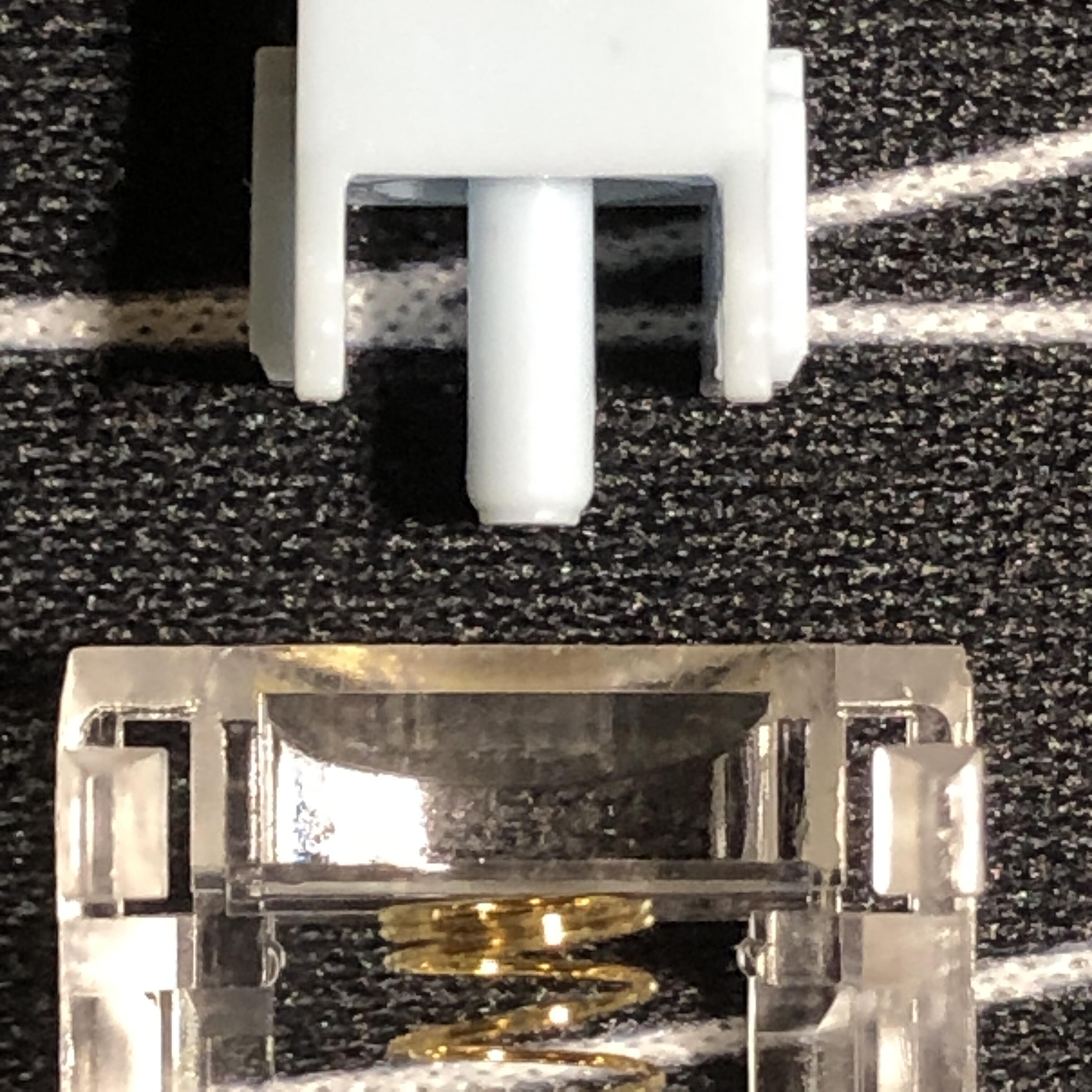

Note the slightly more rounded-in but still flat bottom; the bottom surface would be a little smaller than all the others so far. As far as I can tell this one matches all the others in my parts bin, though this one is especially greasy. There’s another comparison photo below with the grease wiped-off the bottom.
Bluish White “B” (V1.5?):
This one is more obviously different; still flat on the bottom, but with a short second tier after the rounded-in area that otherwise matches the previous “A” switch. This one would have a slightly smaller-still bottom surface area than the last, but also keeps that diameter a little longer in compression vs the round bevel which effectively increases surface-area as compression happens.

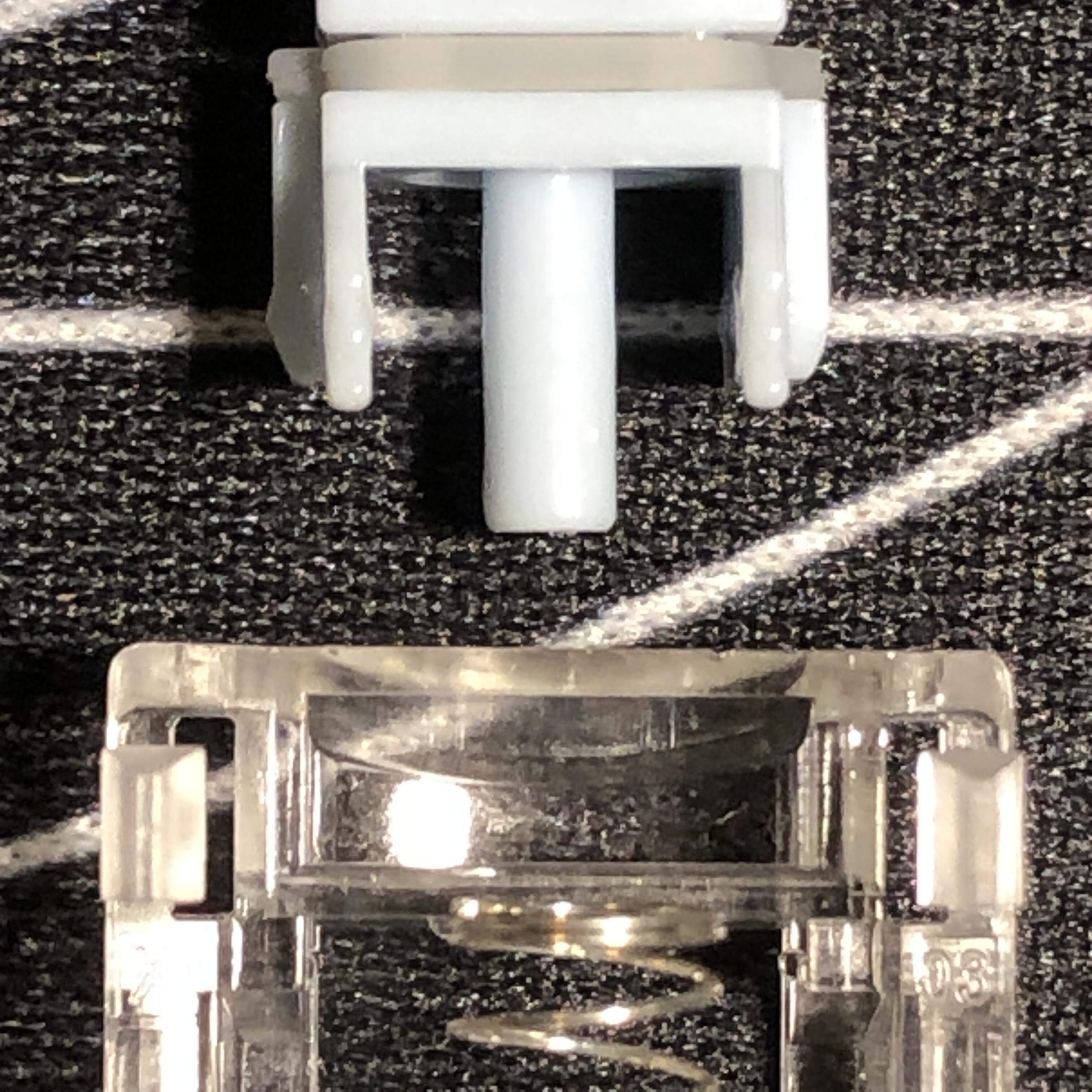

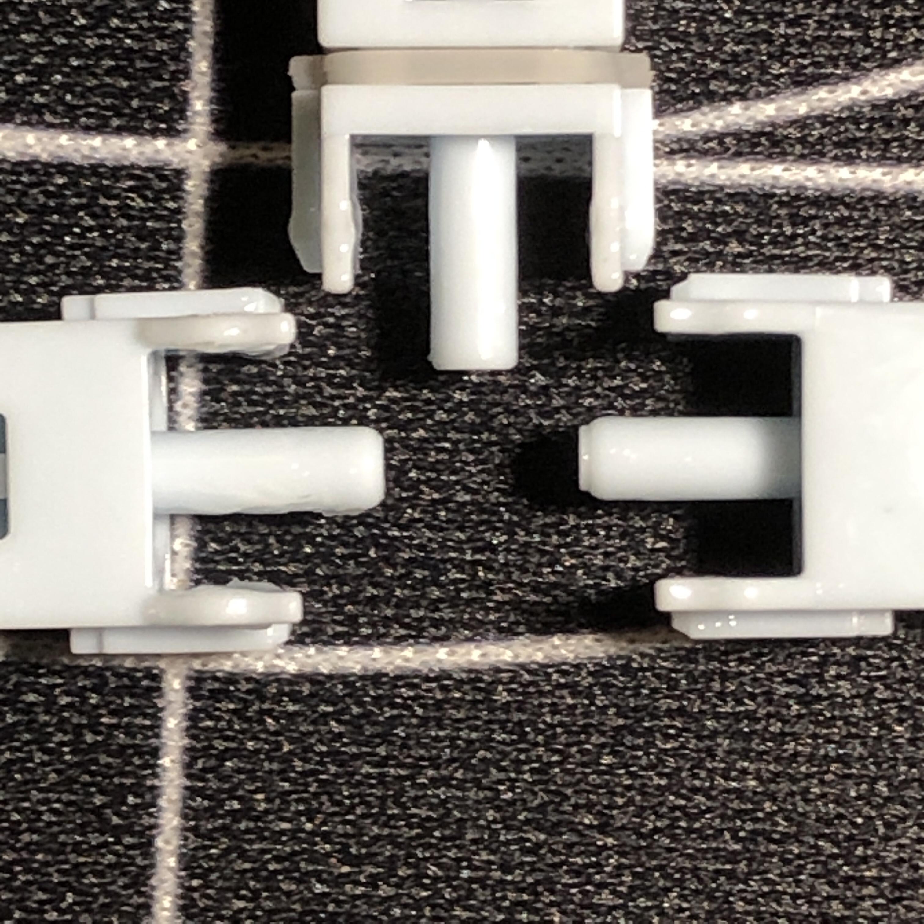

Direct comparison between the three stem shapes I have on-hand:
On the left is what I assume to be older V1 Bluish Whites, the middle is V1 Silent Bluish Whites, and the right are what I think might be V1.5 Bluish Whites.
Again none of these have the round bottom, which at this point I think probably features on the more recently-made switches. I’m of course super curious about this now and am going to seek out some more samples for further testing and comparison. :3
