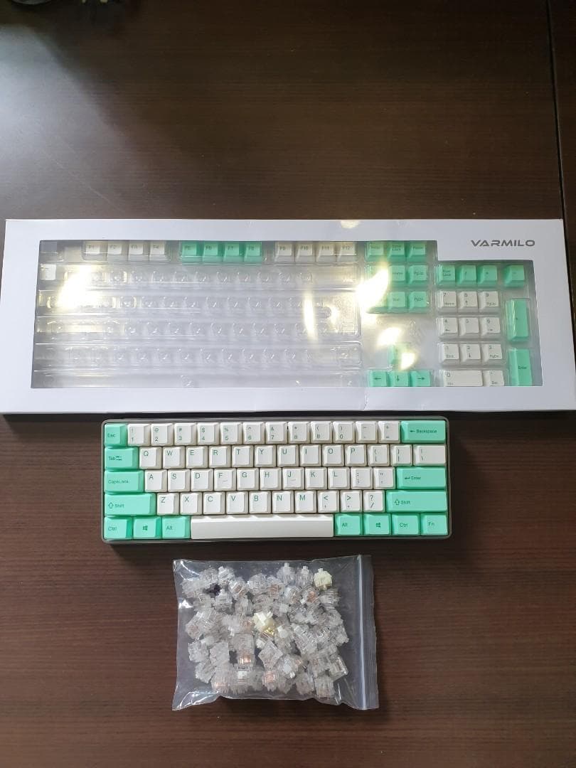

BTW Your Varmilo keycaps are very close to what I use. I have some gray + cyan green keycaps that I put on a TKL built for a relative. They were smooth with lubed Gateron CAP Brown V2.

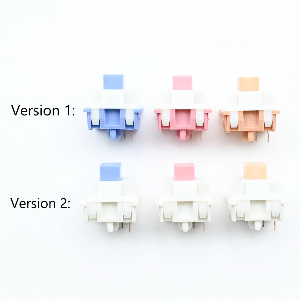

It seems that there are at least three different versions of the Outemu Cream switches. Here is an image that used to be part of the “INEDA Digital Store” posting on AliExpress:
Note: they very recently edited their posting to remove mention and images of the version 1, but it used to have this image (and it is still cached in a Google image search that points to this page) with text that said something along the lines that there were simply two color versions of this switch and that they would randomly send whichever they had in stock. I know this, since I was looking at this exact store posting (and had it bookmarked) within the past couple of weeks. Now, this item post has been edited to only show this version 2 colorway.
It seems that the v1 is indeed the original colorway for this line of switches, as older reviews, posts, videos on the web seem to all show these two-color housings. I’m guessing that INEDA eventually had simultaneous stock of both colorways, and may have just been mixing the versions for logistical ease. I have no idea if there is any significant difference in terms of performance, but at least one seller (INEDA) seems to act as if they were the same and just a change in color scheme.
However, there appears to be at least that one AliExpress posting, from “Rick & Anna Tech Store” (as @m4dbra1n posted above), that offers what appears to be the version 2 colorway, while calling these “pro”.
A third colorway, with slightly translucent housings seems to now be available. This must have been quite recent, as with the two AliExpress sellers offering these, they’ve only sold relatively few and the earliest reviews are only from April 2023.
I recently ordered these from this Slitn Store posting, but they are also available from “INEDA Digital Store” (link shared by @m4dbra1n above), which calls them as “Jade”.
So, to summarize, there seem to be three versions:
  1. Two-color, opaque housing
  2. White, opaque housing (called “pro” by one seller)
  3. White, translucent housing (called “jade” by one seller)
However, I’m not sure if there is much of (even an intended) difference beyond cosmetics, as all of the product postings mention identical specs and materials (POM Stem, Nylon Upper Housing, Nylon Housing base).

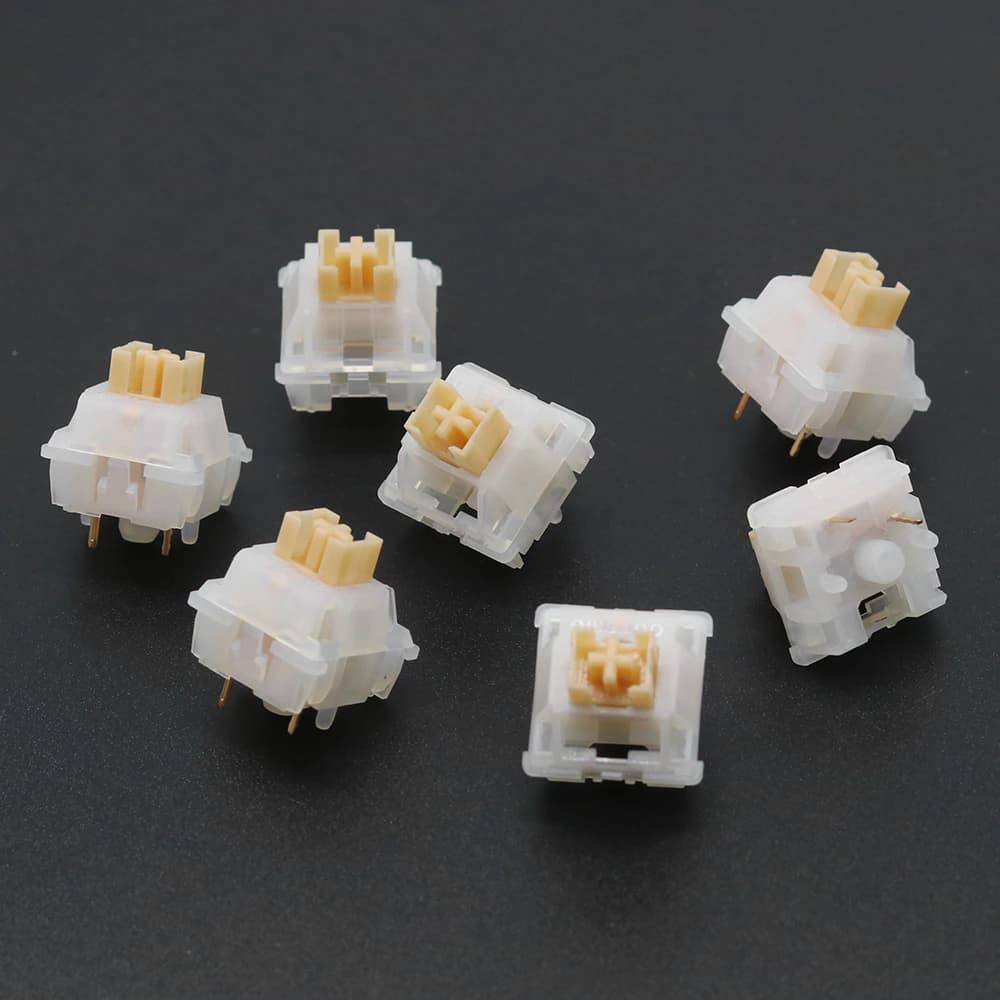

I’ve recently been lurking forums for mechanical keyboards and I’m in the process of trying to find my silent tactile switch. I have a barebone Keychron Q2 and I’m waiting on a list of samples. Out of those are a list of Outemu Silent Cream Yellow and Silent Yellow Jade, which they describe as ‘The switch housing changed to a semi transparent color, which allows for more light transmission and a more beautiful color than the previous generation OUTEMU Cream Switch.’
Silent Cream Yellow
Silent Yellow Jade
Once I receive them, I am more than happy to report back or provide more details on the difference (if there is any apart from transparency) unless other people get these first.
It will be interesting to see if the latest Silent Cream Yellow has dispensed with the pinging sound that a percentage of them have.
Even though they all have some factory lube, there was something with the internals that was causing ping in a portion of them, as detailed by members here.
Unfortunately, one thing that I won’t be able to properly compare is consistency of performance across a batch, since I only have a single sample switch of the v2 Silent Cream Yellow (and that individual specimen was quite good). However, I have 110 of the v3 “Jade” Silent Cream Yellow switches coming soon, and I will certainly share my observations about batch variation with those.
With another Outemu product, the Silent Greys, of which I also ordered 110, I have noticed some duds in the batch. When installing and testing them, I had maybe 3 or 4 that were noticeably worse (such as scratchier action or less effective dampening), so I simply swapped those out and even threw away one particularly bad switch (that seemed to be mostly missing upstroke silencing). I will keep more careful notes about exactly how many anomalies I encounter when evaluating the v3 Cream Yellows.
I am in the process of replacing the springs of 115 Outemu Silent Cream Yellow switches with heavier 68 g stainless steel Gazzew springs. The goal is to end up with a silent tactile switch that closely mimics the behaviour of a Gazzew Boba U4, but then boxed. Remember, Gazzew switches are made in the very same Outemu factory.
The new and heavier spring completely removes any ping from the Outemu Silent Cream Yellows.

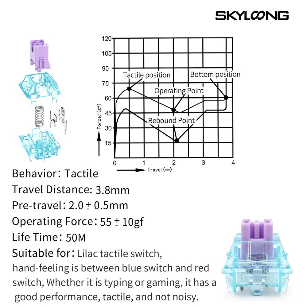

Has anyone tried the Skyloong Glacier Silent line? Appears to have the same dampening mechanism as Haimu/WS Silents. I’m especially interested in the new Skyloong Glacier Silent Clove/Lilac, saw them on AliExpress but haven’t seen many reviews. Seems that they are an upgraded version of the Skyloong Silent Glacier Rose.
I have the Glacier rose, I like them but they have tendency for leaf ping. The lilac looks interesting but hard to tell if it is improved
