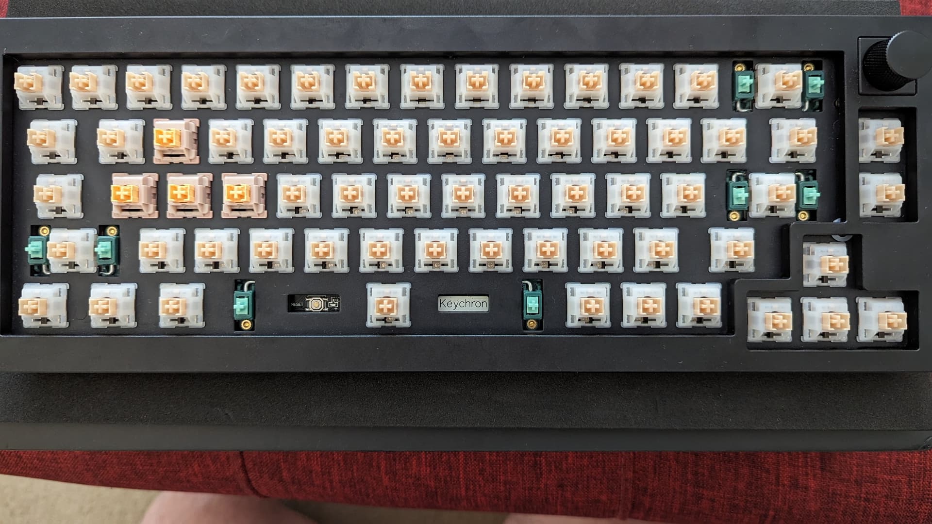

Received the Outemu Silent Yellow Cream v3 (aka Jade, with translucent housings) today and just installed them tonight.
Wow, these are great. Much better than the Silent Greys. Excellent level of silencing, and much better keyfeel. Nice, large round bump that starts immediately in travel. I bought 110, just in case there might some duds and so I could cherry pick the best in the batch, but the first 87 that I’ve installed are all great sounding/feeling, and very consistent, so I haven’t had to swap any out. The one sample of v2 (all white, opaque housing) seems to be pretty much the same as these, except for the translucence/opaqueness.
Edit: I did find one switch in the bag that had a small patch of some sort dark dirt or grease on the housing. I didn’t bother testing that one and just threw it away, since I have so many spares.

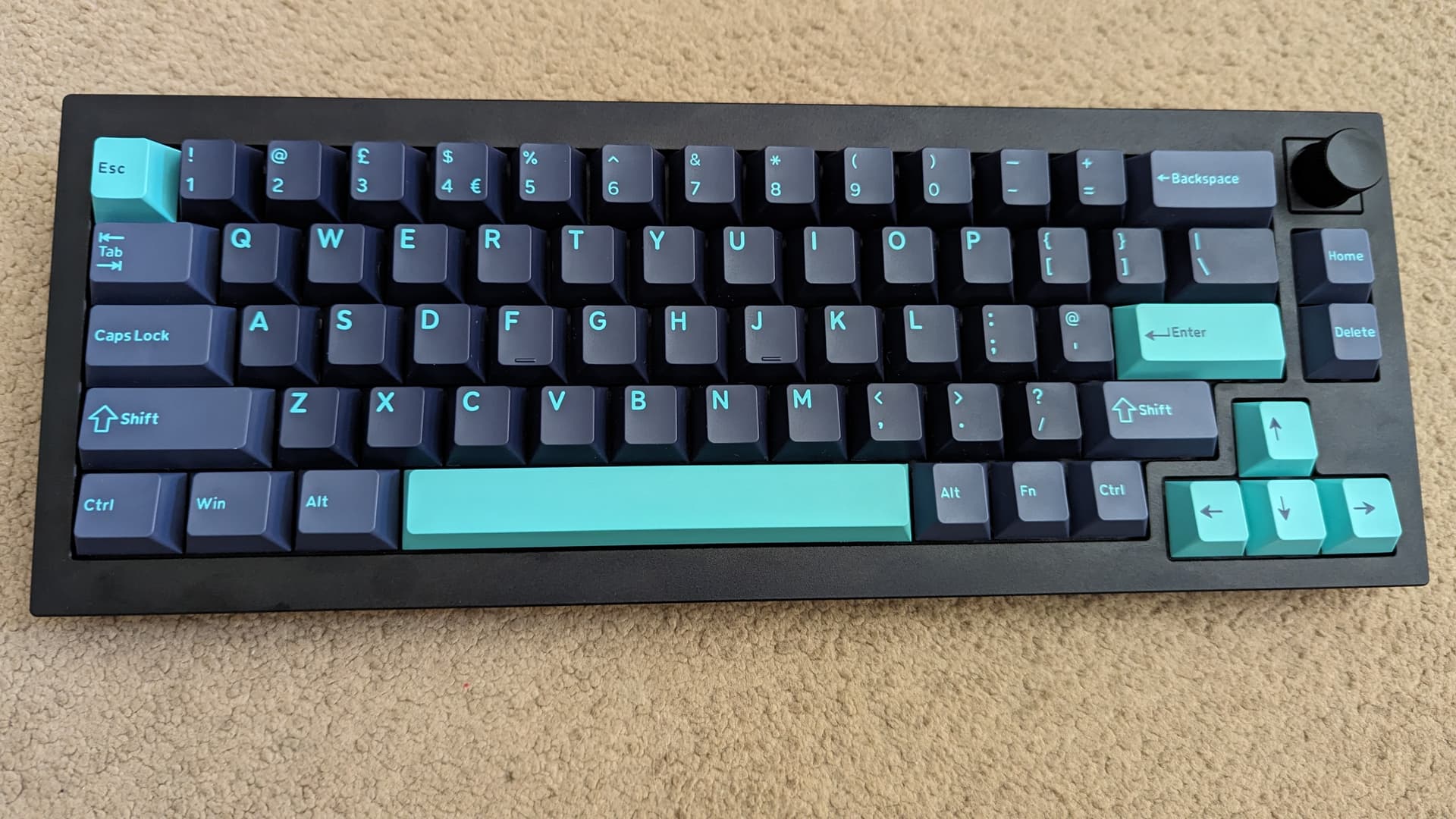

Thanks for the advice. Ordered the silent yellow jade and love them. Better than boba U4 but not as good as the Durock T1 (but they aren’t silent so not a fair comparison)
Quick update, I’ve had this keyboard for over a week and I’m very happy with my choice of switches.
This thread has helped me a lot and wanted to say thank you.
