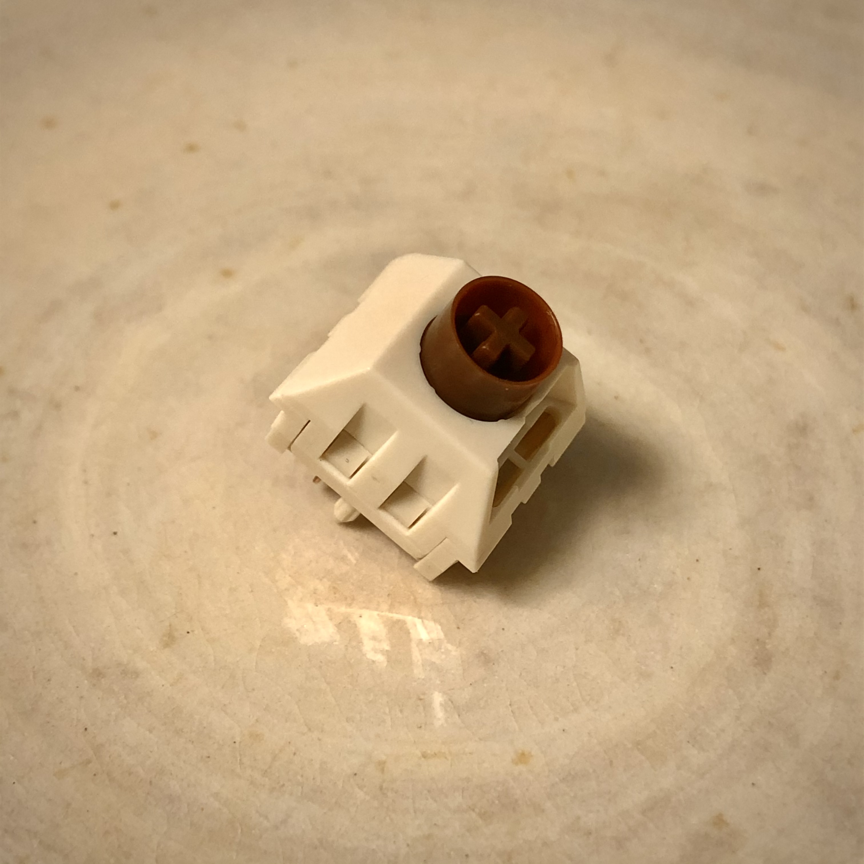

Cookies n’ Cream
  • NK Box Cream housing & spring :icecream:
  • Kailh Silent Box Brown stem :chocolate_bar:
  • More quiet, deeper sound - virtually no ping :sound:
  • More moderate tactility, like reg. Box Brown :brown_heart:
Like a mild Silent Box Brown, but better.
Flavor-text:
Like I mentioned to @skepp in another thread, I’d tried this before even mounting the Box Creams in a tester board. (How could I resist?)
What we have here is a subtle but significant improvement over the standard Silent Box Brown, with a couple possible exceptions, one of which can be compensated for. If you want RGB, chances are this isn’t the switch for you - but a modest amount of light will make it through. If you prefer the stronger tactility of the Silent Box Brown, you can swap-in the leaf.
As detailed here with the simple stem-swap, this switch has tactility similar to a standard Box Brown with the dampening of the Silent version, and the sound and feel benefits of the POM housing. Thanks to the spring, it doesn’t ping like many of its boxy cousins do. Now there’s some change I can get behind.
From what I can tell, another benefit of all the newer round stems (silent or otherwise) is that they don’t appear to suffer as much from the inconsistent resting position issue that most of the square ones tend to. Like other Box switches with the newer tapered housing, these have North-facing Cherry compatibility.
Sooner or later, I’ll definitely be replacing the standard Silent Box Browns I’m using at work with these - but I’ll have to buy more Box Creams first because I like using the regular ones at home too much!
