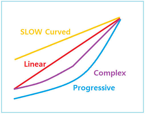

How are the 68 Complex springs as opposed to the regular kind? I have experience with 68 Stainless springs.
They’re nice! They feel like a slower-curved longer spring. Definitely not linear, but not fully progressive either. After being on 70g Creams and 78g Progressives for a few weeks they feel really light haha.
Here’s the image I keep on hand to remind me:

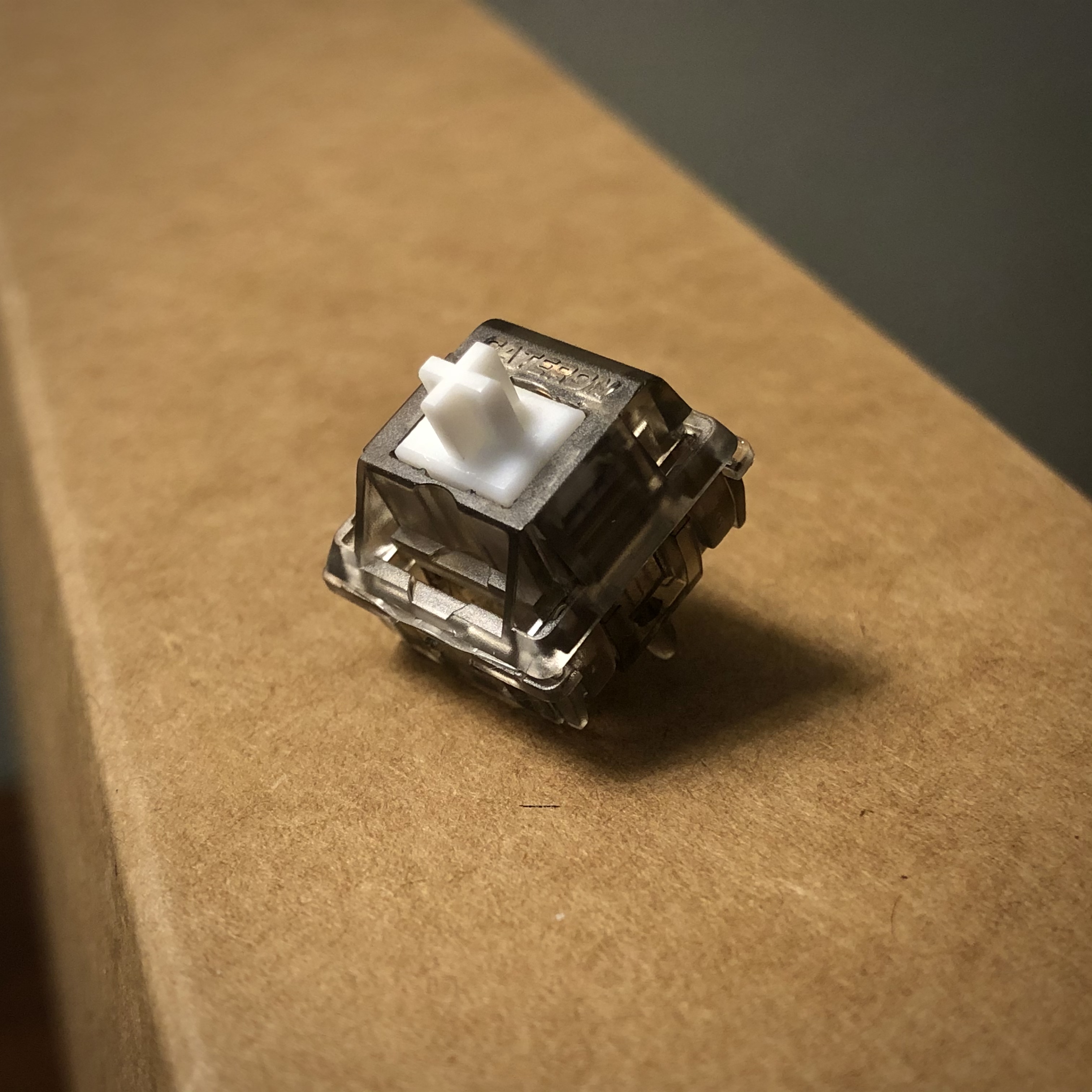

These probably aren’t the funkiest frankenswitches out there but I was have been looking for the ideal home for a JWK Moyu stem (since I really like the feel) and happened to have some V1 JWK RARAs sitting in a drawer. I like the RARA ok when I first got them but never ended up putting them in a board.
Anyways, I put the Moyu stem in the RARA housing and I think it feels GREAT! It’s hard to tell with JWKs but I’d guess that the leaf and bottom housing shape is pretty much identical but it seems the RARA’s material is different. The sound is much better than the stock Moyu.
I am planning on putting them in a board that should arrive in the next few weeks so I’ll let you know how it actually turns out (maybe I’ll torture you all with a typing sounds video as well).
Thanks for listening!

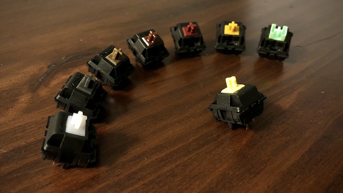

A quick update; I put together a whole bunch of tactiles using KS-3 Gateron housings, all yellows:
I’ll be testing all of these tonight and will report back with my findings. The stems, from left to right:
  • Halo
  • T1 / Koala / Kiwi
  • TTC Brown
  • Gateron Brown
  • Kailh Speed Copper
  • U4T
  • Ink Kangaroo
