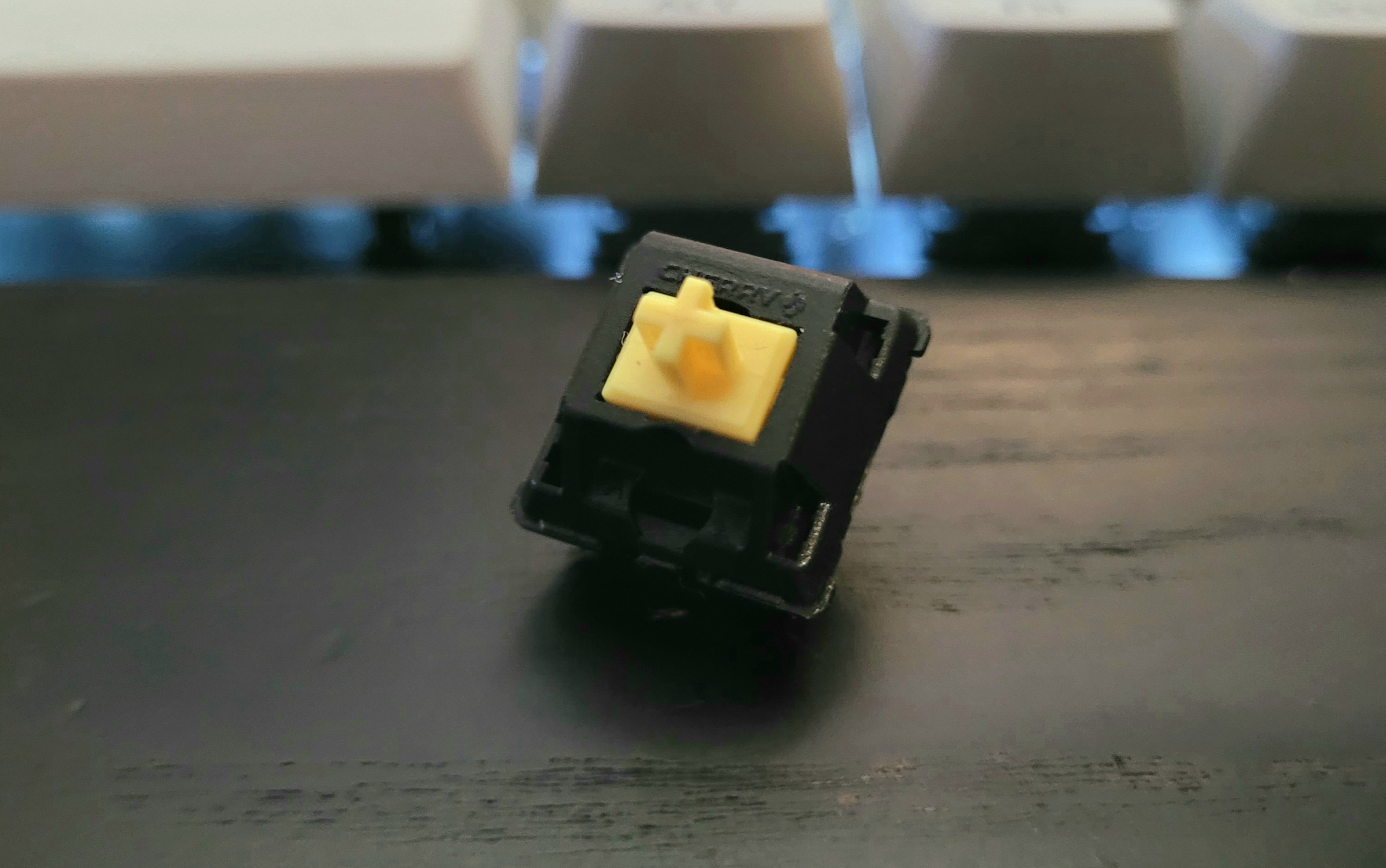

Poor Man’s Inks
  • Cherry MX Housing
  • Gateron Yellow stem and spring
In between Gateron Yellows and a Gateron Inks in terms of feel, sound, and price
Details:
Get closer to ink feel without paying ink prices
Keep in mind that I’m doing these comparisons with the switches unlubed and unfilmed.
One of the biggest complaints of Gateron Yellows is that they don’t sound that good, at least compared to other switches. The Poor Man’s Inks aim to try to fix that. The result is… they sound like your average Cherry MX switch. Arguably still better sounding than stock Gateron Yellows though, and Cherry housings can sound really good, especially with mods and use over time(Cherry housings are underrated IMO). Compared to Inks they’re louder and slightly higher pitched, however compared to stock Yellows they sound much deeper and are more clear and defined, they definitely thock.
The wobble is actually really good. In fact it seems like it’s tighter than the Inks and stock Cherries. Apparently Gateron stems are slightly oversized compared to other switches from what I saw when someone else put Yellow stems in a Cherry housing.
As for the smoothness, it’s… complicated. There’s actually a very slight tactile bump towards the bottom of the keystroke, around the 1mm mark. It’s because almost every linear switch has a ledge at the top of the leg, and most linear switches actually completely disconnect from the leaf, probably in an effort to be more smooth. Usually you don’t feel the ledge in most linear switches because the leaf and leg disconnect before the ledge, however in the poor man’s inks the leg and leaf disconnect at the ledge, and you get that small tactility. You only really feel it when you press real slow though, and is barely noticeable when typing fast, however there is the possibility of spring ping on a full board, especially unlubed. Other than that it’s pretty smooth. It’s not as smooth as Inks by a long shot but it definitely feels smoother than stock yellows. Basically, as smooth as a Cherry housing can get.
And finally, the cost. The namesake of the switch. The price of Gateron Yellows are $0.24 per switch. Your average Cherry MX switch are $0.35 per switch. In total the price to make these switches are $0.59 per switch. I’m sure you can get better and smoother switches for a similar price, however the point of these switches is how they compare to ink switches, which in general are $0.75 per switch. Cheaper than Inks = Poor Man’s Inks. On top of that there’s a probably a chance that you have Cherry housings laying around, lowering the cost (From what I know basically all Cherry housings are the same, though I’m not 100% sure).
Summary:
So in a nutshell, Poor Man’s Inks are in between Gateron Yellows and Gateron Inks in terms of price and switch feel. They are smoother than yellows, but not quite as smooth as Inks; The same can be said about the sound. They have less wobble than Inks and even stock Cherry’s. They cost $0.59 per switch to make compared to the $0.75 per switch for Inks. On top of that they use Yellow springs, which are highly regarded and what makes Gateron Yellows so popular. I’m thinking about putting these in my next board but I want to see what others think first.

I wonder how it is, compared to just replacing Gat Yellow top with Cherry top housing. From what I read, Cherry bottom housing is …not that good vs Gat Yellow’s
Looks like KS-3 variant of Gateron Yellow which has all vinyl housing and is supposed to be the best sounding variant.
Why didn’t I think of that… anyways I tried it and the results are actually pretty similar. The Gateron bottoms are higher pitched than the Cherry bottoms, but it’s not as bad as I thought it was. As for smoothness, the Gateron are slightly more smooth than Cherry bottoms, but I’m not the best at discerning smoothness and I’d barely notice the difference anyways. The best thing about this frankenswitch is that you could choose which bottom housings to use since it’s only two switches. You could choose either better smoothness or (subjectively) better sound. That’s pretty neat.

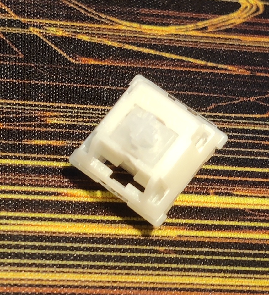

Hi, I’ve never frankenswitched before so maybe this is a stupid idea, but has anyone tried to take a NK Cream stem and put it into a Durock POM housing (maybe even lubed and filmed)? If so, I would love to hear your thoughts. I can’t find any videos or articles on this, so thought this would be a good place to ask.
I haven’t done this, but I would assume the affects would be minimal? since your exchanging one POM housing for another, my knowledge about this (I have creams and JWK switches) would lead me to think that the durock/JWK POM housings would need films and the creams would not.
There you go. They’re probably a bit smoother.
I saw this video, I don’t think they were using the Durock housings though. But yeah I was thinking they would be smoother since I commonly hear the creams are scratchy.
From what I get is that the nk_cream is scratchy cuz of POM on POM so it would likely be the same in a JWK-POM. But I’m curious to.
