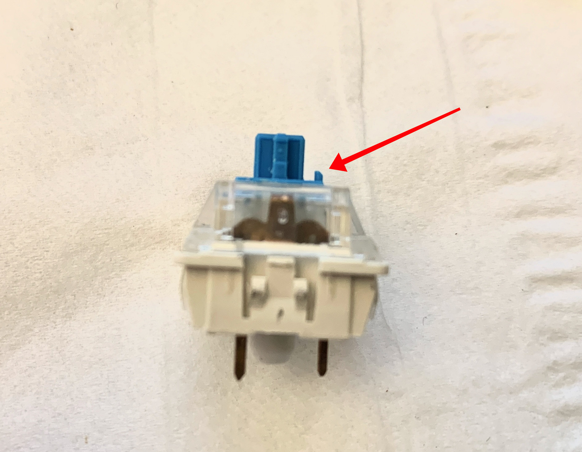

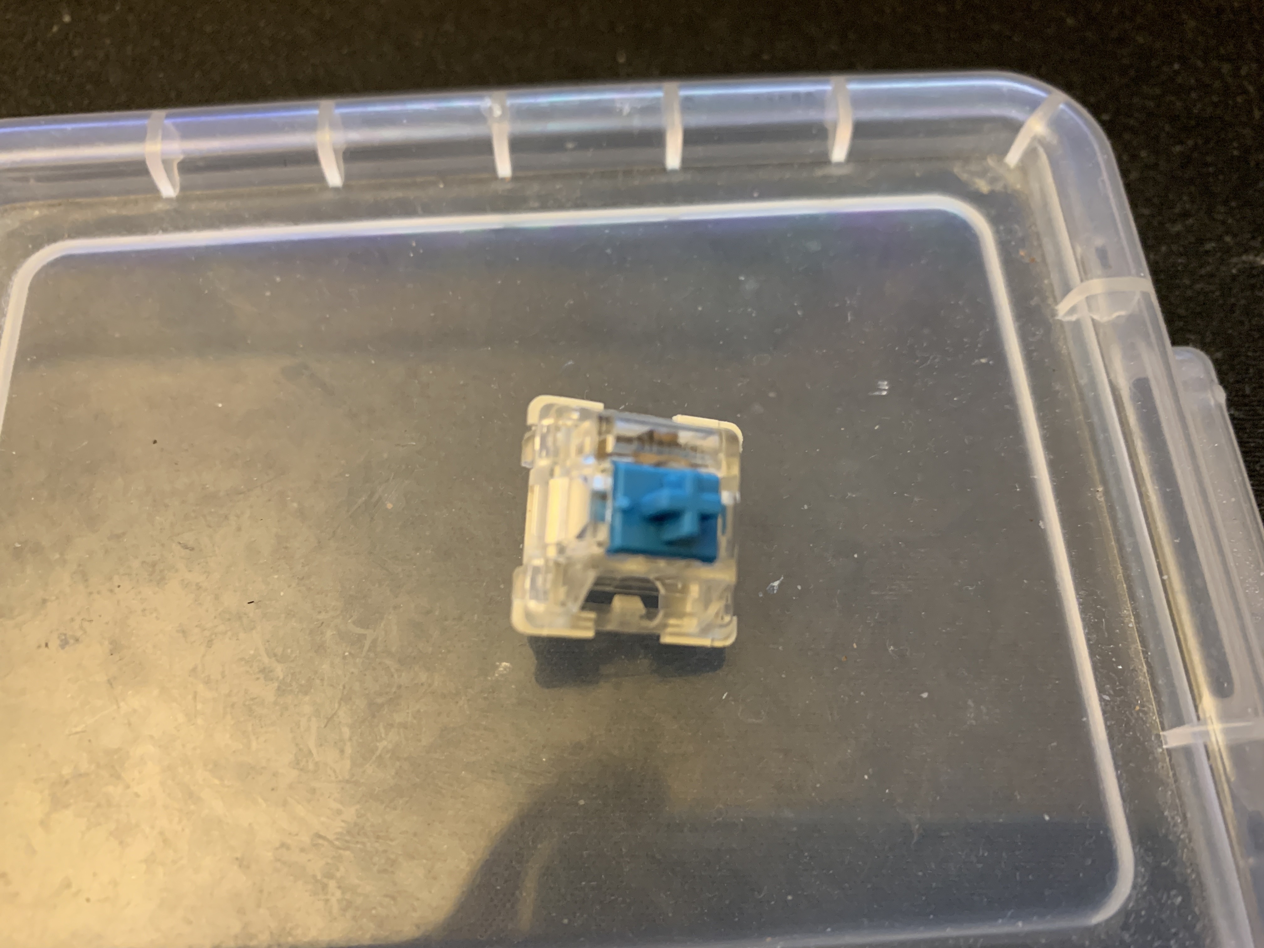

Slapstick - Cherry MX Blue stem in BSUN housing
This combo makes a loud slapping sound on bottom out. Similar to Holy Panda and Cream except not as high pitched. Other than that, clicky sound is extremely muted and feels like a milder version of MX Brown.
I was rather surprised by how nice it felt and sounded, enough to consider making a full board of this funny combo.
While I was assembling more Slapsticks, I noticed this little knob on the Cherry MX Blue stem. Clipping it off didn’t seem to affect the sound though. Weird.

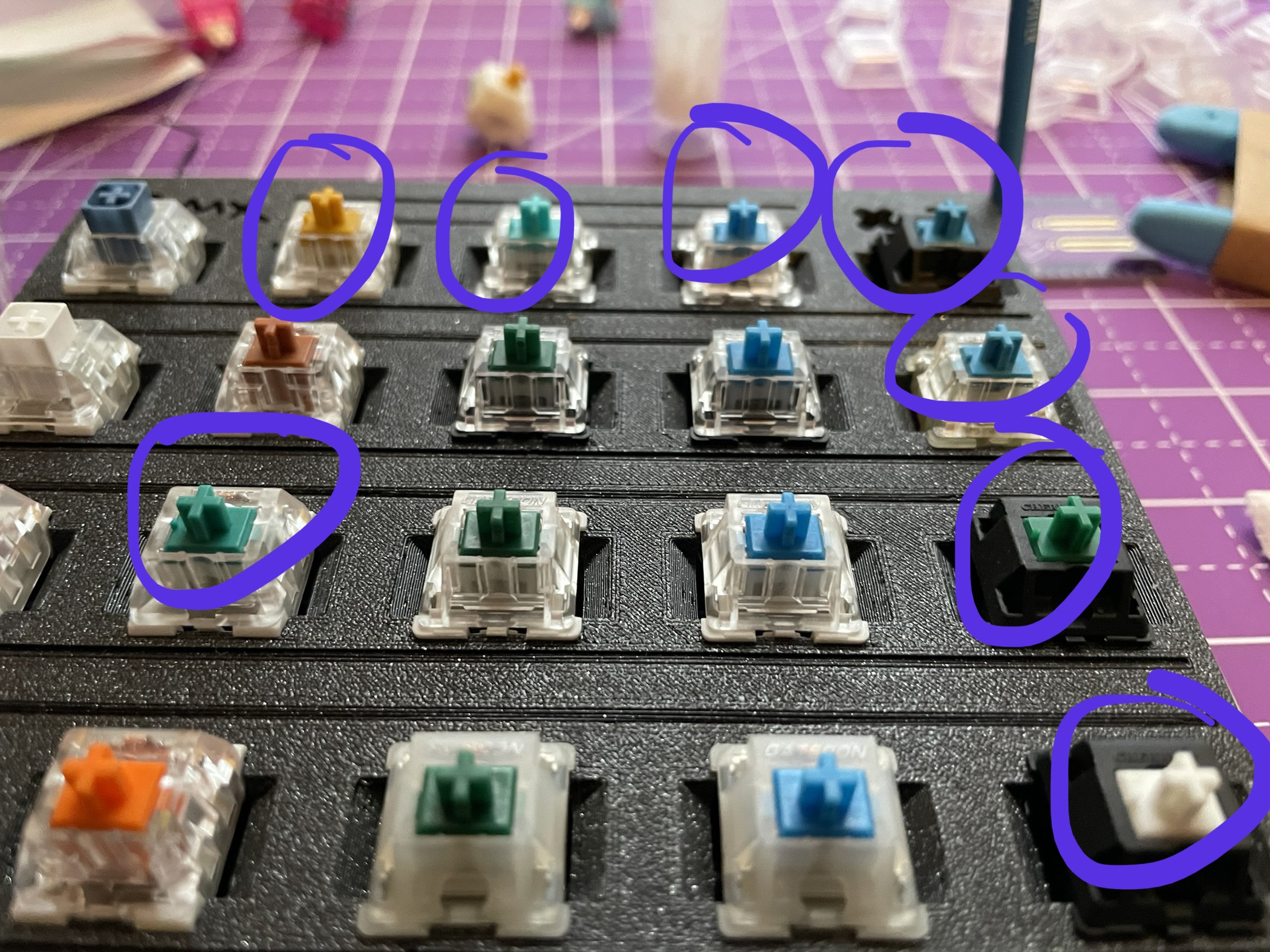

Yeah I noticed this when assembling this collection of clickies, and interestingly it is not wholly unique to Cherry:
8 of the clickies on this feature this little nub
Specifically:
  • Kailh Speed Gold (but not Bronze?)
  • Kailh Pro Teal
  • Outemu Teal
  • Outemu Blue
  • Cherry MX Blue (standard and clear)
  • Cherry MX Green
  • Cherry MX White
