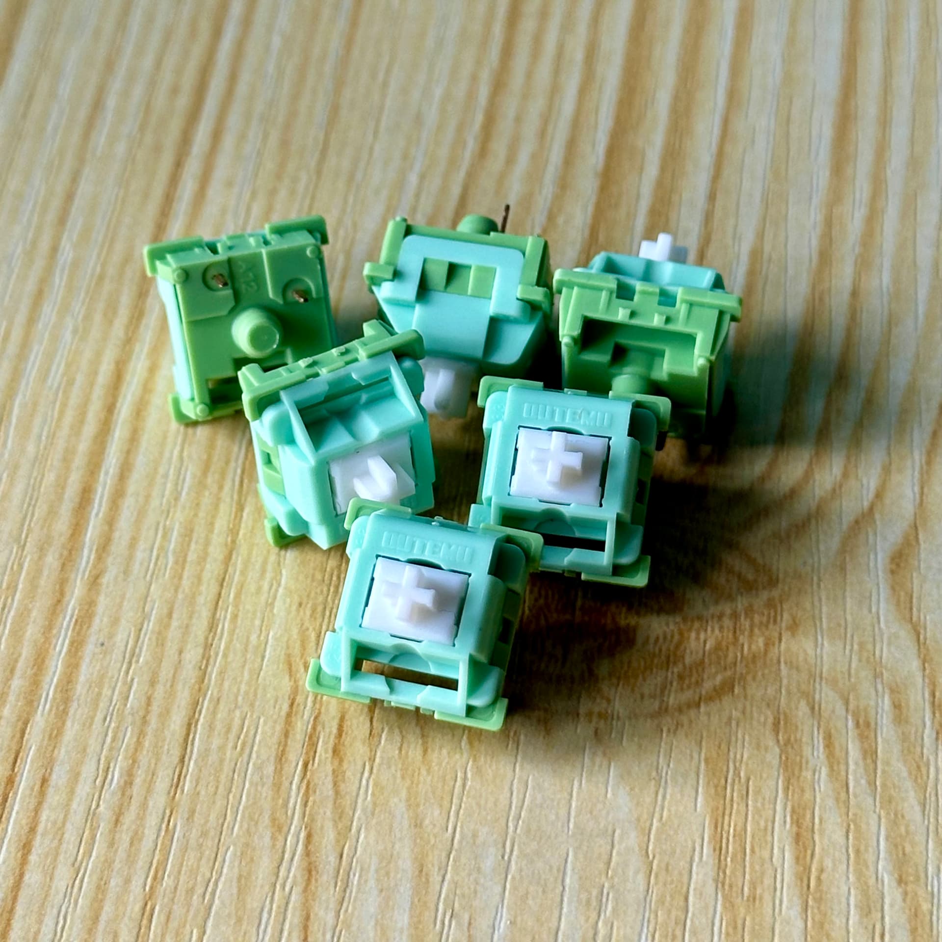

Hi everyone, so I’ve made a bunch of switches (U4 silent stem in Outemu Silent Lime housing). I was thinking of naming it Solero Lime for funsies, drawing inspiration from the 90s/00s ice cream from my childhood.
Inspiration
Solero Lime
  • Gazzew U4 silent tactile stem
  • Outemu Silent Lime/Lemon/Citrus housing
  • Payson 62g, 22mm double-stage stainless steel spring, donut dipped
I’m definitely enjoying this more than the stock Silent Limes. The downstroke feel is punchy yet silent, but the top-out noise/upstroke feel is inconsistent probably due to the inherent wobbly housing and the double-stage spring.
Hopefully it’s silent enough for my work space at the university.

OK, so I finally tried this.
It actually works!
The Silent Lime/Lemon stem fits very snugly, but it fits. I used a Boba “yes-slot” top [not the “no-slot” tight-tops]. Purple Boba LT base.
It turns out to be a very colourful switch.
I used the stock OUTEMU spring that came with the Silent Lime. It’s pretty long, maybe not ideal inside the Boba LT housing.
So far, the noise from this switch seems to mostly come from that spring. It would probably be better to use a regular 55 - 63.5 G spring, if they work.
But anyway, it feels like a Silent Lime, but in a Boba housing. So it seems to be a viable combination so far.
