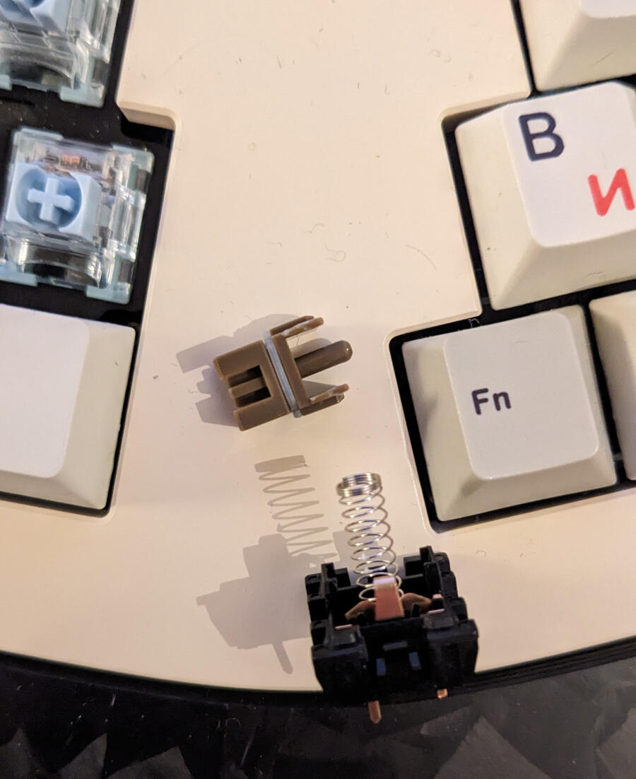

OK, so there are two layers to the logic of building the switch this way.
Objectively, I am not sure about the reliability of cheap OUTEMU housings. I have read about some of the cheaper OUTEMU switches failing after 6-12 months.
So I would prefer to use a housing of known high-quality. The Silent Lemon/Lime stem is unlikely to fail anytime soon, so it should be fine. Placing it in the Boba linear housing may allow for greater long-term reliability.
Subjectively, these are all OUTEMU parts we’re dealing with here. I thought it might be nicer to put the Silent Lime stem in a nicer OUTEMU Boba housing. It should work, right? What would a ‘deluxe’ Silent Lime be like? I would like to use a deluxe Silent Lime.
You’re right about the springs. Gazzew springs are pretty quiet. I think maybe a Gazzew 55 G spring of the type found in Boba switches might be ideal for this Silent Lime / Boba. But I haven’t tried it yet.
Would you recommend this deluxe silent lime? I might consider doing it too since I have few of the lime stems now
With the stock, unlubed sping? I wouldn’t recommend it just yet.
It’s a bit awkward and noisy with the stock [Lime] unlubed spring.
Properly-lubed with something like a lubed OUTEMU 55 G spring? Maybe. I suppose I’ll have to try that.
BTW do you happen to know what kind of spring the Silent Lime/Lemon uses?
It seems to be very large, resembling some 22mm springs I’ve seen.
I will see if I can try it in the Boba LT housing with a more reasonable OUTEMU or Spirit 55 G spring.
