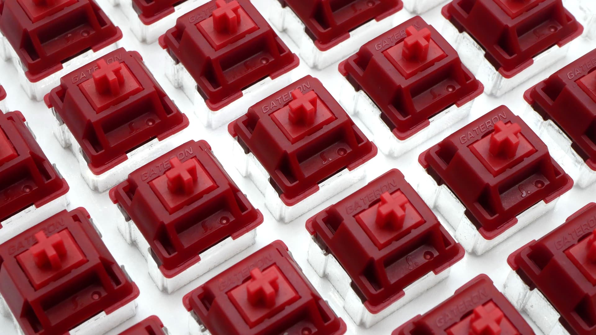

Hey all,
The first full length review of 2025 is here and I couldn’t think of a better way to kick off another calendar year of switch reviews than with a truly never before seen style of switch. This week I take a deep dive into Sillyworks and their “100% Tactile” collaboration with Gateron in the form of the Sillyworks x Gateron Type R switches.
Article: Sillyworks x Gateron Type R Switch Review — ThereminGoat's Switches

Now these sound interesting enough to pick up - thank for letting us know what they’re all about!
Wasn’t somebody on Keebtalk asking for exactly this back before Christmas? A Tactile with no linear zone in the force curve?
Yep - thought about that too, and since you mentioned it I went ahead and linked this post from that one :+1:
This is probably the closest thing I could image to the “no pre travel” switch.
A lot of switches start the bump at the beginning of the keystroke unlike cherry tactiles. I think what makes this switch unique is that the bump continues all the way to bottom.
Edit: I just realized that was your post that was requesting that switch :stuck_out_tongue:
Isn’t the Harimau switch pretty close / all tactile bump?
Also the Tecsee Green Jacket tactiles are almost completely bump (very small linear travel at the end)
But isnt that a clicky switch??
nope Harimau Switch Review — ThereminGoat's Switches
Well of course the Harimau is really close, but I was referring to the Green Jacket being a clicky (you know, implying a click jacket?).
lol funny. knckeys had a “jacket” series to tie in with squid game season 1. the red jacket was an aflion-made linear. the green jacket had both a linear and tactile KNC Keys Green Jacket 1.5 Linear Switches – KNC Keys LLC (looks like the tactile is no longer available)
This looks super close to the topre 45g force curve to me. Wouldn’t this be a really good MX topre alternative?
Need to get my hands on some of these!
I got a few to sample and to me they don’t compare well to Topre. The downstroke is far too short (like jailhouse blue short), and it’s ends abruptly and harshly.
