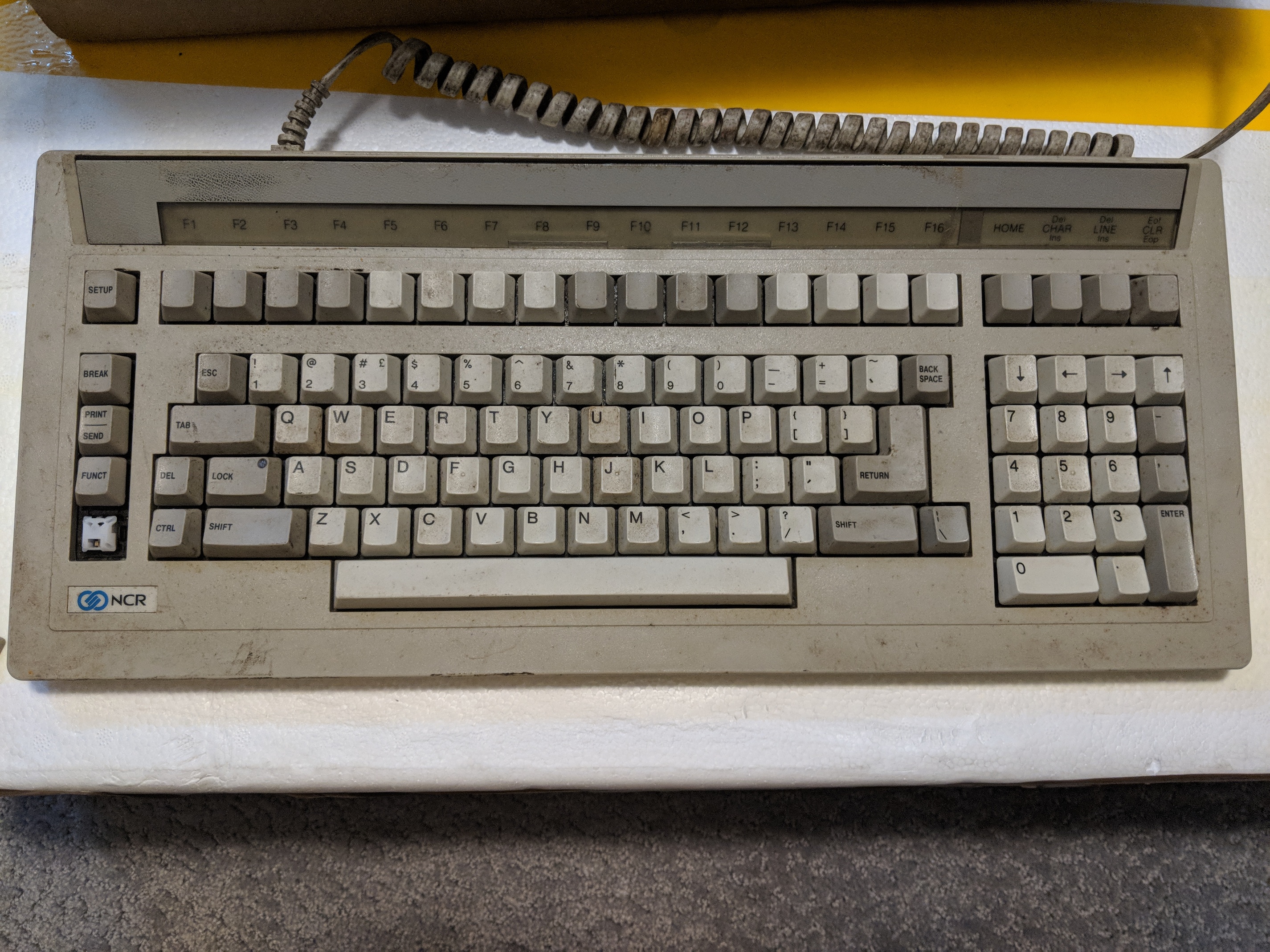

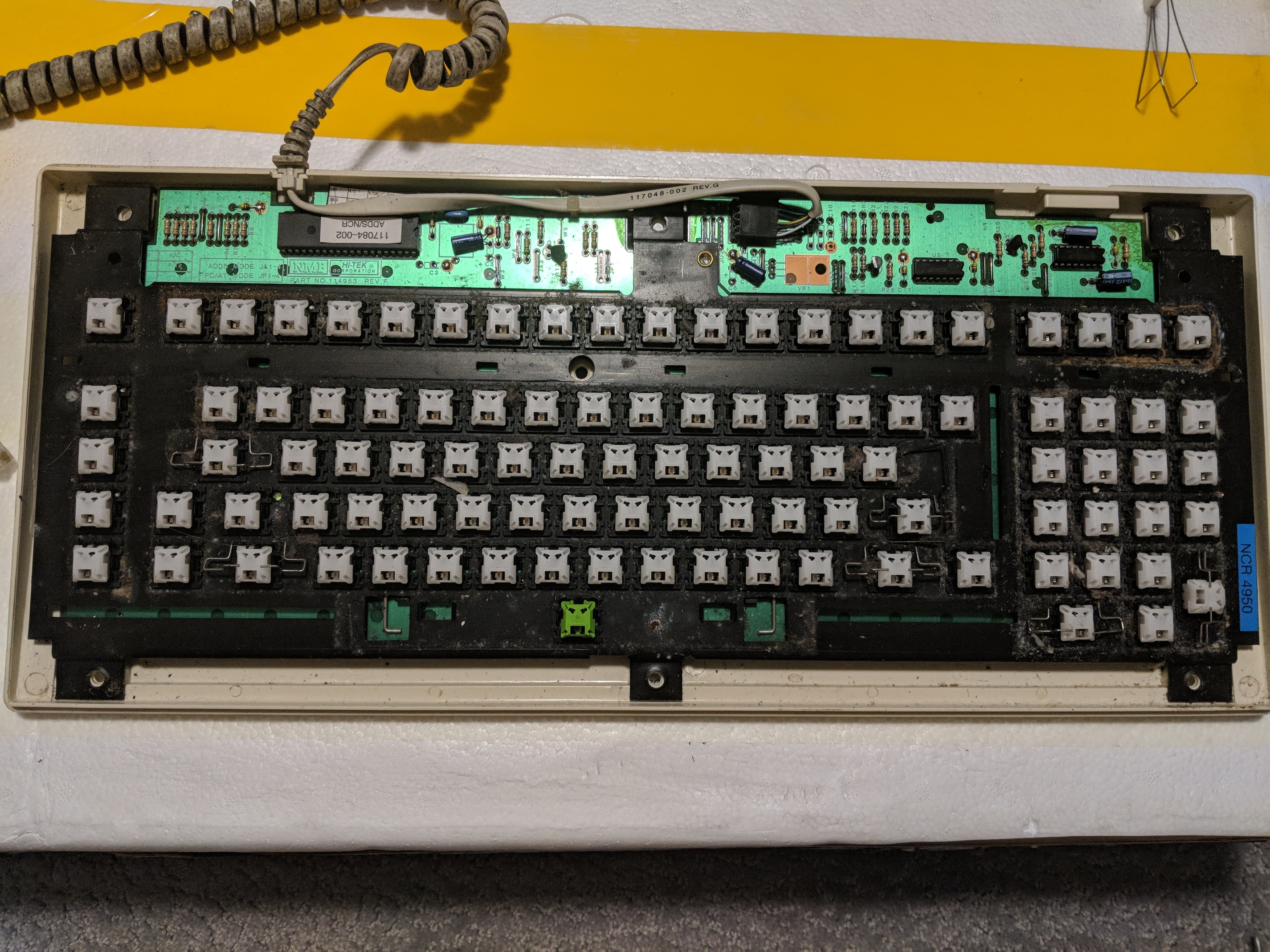

First one showed up today. Here it is in all its gross glory. This one’s going to need the most work. NCR 4950 with linear white Space Invaders. Teardown, cleaning, and switch lubing is in short order. Seller figured out the pinouts so I should be able to adapt it fairly easily.
Currently the switches feel eh… Terrible. But the board is filthy and the switches are super susceptible to dirt and dust so I’m hoping they’ll feel much better after a restore. The spacebar is unsurprisingly way too heavy, which I expected but wasn’t prepared for how heavy it actually was. I’ll probably do the standard spring swap with a less used key to make it lighter.

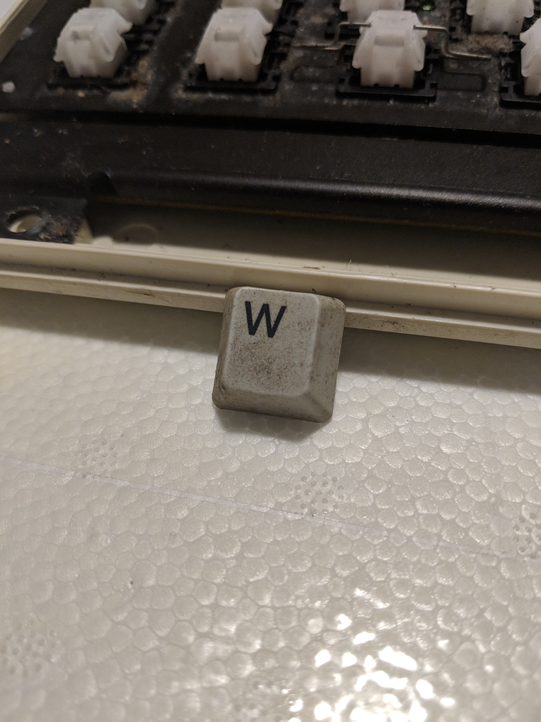

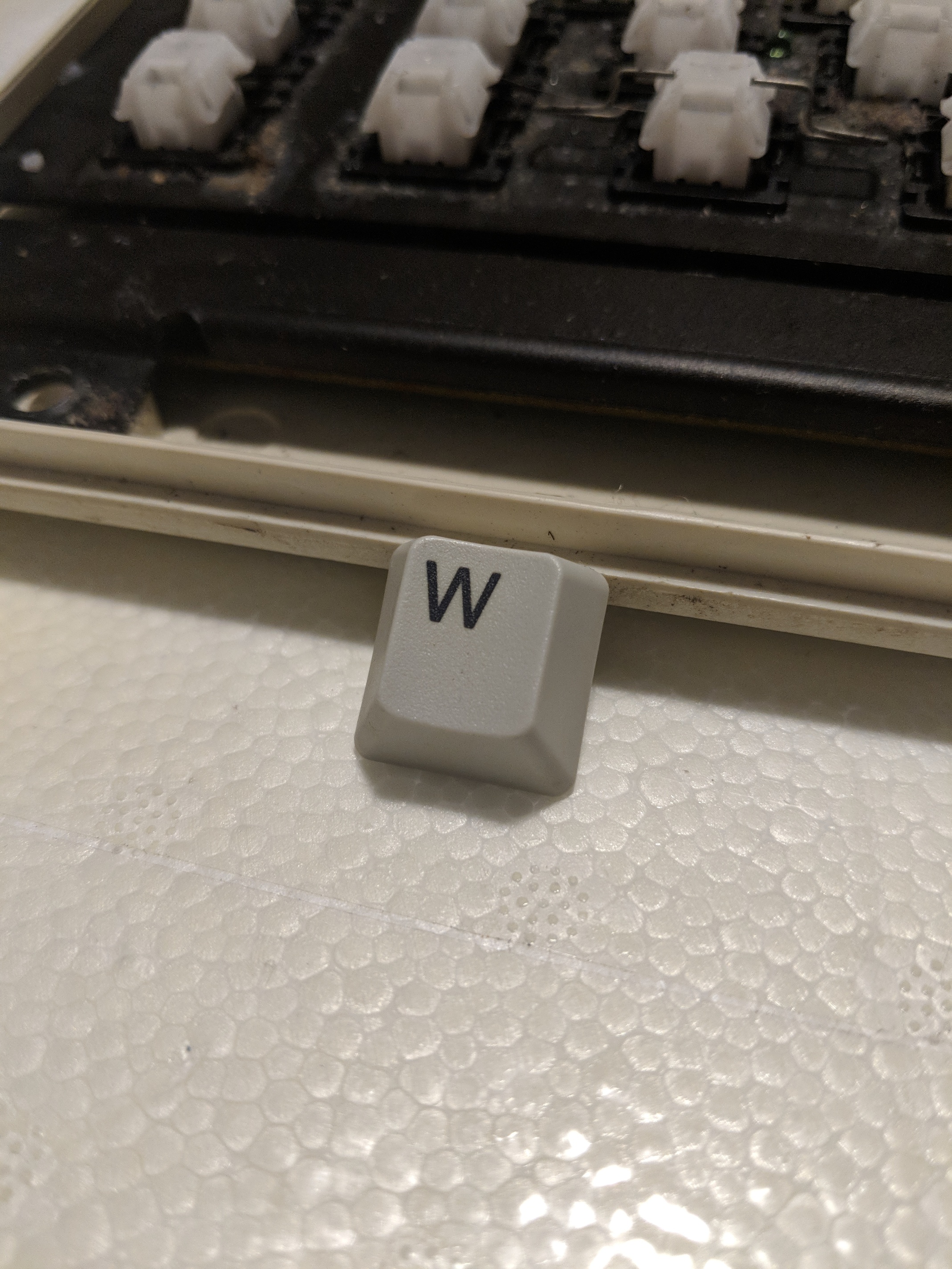

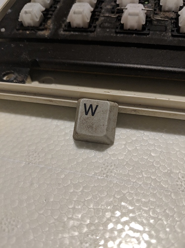

I’ve got it disassembled and am in the process of cleaning. I’m doing the keys individually by hand because they’re so bad. Check out the difference though:

The dust problem comes from the sides all around the slider being totally open. It’s almost like using a switch that doesn’t have a top housing, because they really don’t. The slider is the top housing and the whole thing moves. The dust and dirt settles into the bottom of the switch and then gets up into the slider. Plus the contacts are totally exposed under the keycap and if anything gets between those hands the keypress won’t register.

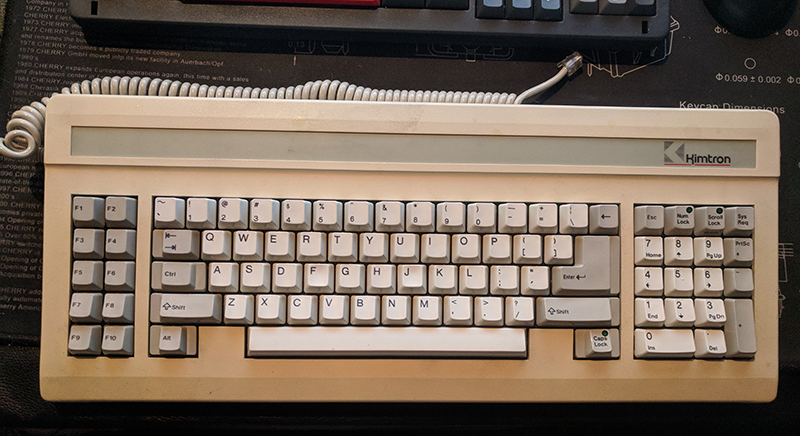

That KimTron keyboard, quite literally, has my name all over it. How intriguing! Never heard of that company. What’s it like to type on? Have you used it with a modern machine?
