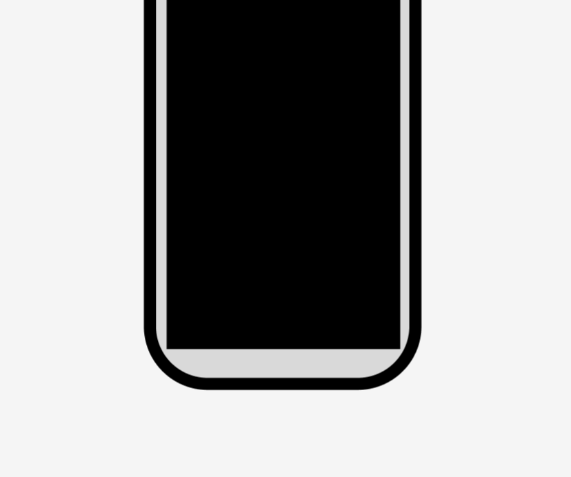

Kailh Black v2 stems will fit but bottom out sound will be squishy bc v2 stem pole is not chamfered (see illustration). This is why I used Dremel to make them fit. Kailh Black v1 stems which AFAIK are of same length should not have this issue.
