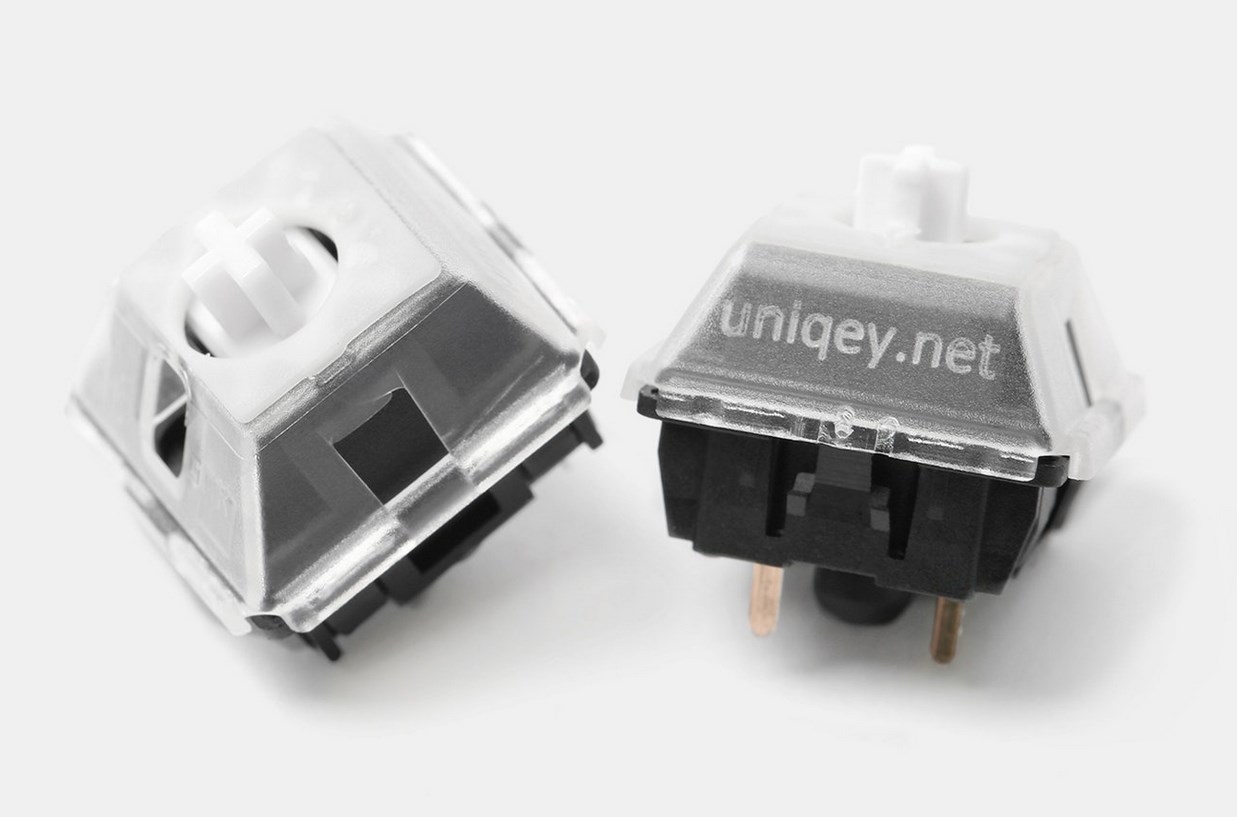

CAUSE: Loud clacking sound was caused by the ribs of the spacebar striking top of the switch. The sound varies depending on height and shape of the ribs as well as shape of the switch top.
FIX: I cut small bits of surgical tape I had around and taped the ribs. More layers you add reduces sound as well as key travel. For my taste, I used two layers on two vertical ribs. There is no need to tape all four ribs. Two is enough. Material of the tape used will affect the outcome. Surgical tape is made out of paper like mask tape but more cushiony so masking tape will likely dampen sound less. Now all of my boards have this mod.
