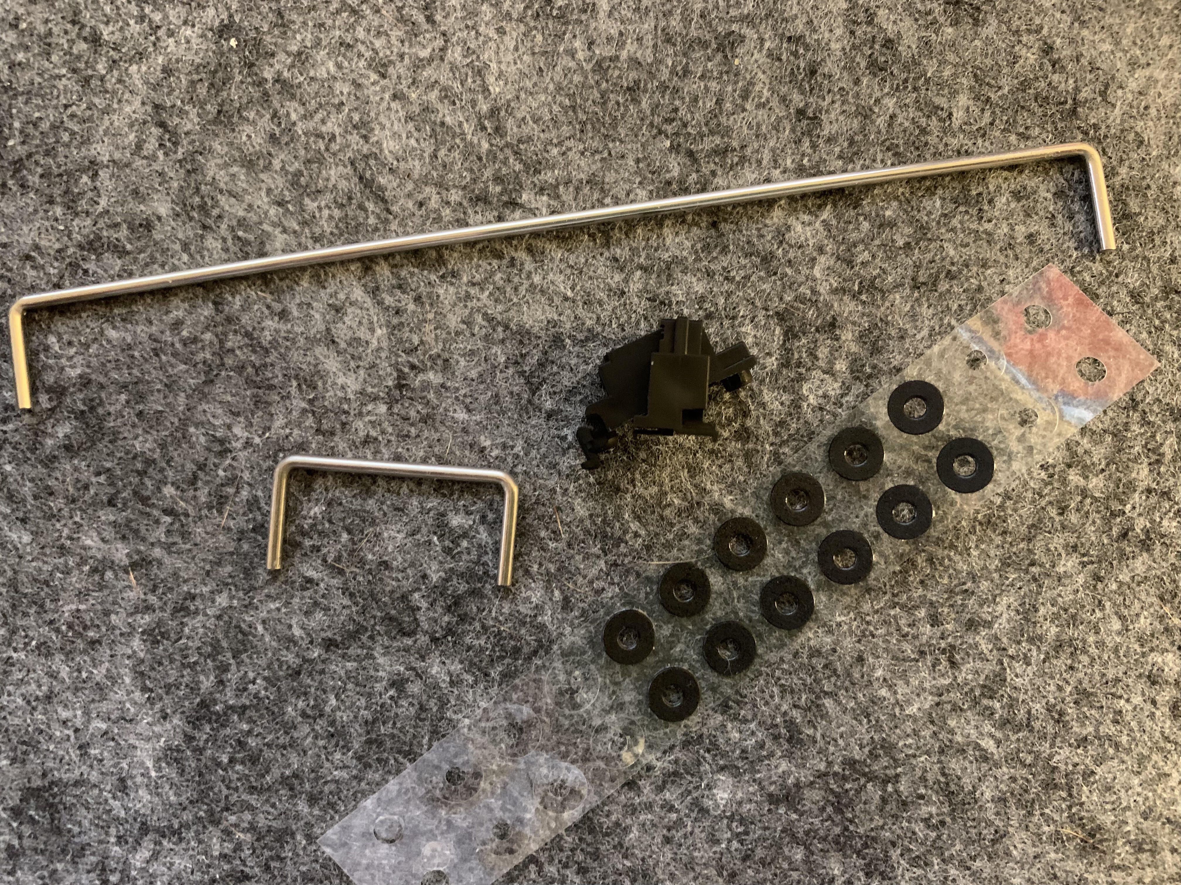

Those are the stabs which came with the board. I’ve used the adhesive washers + as recommended in different videos I’ve clipped of the little hooks on the bottom of the stems too.

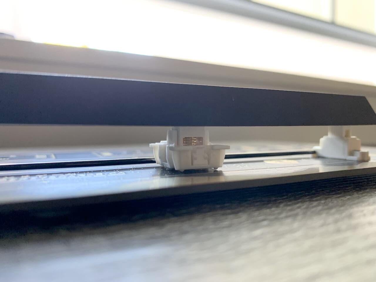

What happens when you remove the switch top, does it still sound uniformly rattly?

It wouldn’t, but it would eliminate the possibility that the center press rattle I heard isn’t from the switch slider unnecessarily colliding with the top housing due to a bit of spacebar warpage. If the rattle persists, then you know it’s either a bent wire or more lube is needed to properly insulate the wire within the stab stem.
Ahhhh I see! Thanks a lot for the tip and the explanation. I make sure to try this too.
