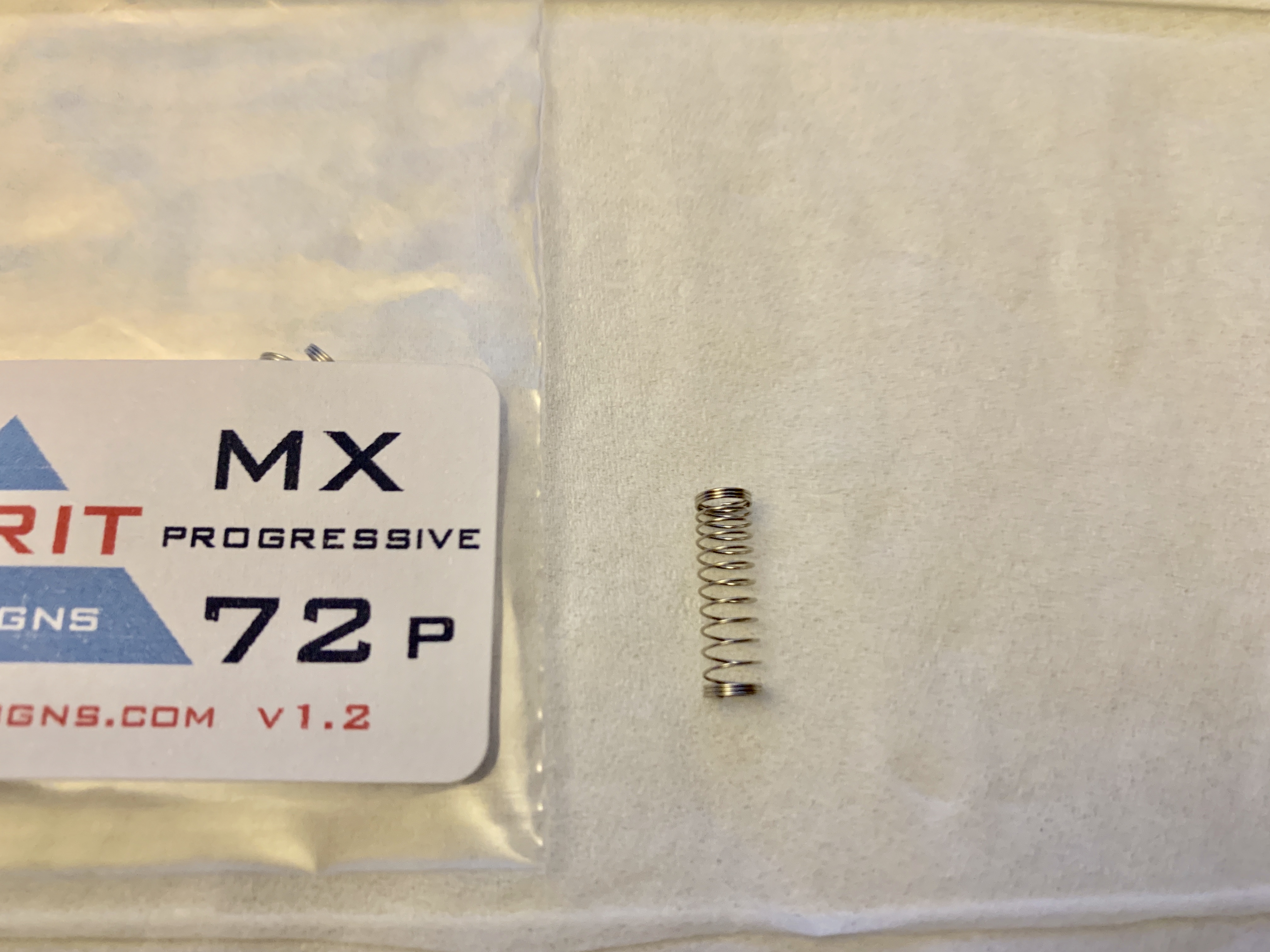

SPRiT progressive springs are wound tighter toward the top than bottom.
Sure, but I’m unclear on how the compression rate would differ based on orientation. Shouldn’t the force be distributed mostly-evenly through the whole spring either way?
Tighter wound part is stronger than the sparse part so, when compressed, weaker part will give first. This results in lighter feel at start that gets heavier toward the bottom. As to why having the weaker part on top would differ, I think the overall effect in opposite orientation is similar but not exactly same so the right orientation is the one the spring was designed to be used in.
I’ve verified that two orientations are similar but not exactly same. Which orientation you use is entirely up to you, I’d think.
That sounds about right! I’d imagine there would not be zero difference but that the difference would not be so much as to fundamentally change the progressiveness of the spring.

Also just a minor correction, the part with more coils is the softer part of the spring.
You can think of compressing the spring like twisting a long piece of steel wire. If you take a section of the spring that has, say, 4 coils for every 2mm of length, compared to a second section that has only 2 coils for every 2mm of length, if you were to take those 2 sections and straighten them into a straight wire, the first section would consist of a longer piece of wire than the second. The deflection is spread out over more wire so it will be softer. If it helps you visualize it, you can also consider a really long piece of wire vs. a short one, and imagine if you clamped one end into a vise and tried to move the other end 6", which would be easier? Obviously the longer wire.
The part with the coils spread farther apart is the stiffer part. To move the spring the same distance, the wire has to twist/bend more per length of wire.
You are probably right. I just tried compressing one of the progressive springs and can see that the part with higher coil count compressed before rest of the spring. Thanks for correcting my understanding of how spring works.
