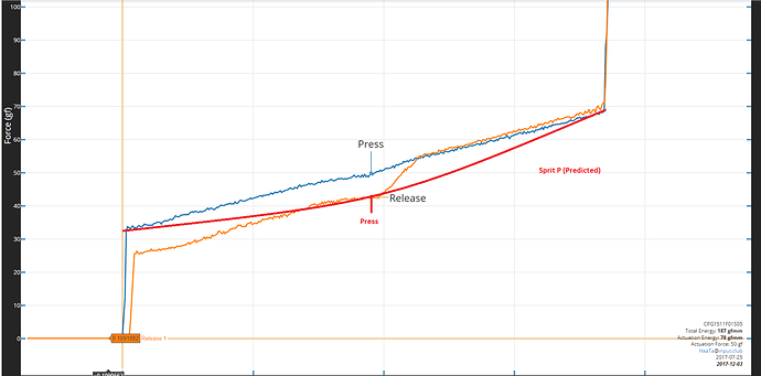

The actuation seems to be about 5cN lighter for the P. The graph that’s on the website to demonstrate the spring difference is…misleading. Arbitrarily using Haata’s box black graph, it’s probably more like this.
