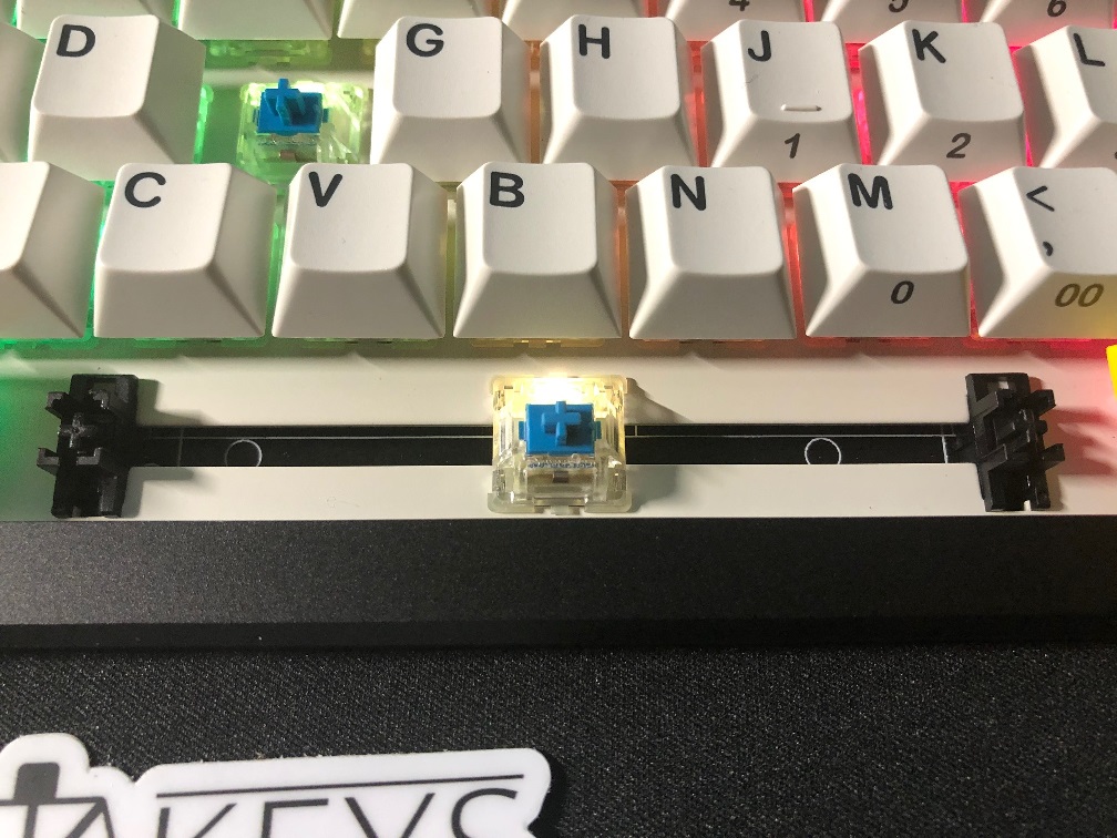

I just received my Norbauer case and I am planning to mod my Cooler Master Masterkeys Pro S with some Kailh Box switches.
The original stabilizers that came with the keyboard are a rattling disaster, and I thinking of replacing them with the ones from Zeal.
Problem is I have never changed stabilizers before. So I have absolutely no clue.
Question, are the stabilizers only replaceable with the removal of the plate? The stabilizers that came on the keyboard seem like the usual ones, so I am assuming the Zeal ones would be a direct replacement.
zealstabilizers6
No Zeal’s stabilizers will not work on your plate as it is cut for plate mount stabilizers & Zeal’s stabilizers are PCB mount screw in ones. Basically the hole in the plate is not big enough to let Zeal’s stabs come up through them & also I doubt the PCB has the mounting holes needed for PCB mount stabs. I would suggest going with genuine Cherry plate mount stabs, clip & lube them before installing them then you’ll have nice & quiet stabs!
Also even if your board could use Zeal’s stabs you’d have to de-solder the whole thing to install them, while with plate mount stabs you’ll only have to de-solder the switch they are stabilizing to replace them.
Thanks Rob27shred for the wonderful advice and link.
So with the stabilizers on my board, just desoldering & removing the switch will allowing me to remove the corresponding stabilizer? Sweet.
No problem! Yep, once you remove say the space bar switch the stabilizer for it will be able to be pulled up & out by pressing in the the locking tabs behind the cross mount on both sides of the stabilizer. That’s the one nice thing about plate mount stabs, they are installed from above the plate. From the pics you put up it looks the locking tabs will be on the north facing side of your space bar stab. Usually the locking tabs are on the opposite side of the where the stabilizer wire sits.
Brilliant… I am going to order meself some stabilizers and lube now.
