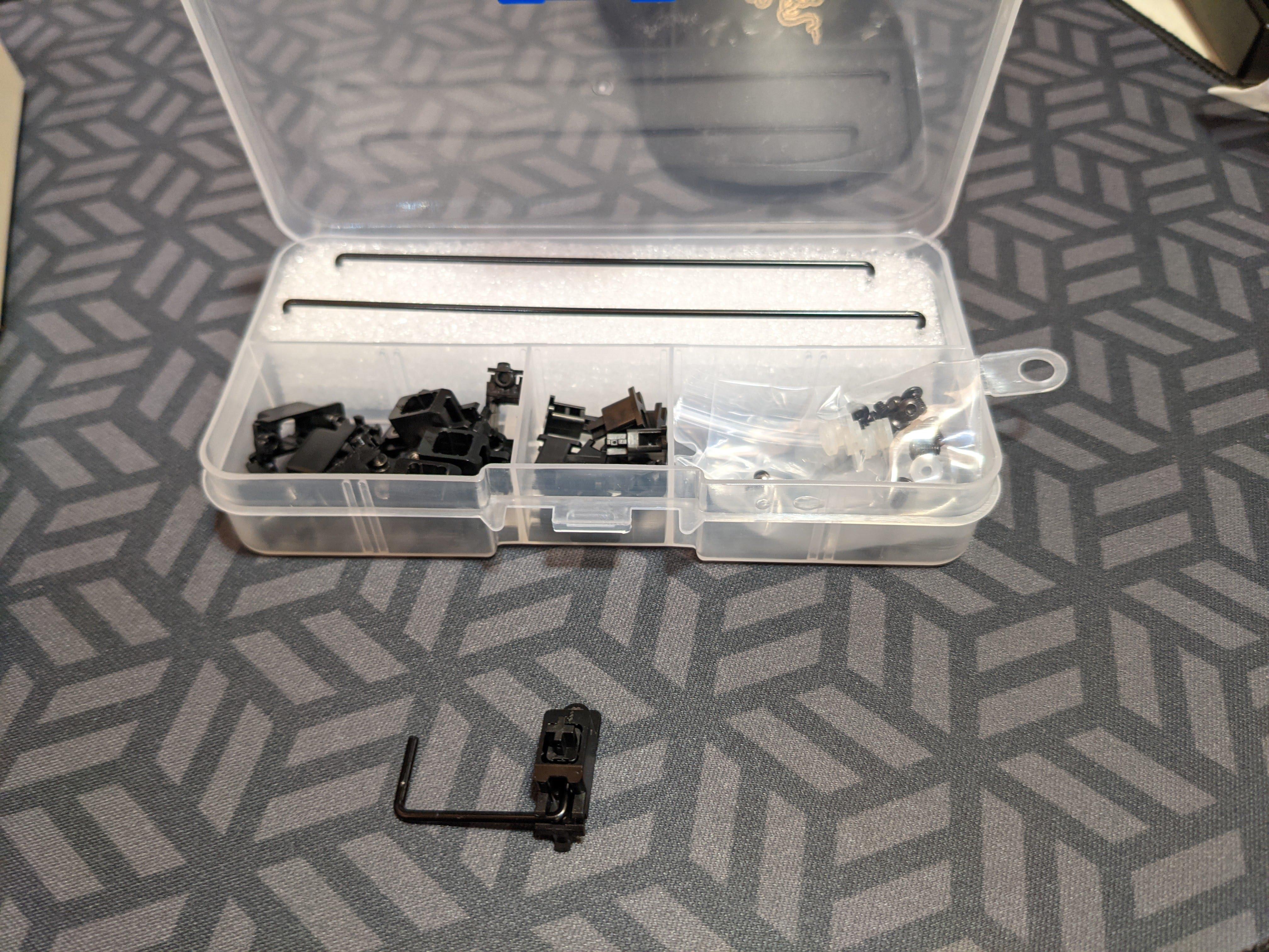

They have arrived!
I will give them a test tonight. Initial thoughts:
  • Packing box is a good touch, well protected will definately reuse it for stabs or something else
  • Black color is nice especially the wires. I feel like the stabs will fade into the background of the plate rather then sticking out (I like Durok v2s but sometimes the gold wire peaks through)
  • Super tight wire to put in (need to play with angles a bit more to perfect skill)
  • Hex screws are an improvement over Phillips
Edit: I tried a couple of them comparing to Durok v2s.
Basing my views compared to Durok v2s which I use by default and haven’t had any problems with. I didn’t check any other reviews other than to see that they were being made and they were good so to not be too bias. (Used Leopold keycaps instead of the recommended GMK, I had 2 sets of identical keycaps figured it was better to use the exact same key between the 2 different stabs for comparison)
Good
  • Wobble is less then Durok v2s. There is a video in the Imgur album. The video is a bit more dramatic then what can be felt in real usage but it is definately an improvement. Reminds me of going from something like a zeal v2 to Gazzew Boba in regards to wobble)
  • Hex screws stay on the head of a driver extremely well (huge improvement for install process)
  • Rubber O ring. Looks better then a red washer from Durok. It is pretty squishy which makes over/under tightening less of a concern.
  • Black color of the stab housing and wire blends into plate very well, I prefer this look over Durok
  • Edges are smooth (comparing this to cherry plate and oem ones which are very sharp)
  • A few people on discord asked me about the case. It is nice in the sense of protecting stabs. However, it is an inexpensive plastic case and feels like it costs about $1, which it does (the 10 grid one from: https://www.aliexpress.com/item/32965626279.html) (guessing the case is only temporary until the prototype phase is over)
Not So Good:
  • After the wire is snapped in before installing if the insert falls below its normal stopping point it gets stuck. And needs to be nudged back into place. This is a bit frustrating. Can see someone who isn’t patient trying to install it on the PCB like this and having problems.
  • Do not snap into the PCB as securely as Duroks. When Duroks are set into the PCB they are pretty secure. For Staebies, some positions and PCBs I tried were better then others. However taping it on something or a slight shake would cause the stab to fall out. Fortunately I have 2 hands :raised_hands: and holding the stab with one hand flipping the pcb over then using my other hand for the screwdriver with the and screw stuck on ready to go worked well.
Stuff I need to get used to:
  • Lubing. I could lube Duroks in my sleep these are just different. Need to go through a few more iterations to get the technique just right. My first one I did just like I normally did and it ended up with a little bit of ticking.
  • Snapping wire in is tight by nature. Believe inserting the wire when the insert is all the way up feels easier.
Conclusion, I am not ready to bin all my existing stabs and replace them with these. But I would buy them again and look forward to using them in my next rebuild to give a full test (sometime over the next few weeks). I think they will only get better and it is very encouraging they are taking feedback.
Photos (photos are on Imgur to not take up too much Keebtalk resources):
https://imgur.com/a/Kx1TRMP
Edit: 2 fully installed
Finished building up my daily driver with Staebies. For lubing went a heavy on dielectric (extra were the wire clips in and and in the back of the insert along with a normal amount on the wire itself). On the insert a medium coat of 205g0. Then spamming the stabs removing the keycap and wiping any excess lube off. Only one stab needed to go in with a Q-tip to remove excess lube to get rid of a little sluggishness and bring back the switch characteristics. They are perfect no ticks extremely little wobble for a stab couldn’t be any happier with them. (I could have probably gone lighter with the lube but since they came out so good I didn’t feel the need to try a bunch of different things)
