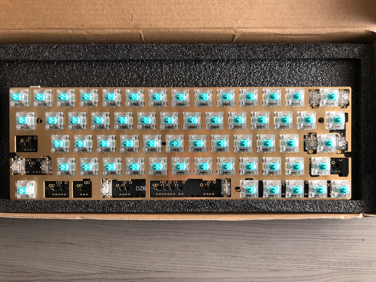

Hi people
I got all the parts in and as usual did the deep dive into soldering but I’m stuck… and I have to return the soldering iron on Monday.
For my keyboard, based on the DZ60 PCB from KBDFans, I’m after this layout:
From what I understand (and hopefully did so correctly) the PCB supports this, if you choose the correct plate and to my knowledge I did. But I don’t have the keycaps yet, as I’m undecided between Dracula, Phosphorous or Ursa.
But this PCB has so many holes, I’m not sure where to solder the switches in?
I know the “up” arrow switch should be more to the left. First I put it in incorrectly and to make it even worse, I forgot that one was in the wrong place and soldered it onto the board :joy: So I’m going to get desoldering wick to get it out and place those two correctly. But the capslock, left shift, left OS, left ALT and spacebar are a bit unclear where to solder them.
Left shift should be a 2U in the end and the spacebar a 6.25 if I remember right.
Another question is if I buy the GMK Phosphorous Core kit + spacebars if I have everything to cover this layout/board? I could buy the ortho as well, to have the 1U right shift, but I can use one of the “dot” keycaps for that?
TL;DR
1/ where do I solder the remaining switches for the example layout?
2/ is the “core” set of phosphorous + spacebar enough to cover the entire board?
Caps lock should be the one on the right. Left shift should be centered between the stabilizers.
The bottom row is more tricky visually so let’s go with measurements. 1U is 19mm. Super and alt are 1.25u in the layout you want so measuring from the center post of ctrl 23.75mm should get you the super placement and another 23.75mm to get the alt placement. Spacebar is 6.25u, so ((6.25/2)+(1.25/2))*19=71.25mm from the center post of alt.
The phosphorus base kit includes everything you need except 1u shift. It does include a few 1u “dot” keys so if you’re OK with that you wouldn’t need to get the 40s/ortho kit.
@Laughmaster Thanks for the information. I was able to complete the whole board and by placing some switches from another keyboard I think everything should fit whenever a dedicated keycap set for this board arrives.

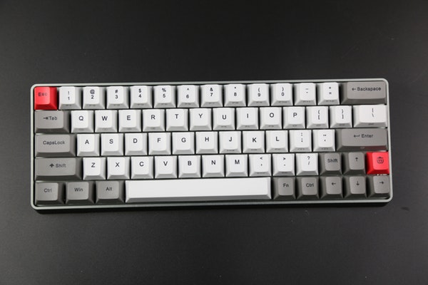

I found that KBDFans has a clone named Maxkey Dolch SA, but I don’t see the sizes for the keys listed there. So I’m wondering if this set is appropriate for my layout (see this post for layout). I’d need a 6.25 space bar and a left 2U shift. For the right shift, I can use a novelty keycap. I know it’s a different profile to those I want to join the GB for, but it seems to be only one of the select few keycap sets readily available.
6.25u spacebar is the standard, so you don’t need to worry about anything not being compatible with that. It doesn’t look like that set includes a 2u shift though, the only extra shift key looks like 1.75u (it’s slightly shorter than the numpad enter key which is 2u tall).
But, if you want a suggestion of something from KBDfans that would work, there’s these two sets, which imo are hideous individually but if you buy both you’d have a full red set and a full yellow set: Set 1 / Set 2. Plus they’re dirt cheap on account of the aforementioned hideousness, less than half the price of a maxkey set to buy both of them.
These maxkey sets are slightly closer though they still don’t include a 1u shift: Gray and blue / White and green
