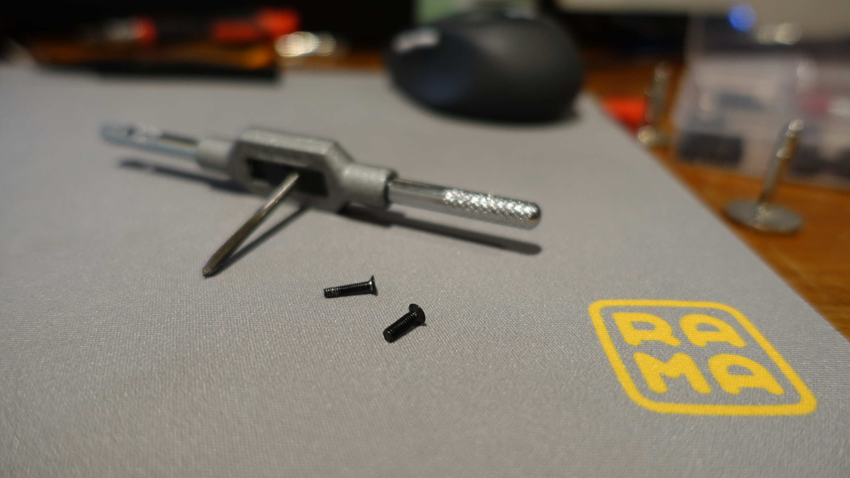

Hi Everyone,
Just wanted to give an update on how I went with the board.
After asking around with some friends, I heard about a tool called a ‘tap’.
The idea is, you screw it into something and it adds threads. I bought a really cheap one off Aliexpress and screwed in an m3 head (standard screws are m2). Then, I tried out an m3 screw and it worked perfectly.
The image below is the tool and an m2 screw to the left of an m3 for comparison.
Hope this helps someone out there!
This is great! I also stripped a couple of mounting holes in my 5 degree case. Do you have a link to the tap you bought on aliexpress? I’d definitely like to give this a try.

Here’s the link: https://www.aliexpress.com/item/11pcs-set-M1-M1-2-M1-4-M1-6-M1-7-M1-8-M2-M2-5/32874218293.html?spm=a2g0s.9042311.0.0.7caf4c4dWYnTMv
Just remember to unscrew the tap counterclockwise when you’re done, rather than pull straight up and undo your great work.

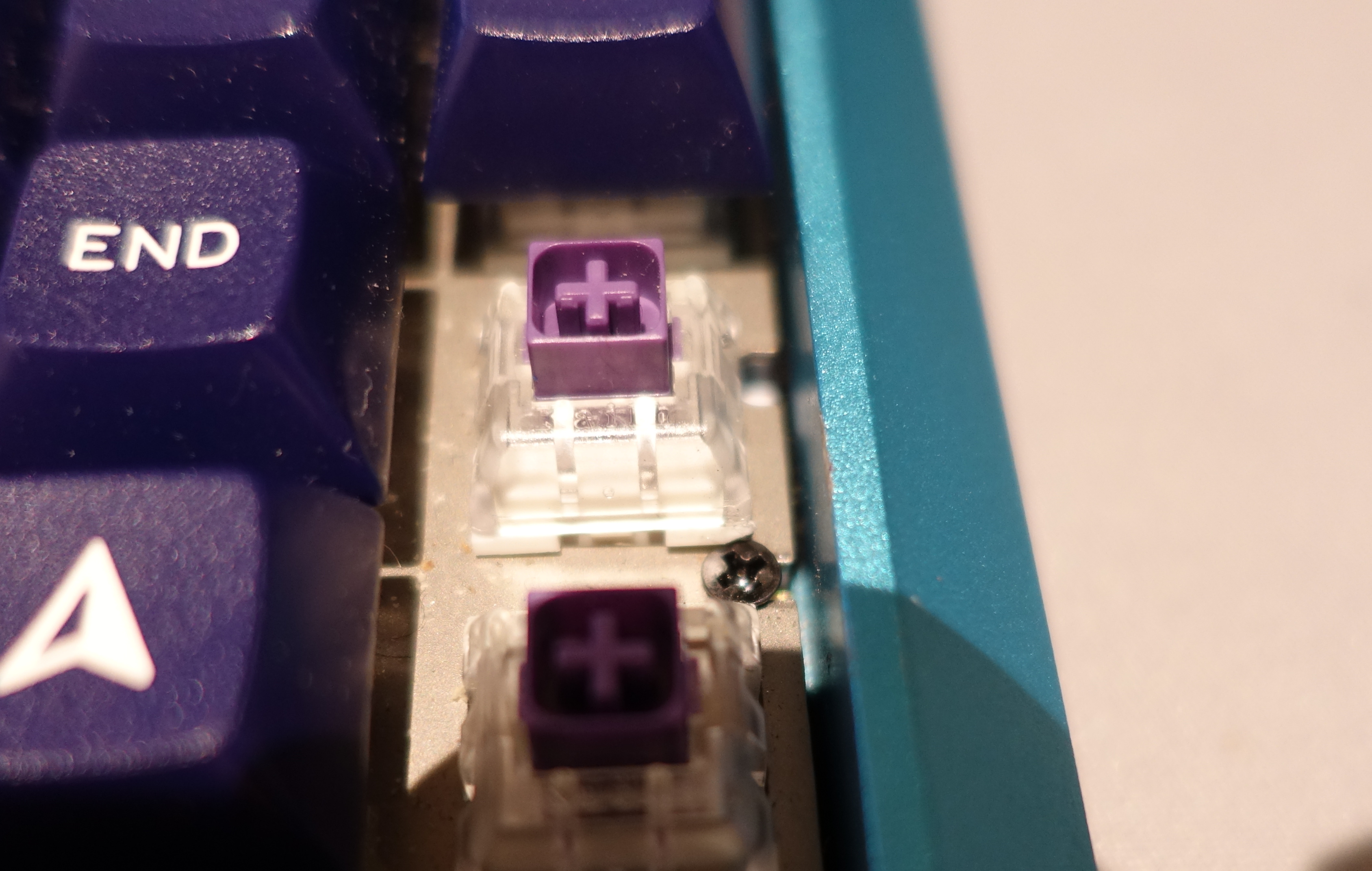

And here’s another pic, the m3 screw did make contact with a neighbouring switch, but not in a way that caused any problems.
Nice, thanks for sharing! I’ll definitely pick one of these tap sets up and fix my case. With the stripped holes, the board was pretty rattly to type on
