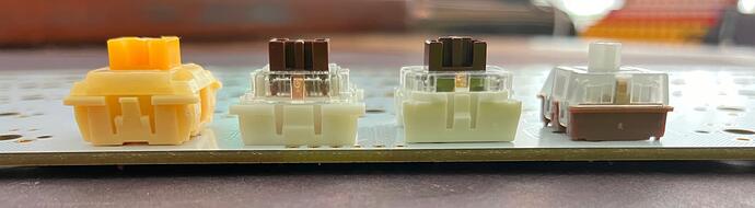

Kailh Half-Height, Tactile (brown) and Clicky (blue) variants. WS Silent Tactile normal sized switch for comparison.
From left to right: Tecsee Middle Tactile, Outemu Medium Tactile, Outemu GTMX Tactile, and Kailh Half-Height Tactile.
Close up of Kailh Half-Height to show snipping off the legs.
Close up of Kailh Half-Height showing that they fit in a MX footprint only when the legs are removed.
Comparison of Outemu Medium (left) vs. GTMX (right) sliders.
Sliders from all the switches discussed.

Did some playing around with Outemus and Tecsee stabilizers, and seems to work okay.
Good info! Picture would def be handy.
The orientation of the switch to the stabs might also matter – I noticed them “rocking” a little in place when the contacts were on the same side as the stabilizer bar. Probably due to the lack of PCB pins as well as the height.
I tried to get an acceptable close-up of it.
It’s not the best picture, but I hope it’ll do.
The stab housing defines the distance between plate and pcb.
And depending a little on the layout, there are (almost) enough stabs around the board to provide an even distribution of stab housings acting as spacers.
I just had to put a temporary spacer close to the escape key and in the middle of the number row while soldering.

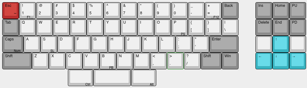

EDIT to add: I tried spring-swapping with a GTMX mid-height black, which had an uncompressed length of 12mm. It did work, but travel was noticeably reduced. Going to think on it a little more and try to decide if sourcing and swapping springs is a project I want to handle, if I just want to do a build with them being a little light, or if I return them. If I do a build, I am thinking of something like this on a PCB I already have. Would just need to do double-switch stabilization on the central spacebar:
No-stabs TKL-like
