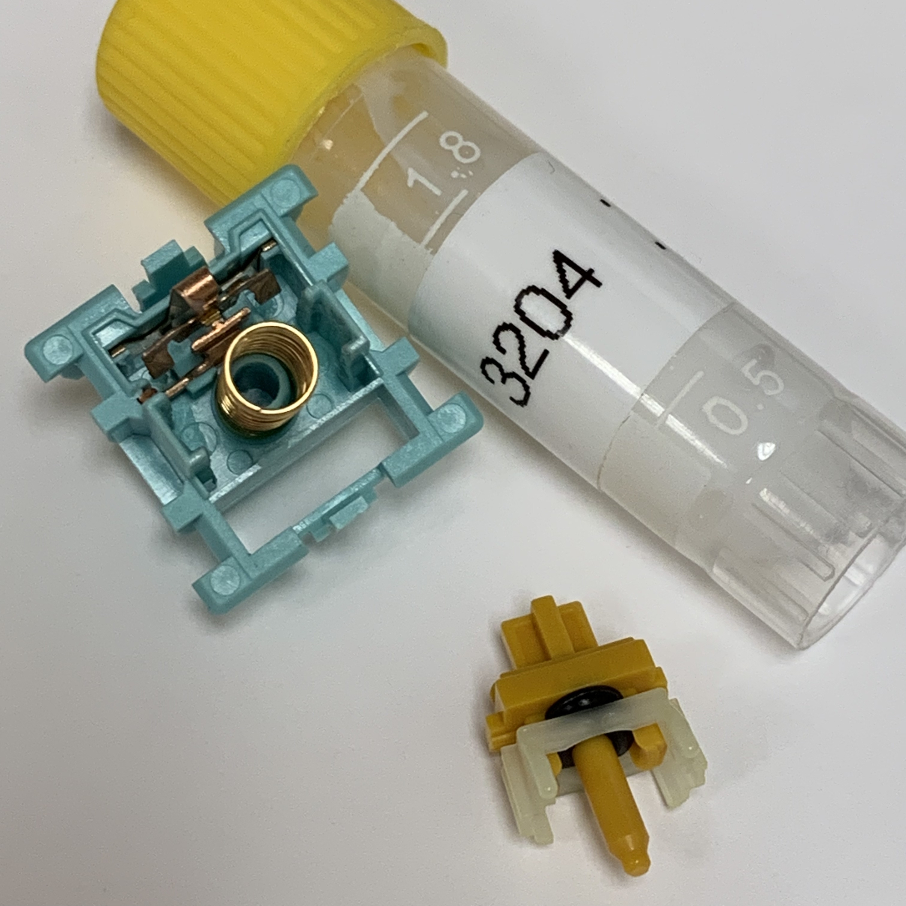

Recipe:
  • Kailh Speed Gold Stem (jailhouse mod with o-ring)
  • Outemu Sky (teal) Housing
  • 45g Gold Spring (or whatever spring you like)
  • Krytox 3204 Equivalent
Description:
45g Gold Spring

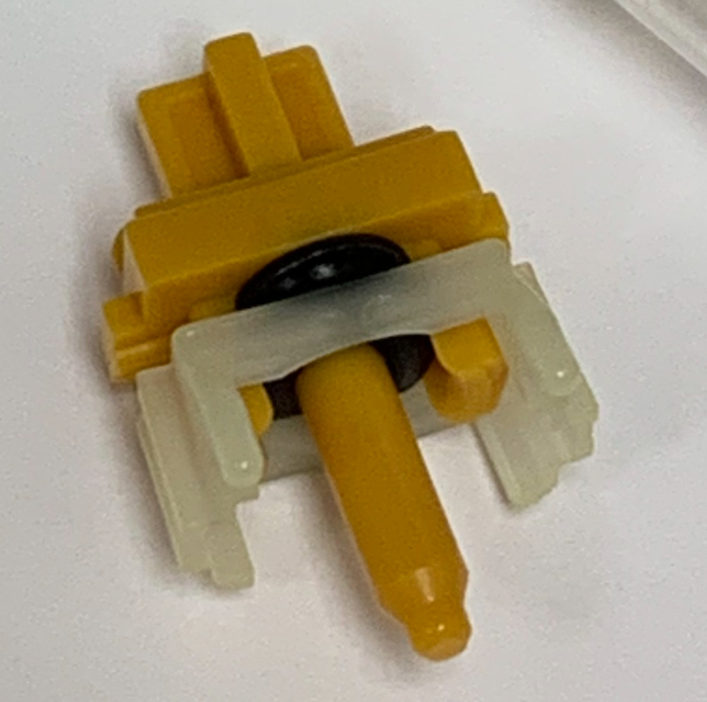

Small Black O-ring Inside Kailh Speed Gold Stem

What o-rings did you use?
Pretty sure it was these:
They come in pack of 1,000 and are actually oversize for the jailhouse mod.
I basically wedge them into the stem with tweezers and the stem clicky part will clip in place and squish down the o-ring. They do flex the plastic on the clicky part of the stem very slightly, but I’ve never had problems using them.
You can tell where it’s squished in the picture below, it barely extends past the switch stem - which hasn’t been a problem with switch fit so far for me.
You can also buy J-spacers from The Van Keyboards.
The J-spacers are specifically for jailhouse mods and are shaped perfectly for fitting around a clicky stem. If you’re needing to buy something already, the J-spacers would be great, I still have nearly 1,000 o-rings to use up though. :joy:

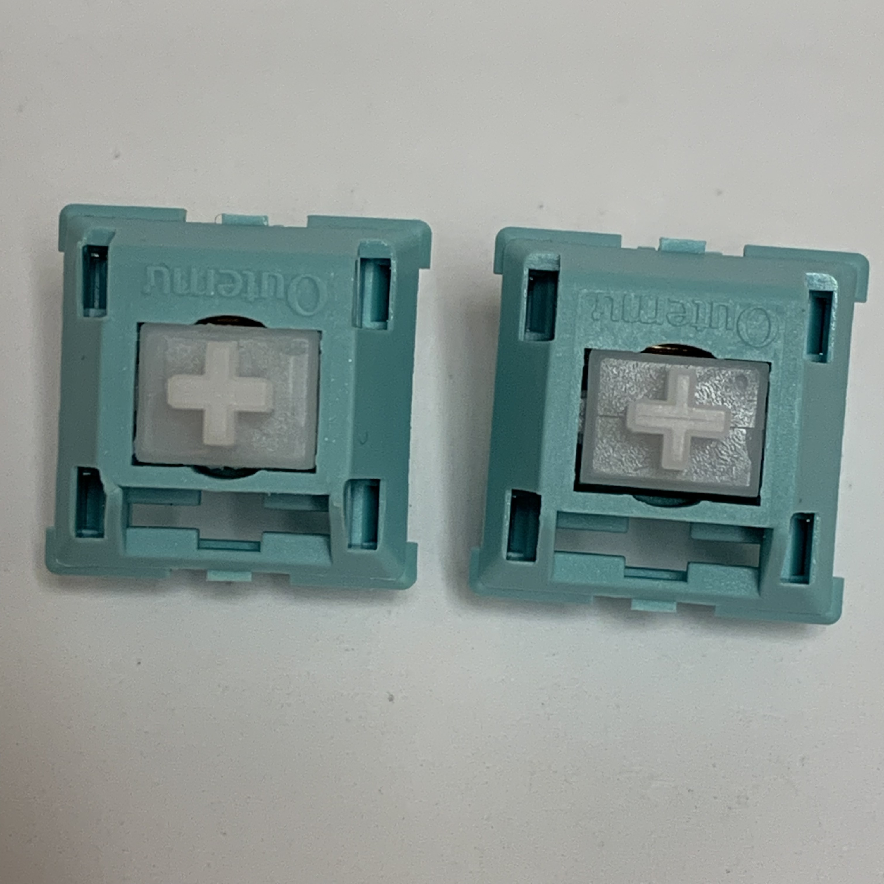

Aren’t the Sky stems basically the exact same as Cherry Clears?
They’re close. I think Sky stems have more tolerance within the switch body and the stem cylinder is tapered more.
Cherry Clear mod is on the left and stock Sky is on the right.
If you’ll PM me an address I’ll send you this Cherry Clear Sky switch to try out. It’s a Cherry Clear stem and spring and Sky housing with 3204 lubricant.

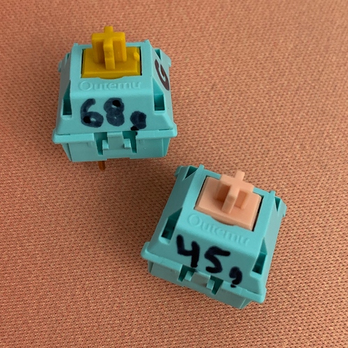

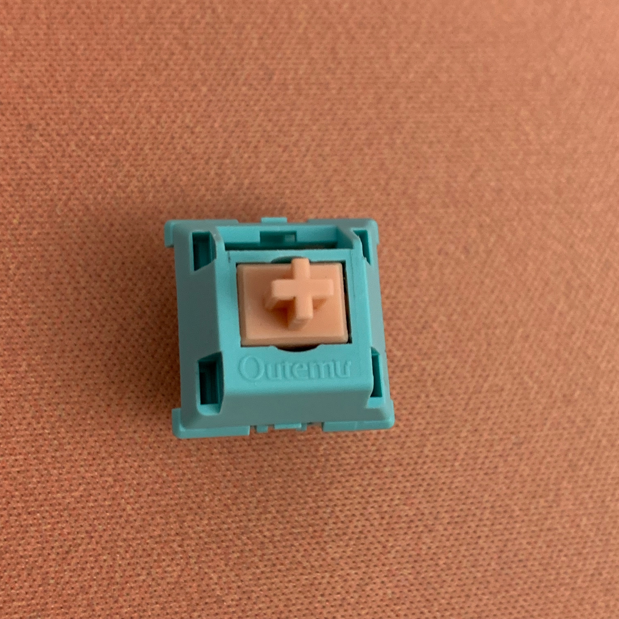

Heavenly Sky Switch (? catchy enough name ?)
Halo True Stem and Outemu Sky Teal Housing, 68g Spring, and 3204 Krytox Equivalent
Sunny Sky Switch (Clicky Version, 68g Spring and Kailh Speed Gold Stem, Silicone Teflon Lubricant)
Heavenly Sky Switch (45g Lighter Spring)
I think the Sunny Sky Switch may work better with a regular Kailh Speed Gold Stem leaving it as a clicky switch. It has a nice feel with a 68g spring.
Also, I got some Halo Trues finally (arrived today) so there’s a 45g and 68g I decided to try out with the Outemu housings.
