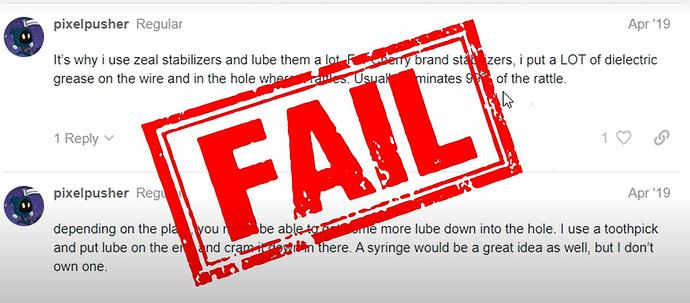

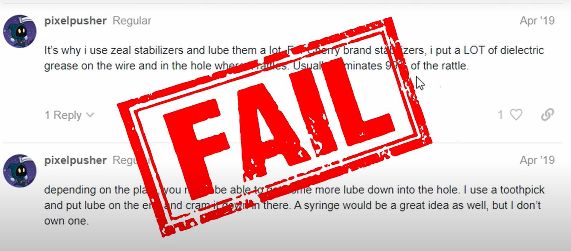

Don’t worry we still love ya bud! Seriously though I am glad people are finding ways to make their stabs sound the way they want without ticking. Although I do not understand what some other people are doing when they lube their stabs in the first place. I’ve been at this hobby for almost 6 years now & never had any issues with just lubing my stabs & refreshing them every so often.
Got my Noxary 268.2 back from my wife the other day. Haven’t used it since I built it several months ago, but she’s been using it as a daily driver all that time. It had developed a small tick on the right side of the space bar. I used a syringe to add lube (dielectric grease) in the stabilizer hole and some where the bar clips into the stabilizer. Pressed the space bar 10-12 times and now it’s quiet. I suppose the benefit of foam would be that it’s a more permanent solution.
