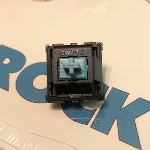

Can’t remember if you said; have you tried T1s?
They come in a bunch of flavors but they’re all tactiles made by JWK around (more or less) the same stem. Most versions have 4mm travel and a strong bump that starts at the top; like this JWICK one I got a sample of today:
SwitchOddities sells these one at a time, and tons of vendors sell some flavor of T1 in packs.
