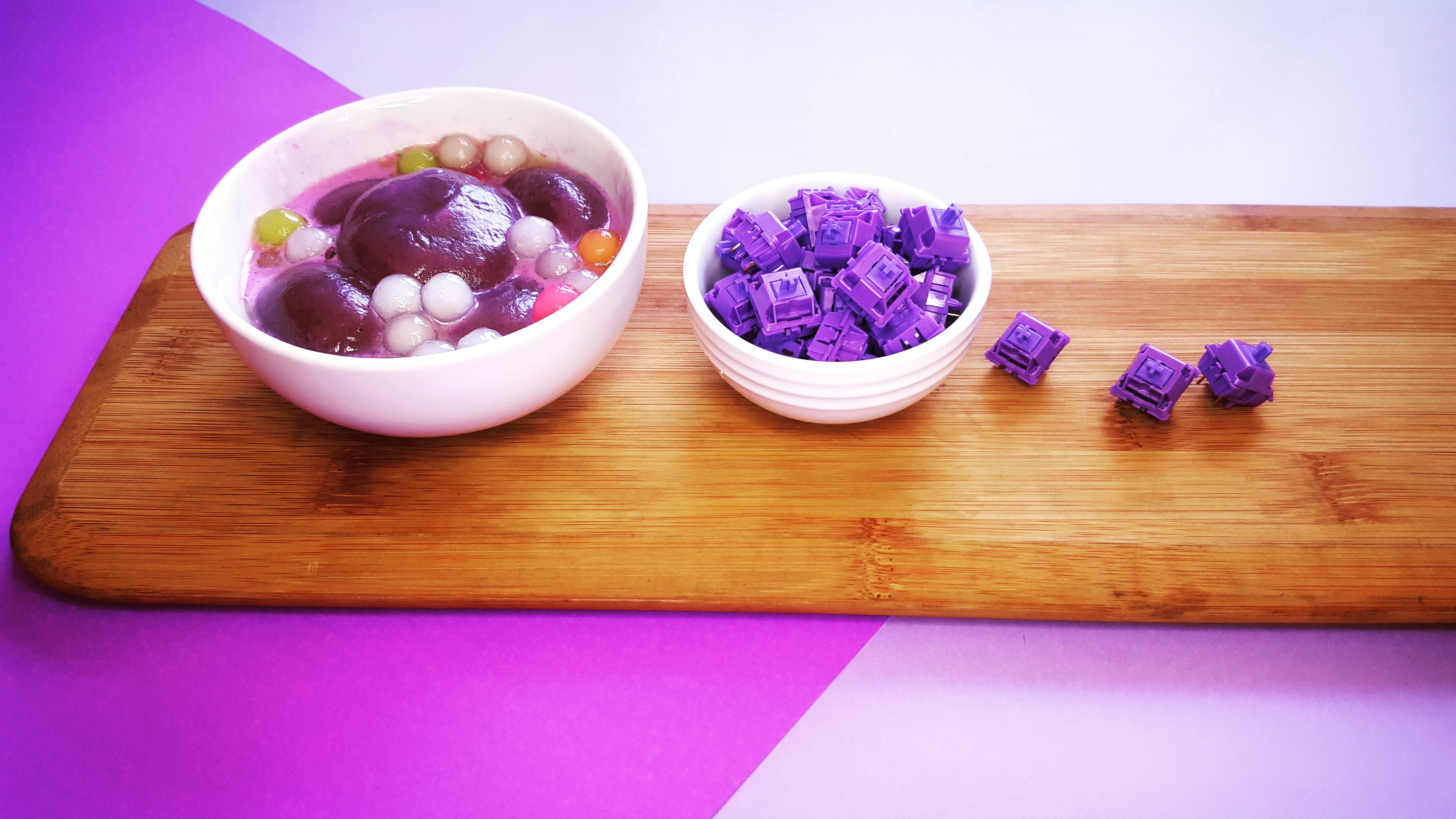

Pretty nice medium tactile switch. It reminds me somewhat of a kailh pro purple but with a better sound signature. It has a little, tiny pretravel like zealios v1. I think anyone who likes a moderate tactile would be happy with this switch. It’s a bit more tactile than cherry clear. But nothing as jarring as a holy panda or zeal v2.

These are, I think, probably the cutest Rara variant
Supposedly mimics MX Clear stem in T1 housing. Mild, rounded tactility (it feels rounder than Ergo Clear). A bit scratchy, probably because no factory lubing (which is uncommon nowadays). Slightly muted bottom out (even more muted return), low pitched bottom out. Did not experience binding although the switches feel very light when pressing.

Apparently, it is not necessarily a T1 leaf. Could just be a regular Durock Medium Tactile leaf [if there is such a thing] in the housing:
"Yeah after doing some testing with Oreo and koala switches it seems like the taros leaf is definitely different than regular t1 leafs (less tactile). Unfortunately cannon keys could not provide more information, but i did update with all the info I got in the comment section of the video! I wish switch distributors were more forthcoming with switch specs but it seems like most of the time we are left to figure it out on our own.
Testing: the taro as a whole is actually quite tactile, just with a more p-shaped bump thanks to its stem. However, putting a Oreo (t1) stem into the taro housing produced a much more subtle tactile feel than the Oreo on its own, which means that the taro leaf is definitely more on the medium-to-light tactility scale vs t1, and therefor a different leaf altogether. When I made the video cannon keys emailed me back saying they “thought it was probably a t1 leaf” so I imagined they would know better than me lol.
I’ve made sure to have extra switches lying around for future videos if direct comparisons are needed so I won’t need to rely on memory or distributor assumptions in the future, cause that obviously doesn’t work well."

They’re both the same “type” of switch in JWK’s offerings—a medium tactile consisting of their sharper tactile stem with pretravel and a lighter leaf to reduce/round out the tactility—but the FFFF tactiles are marketed as having a nylon top (rather than the standard PC-top the Taro Balls are marketed as having).
In practice the difference in sound between them seems minimal at best (which could just have to do with the specific switches I have), so I think that if you like the sound & feel of the FFFF tactiles you’ll probably also like the sound & feel of the Taro Balls.
Another option in this type would be the Durock Medium Tactile, which features a clear housing and purple stem if you want something a little LED-friendlier (not sure if that matters for your build).
