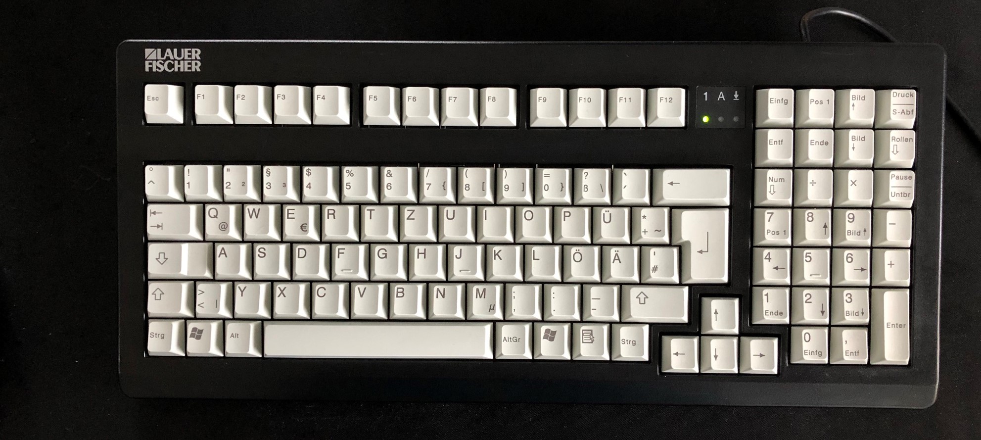

Only downside was that out of all the 1800’s I got my hands on, all of them had the Lauer-Fischer logo scratched, while my black boards, have it untouched (visible on the 3rd photo).

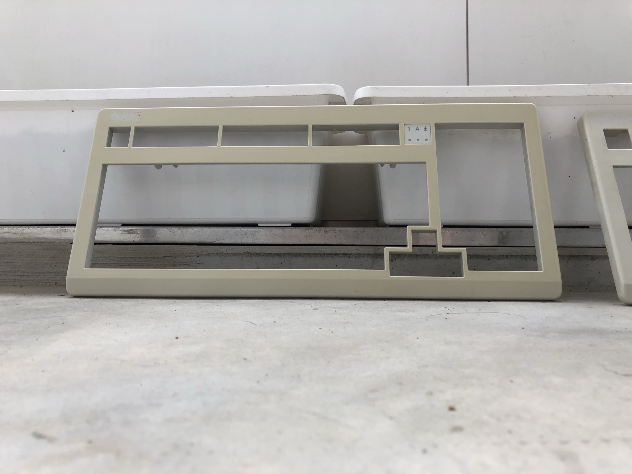

1 - This is the oldest board out of all 4 I have with me. Unsurprisingly, the top left logo removal operation seemed to have been done on a dificult day. Besides that scratching (or carving?) the color isn’t that bad, when compared to this one:

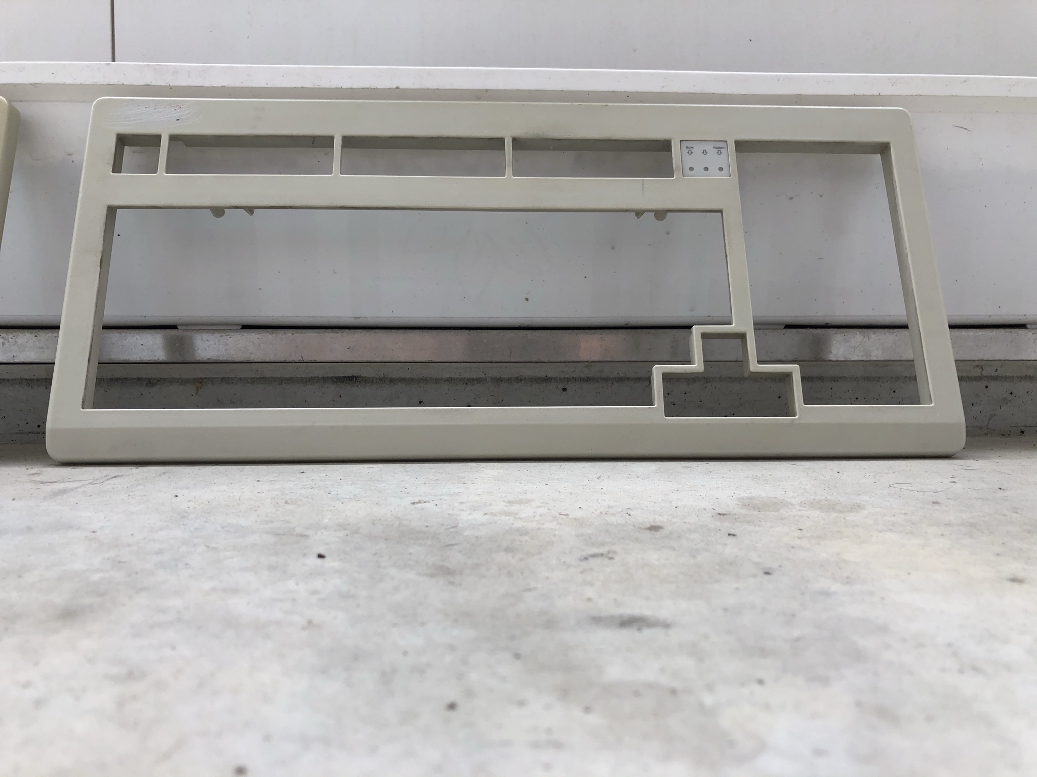

2- You can see that the logo removal operation was done on a way more zen mode, yet, board seems way darker when compared with the previous.
With this one, I tried some cleaning sinking it on warm water and denture tablets for about 5 hours, took it out, cleaned, and didn’t notice any change on tone.
3- Regarding keycaps, same method as before was used, I considered the end result quite good as it can be seen before on a black 1800.

Awesome boards to restore! I just picked up a Cherry G80-3949 with the plans of putting a QMK replacement PCB I have for G80-1XXX/3XXX boards, unfortunately Cherry changed the modern G80-3XXX cases & the PCB was not compatible. So I’m just gonna mod up the switches & stabs in it since it thankfully had surprisingly smooth silent blacks in it!
Anyways some tips for your restorations. The cases that had the top left branding scraped off are good candidates for a sand, prime, & paint job to cover up the scuff. Also look into retrobrighting for de-yellowing cases, it is very effective bringing the whites back out of yellowed ABS. Then the 2 things you could do to get ANSI layout on those boards like you want want it. Is to buy a G80-1800 with ANSI layout & just transplanting the plate/PCB assemblies between the two. Alternatively TKC offers QMK compatible PCBs for G80-1800 cases every once in a while since the TKC 1800 was their flagship product back in the day.
Honestly though it looks you did a damn fine job working with what you had to restore the black board! If you need any other advice restoring vintage keebs feel free to PM me on here. I’m not gonna claim I’m some vintage guru, but I do have a good bit of experience restoring vintage or OEM boards. So I should be able to help you out with the processes & procuring parts if you need help there. Anyways everything you’ve shown here looks pretty good & we’re always glad to have more people who are truly into all facets of the hobby here! Keep up the good work & GL with with projects man! :metal:
