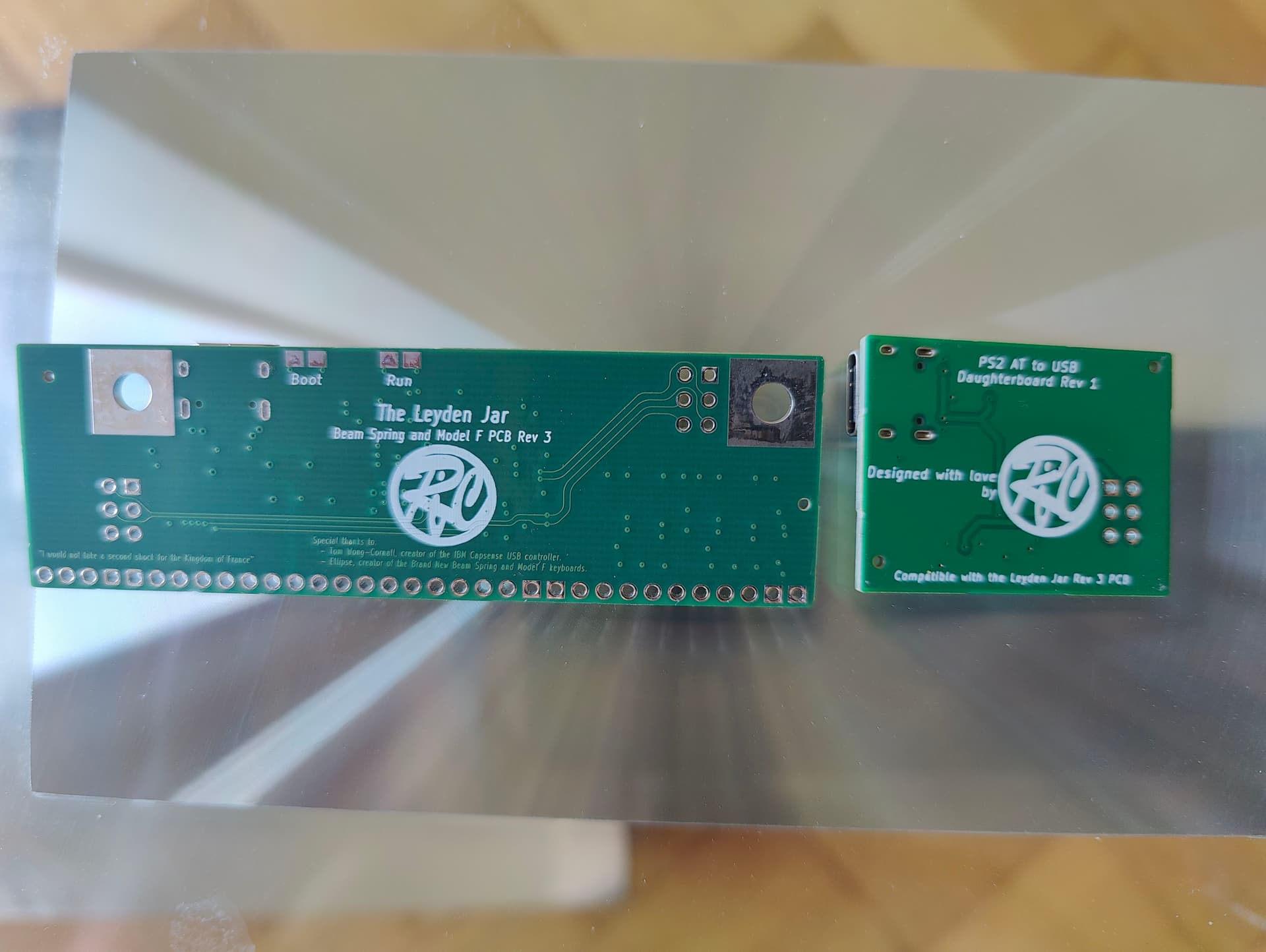

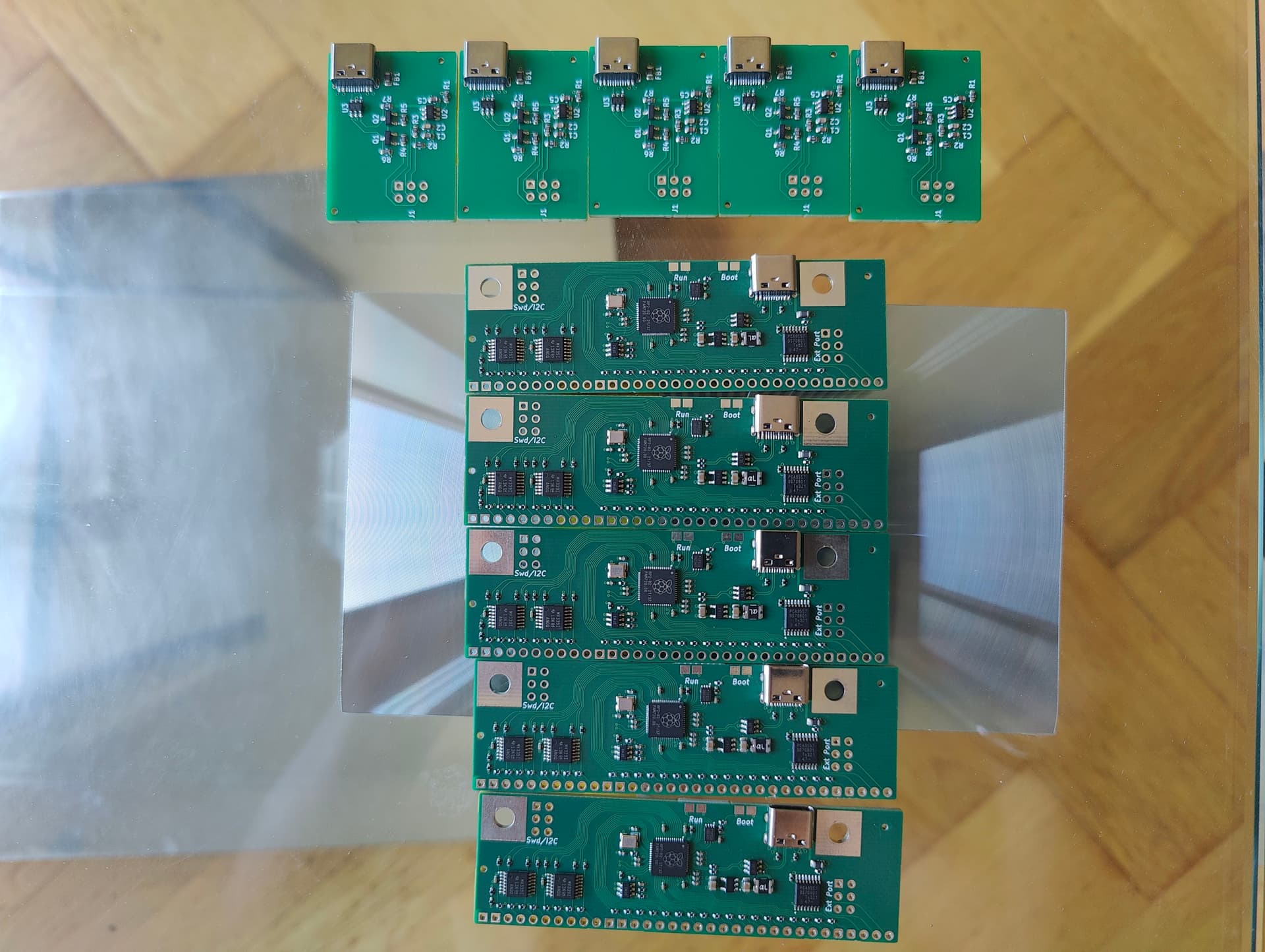

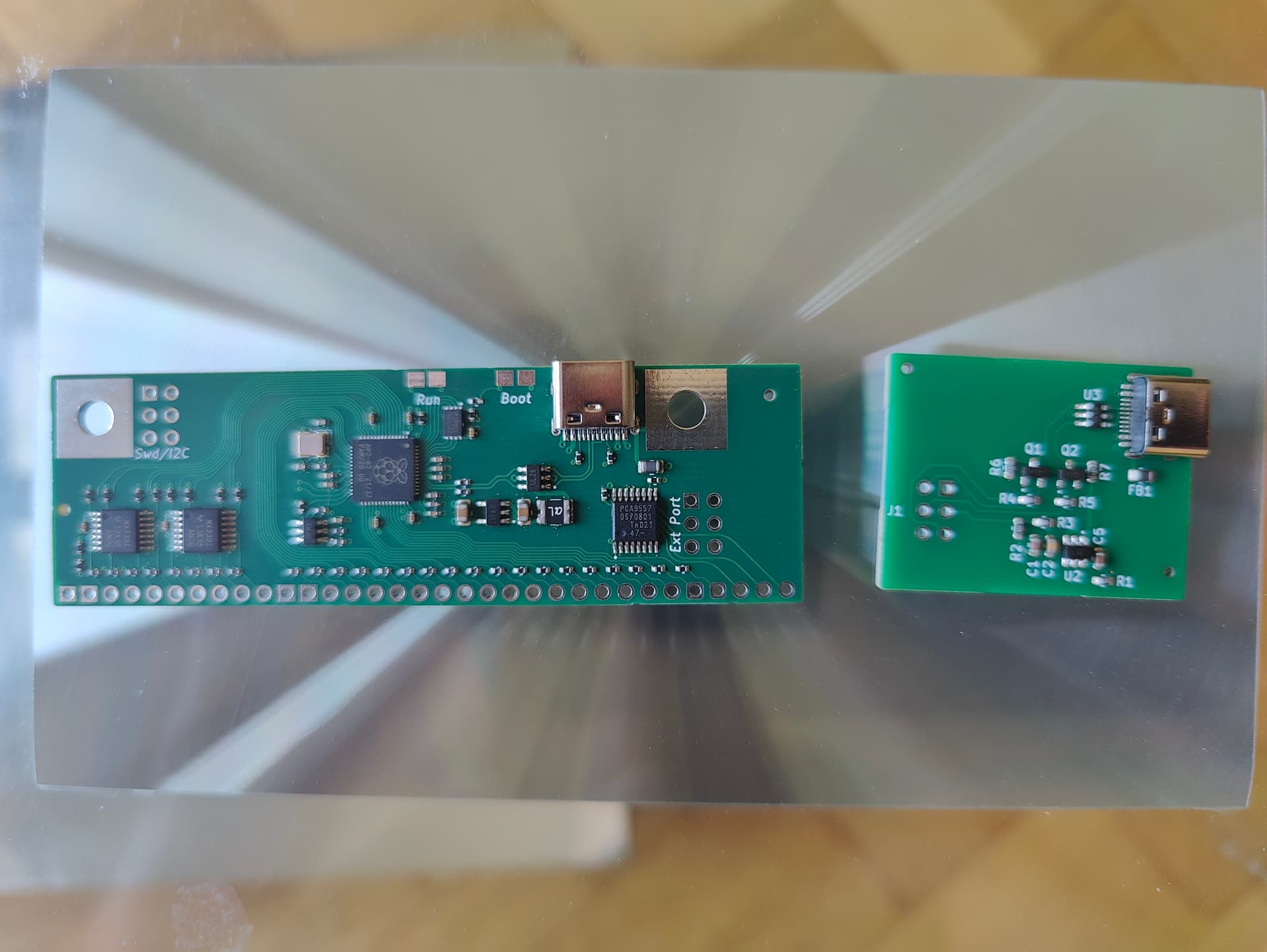

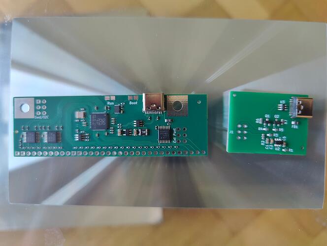

I just received the Rev3 Leyden Jar PCBs from JLCPCB, and also PS2 AT to USB daughterboards.
I’ll have to find time to solder this new controller to my F77 in order to check that everything works and tune the firmware code.

Hello @DrYak,
The Leyden Jar controller is pin compatible with the currently used XWhatsit controller.
So in theory it can manage every Model F keyboards that @Ellipse is selling.
In practice, all keyboards are different and a specific firmware has to be developed. The most technical parts are generic though, adding support to a new keyboard could be possible by anyone versed in programming and QMK firmware.
As for the PS2 dautherboard, I unfortunately didn’t had time to test it yet. This will for sure require a significant amount of programming work.
The plan is (to be confirmed it works) to either plug the keyboard using USB and have access to VIAL configuration tool, or use PS2 connection on the daughter board and be able to use the keyboard on an old computer. Of course with the same QMK firmware.
