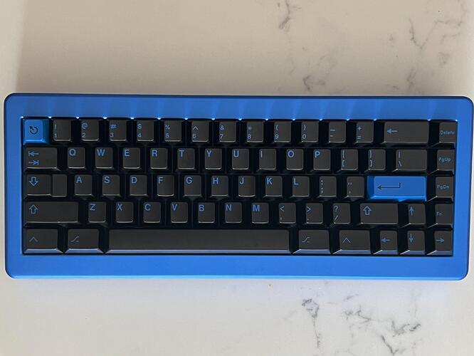

Rico I still am unsure why you have undertaken this project… seemingly without a m65 of your own.
But I am extremely thankful for it that’s for damn sure!
Thank you, it is just to help people like you;)
Aside from that I don’t indent the hassle of making a regular big GB (too much effort for an individual).
But other people will be free to do so with the files ![]()
I’ll still have a few to sell anyway: 4 hotswap PCBs and full plates will be available.
And I may even make a few Rev 2 solder versions for you people ![]()
Hot damn that Hydro blue! Love the board and thanks a ton @Rico would love to grab some PCBs either from yourself or with the files ![]()
