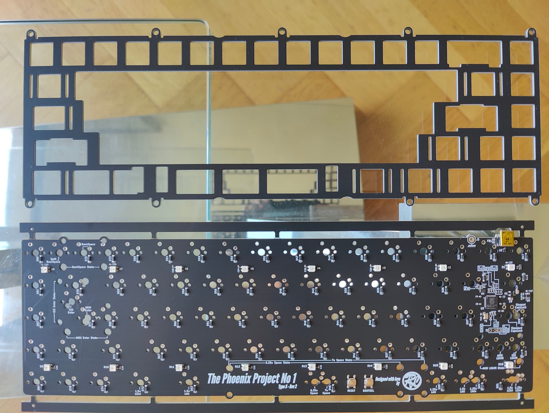

Just received the assembled Phoenix Project No 1 Type S PCBs and the FR4 half plate, 5 of each.
Need to test if everything works as intended now.
A bit of news about the Type S PCBs.
They are all working great, but I had to make some small surgery on them to fix a weird issue.
This was very strange as previously ordered Type H were running without any issue.
When I ordered the Type S, the fuse I had inially selected in my design was out of stock, so I picked another reference that I supposed would fit nicely … and it happened that it was not the case: I had totally unstable LED backlight.
It also killed a few LEDs in the process ![]()
So I did replaced fuses with a beefy one and also replaced the fews LEDs that took a hit due to the bad fuses used. It is very easy to do with a hot air soldering station ![]()
Now all 5 PCBs are running as they should and pases the RGB LED tests !
And for people wanting to order the PCBs themselves, as long as you stick with the component references that I listed in the BOM, they should work fine with and with the correct fuse reference.

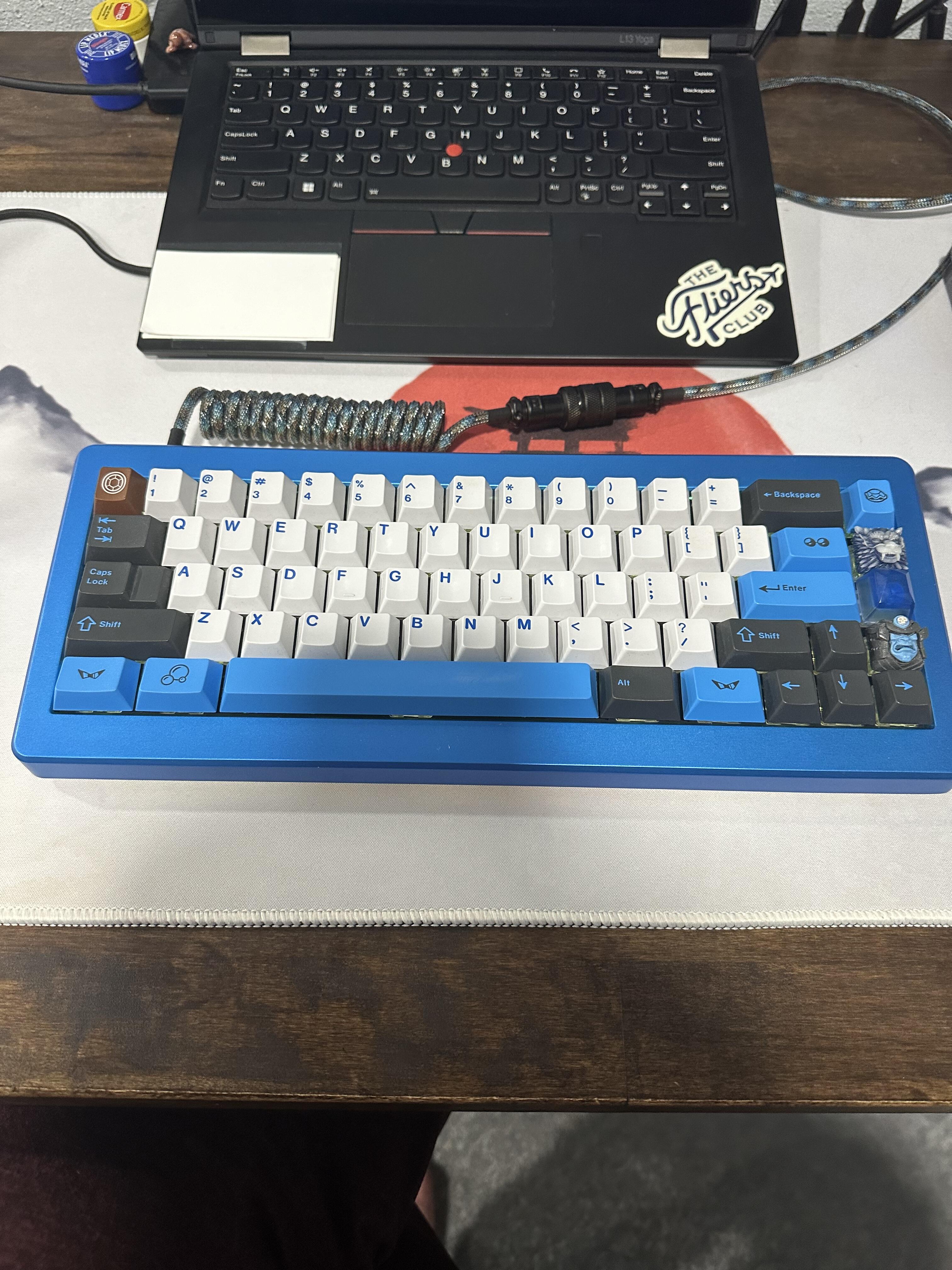

Forever grateful to for this board being revived. Was my first “grail” level board and the resurrection with upgrades is better than ever.
I’m not a photographer so sorry for the potato quality. Somehow still get bad pictures weird phones these days
Happy you posted it, nice to see it work again!
