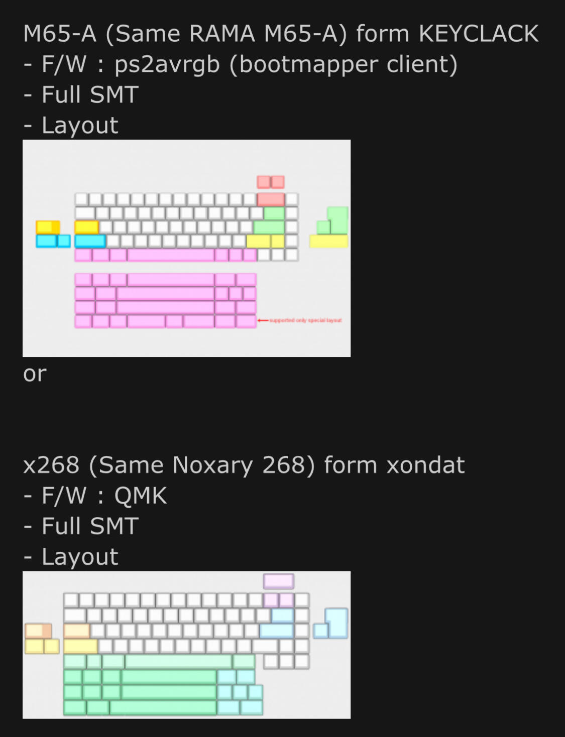

The m65-a, clsms, and 268 all share the same PCB footprint but that’s partially from the fact that they all have multiple options for the bottom row.
From LZ’s post about the clsms
So it won’t work with the 268 because there’s no 6.25 space bar with 1.25 modifier options.
But it will work with the LZ board. Again, that one already has a large cutout, so there are other options for usb-c replacement if someone needed.

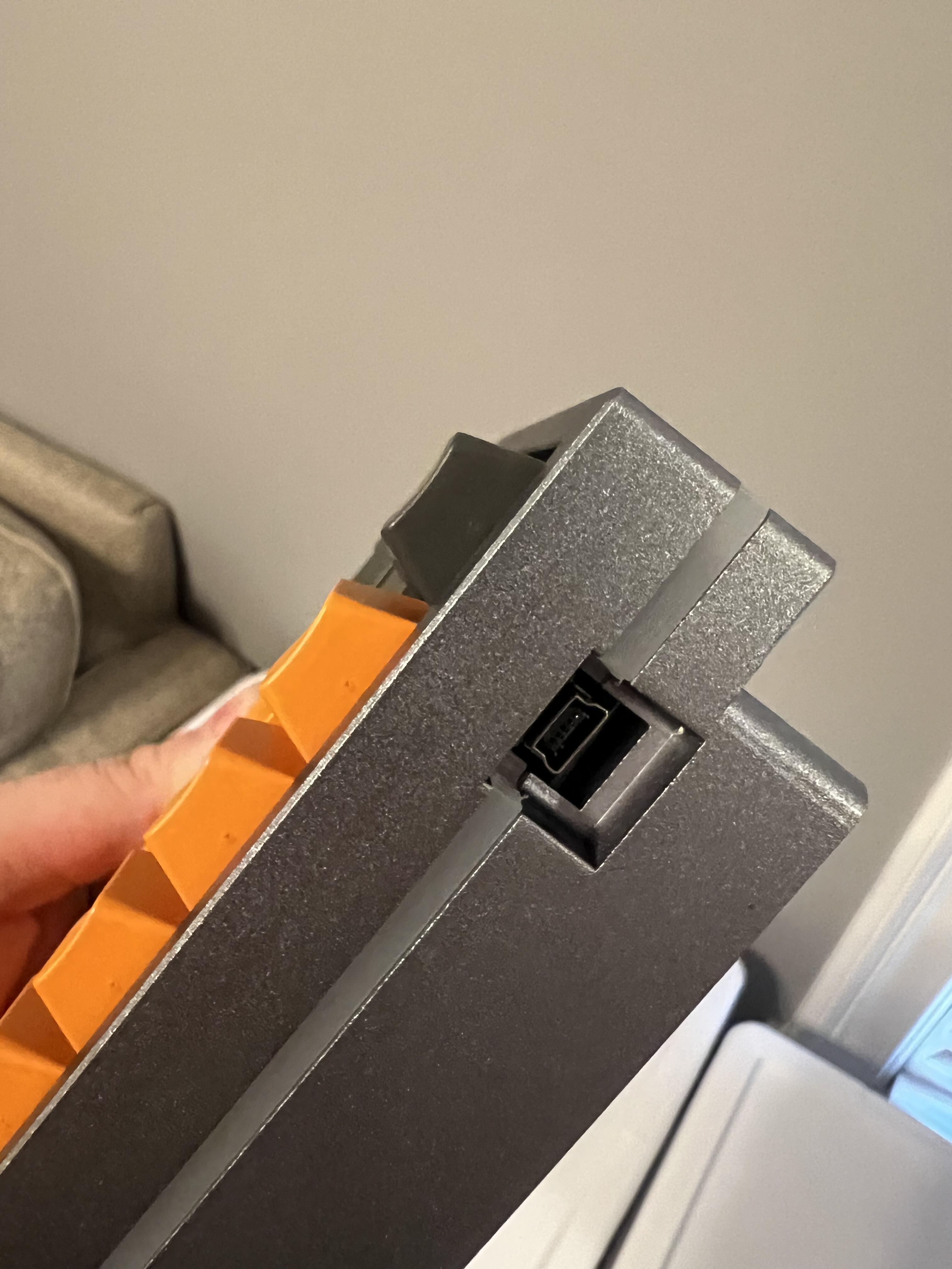

There have to be people in need at some point for a 268 PCB replacement that won’t want to dremel the case. It’s usb mini and Noxary is gone.

So there are probably only 22 in existence. 268.2 switched to usb-C

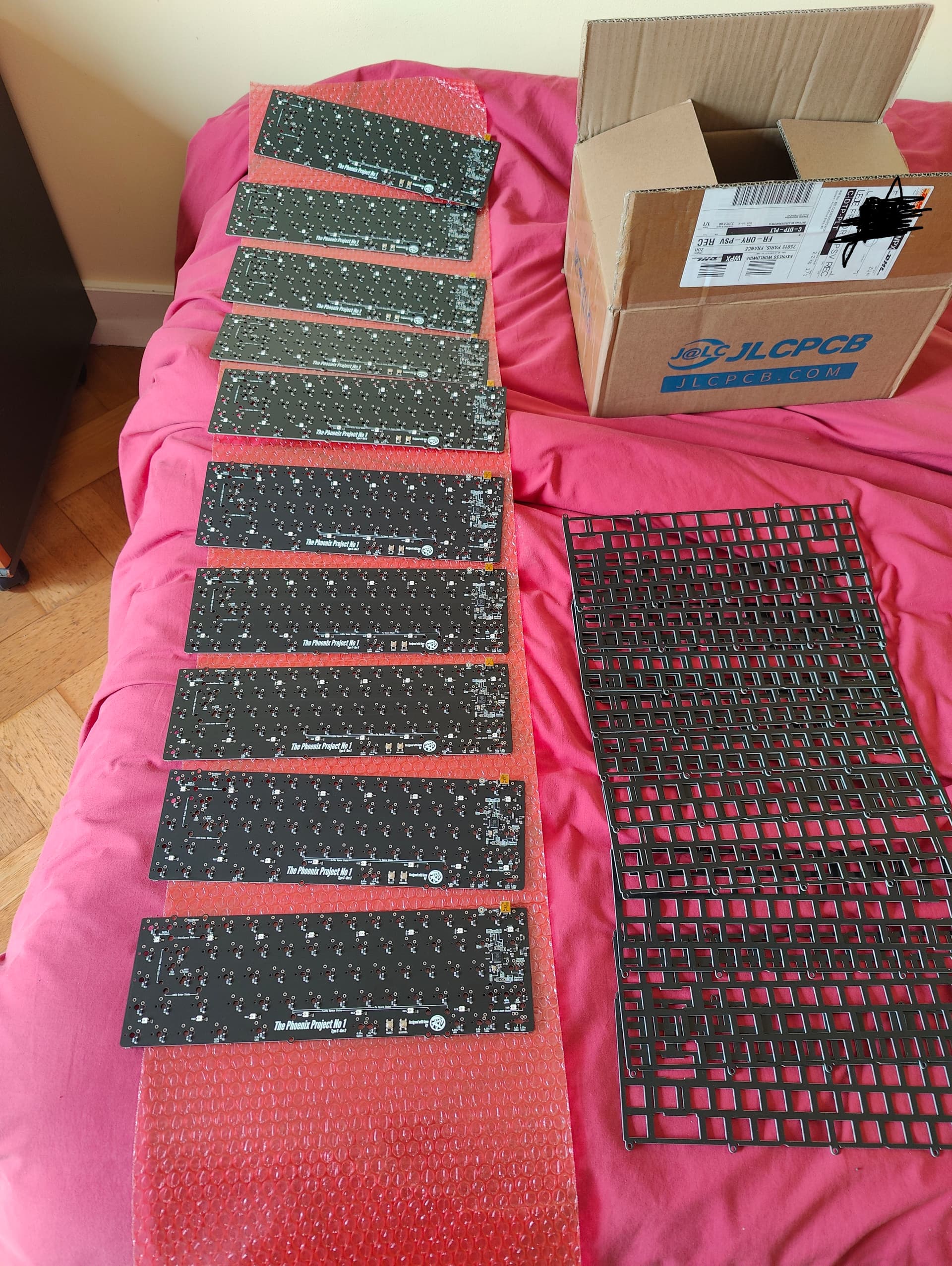

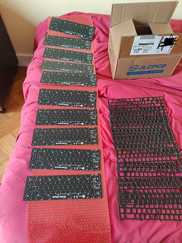

Hello all,

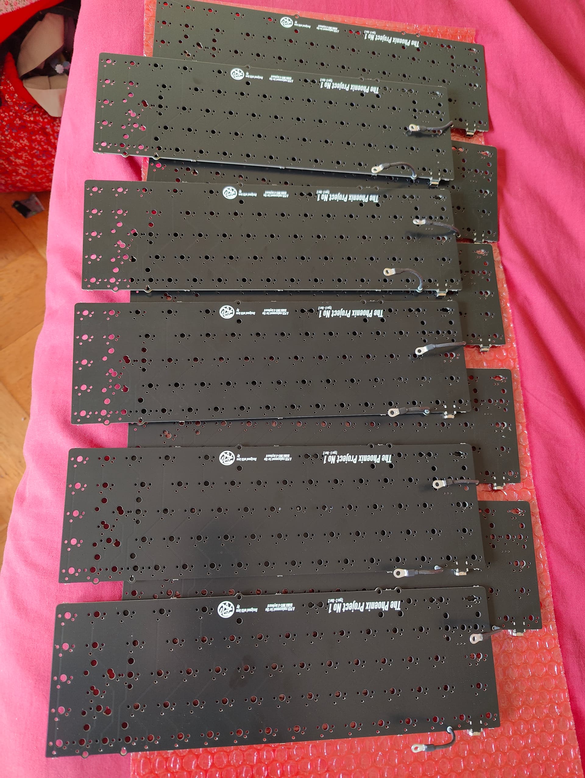

Just a quick message to tell you that I received the 10 Phoenix Project No 1 Type S PCBs (solder variant) and the 10 FR4 full plates!
From a bird eye view everything looks ok, but will of course take time to fully test all of them to be sure.
The white silkscreen looks significantly better than on the previous versions I received: it looks like JLCPCB improved the sharpness of the silkscreen when black soldermask is used.
Another improvement (and new service) is the component baking service, a process to heat components at moderate temperature for several hours to remove moisture.
For example WS2812 leds are known to be very sensitive to moisture and could break during the reflow process. They contacted me, asking if I’d want to bake those components before soldering them (for extra cash of course) witch I accepted.
It is nice to see when a company is constantly improving over time, witch is the case for JLCPCB.

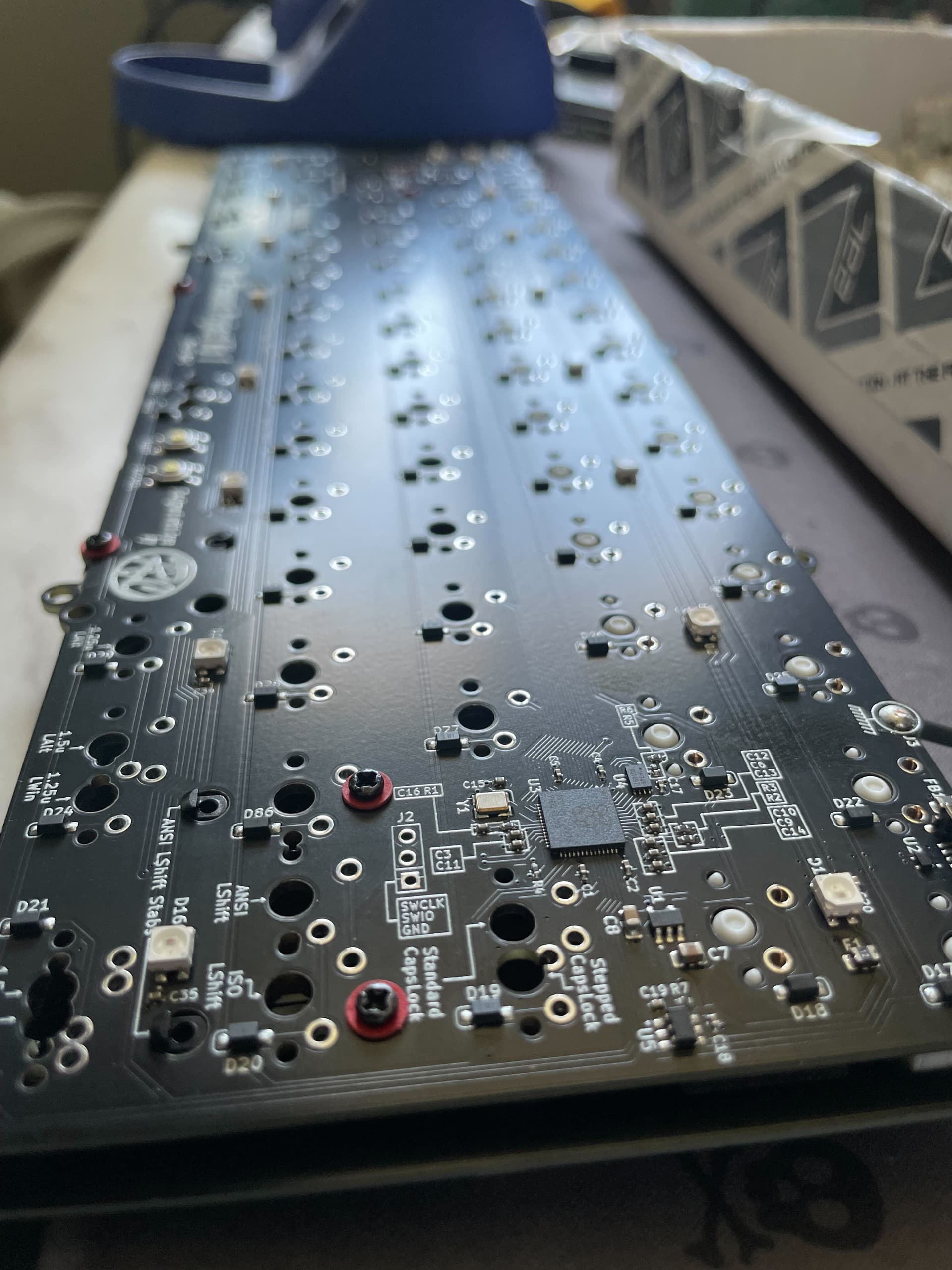

I just returned from holidays and could find time to test all 10 Phoenix Project No 1 Type S PCBs.
They all work just fine, all flashed with official VIA firmware, all RGB leds working and the key matrix fully tested.
Next step is to solder the ESD cable on them.
All ESD cables are soldered !

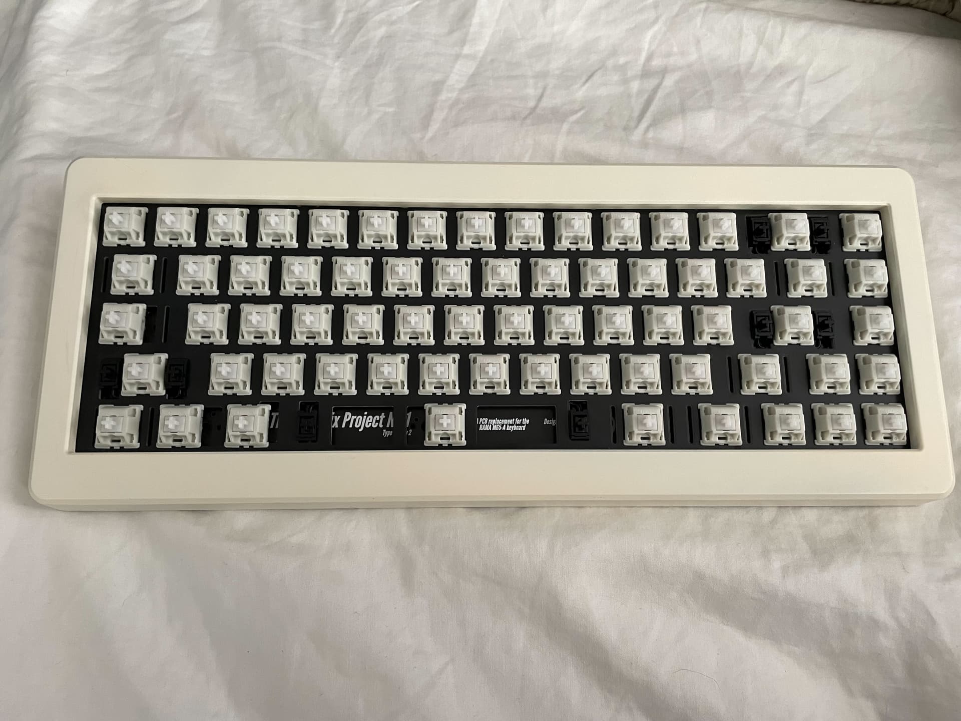

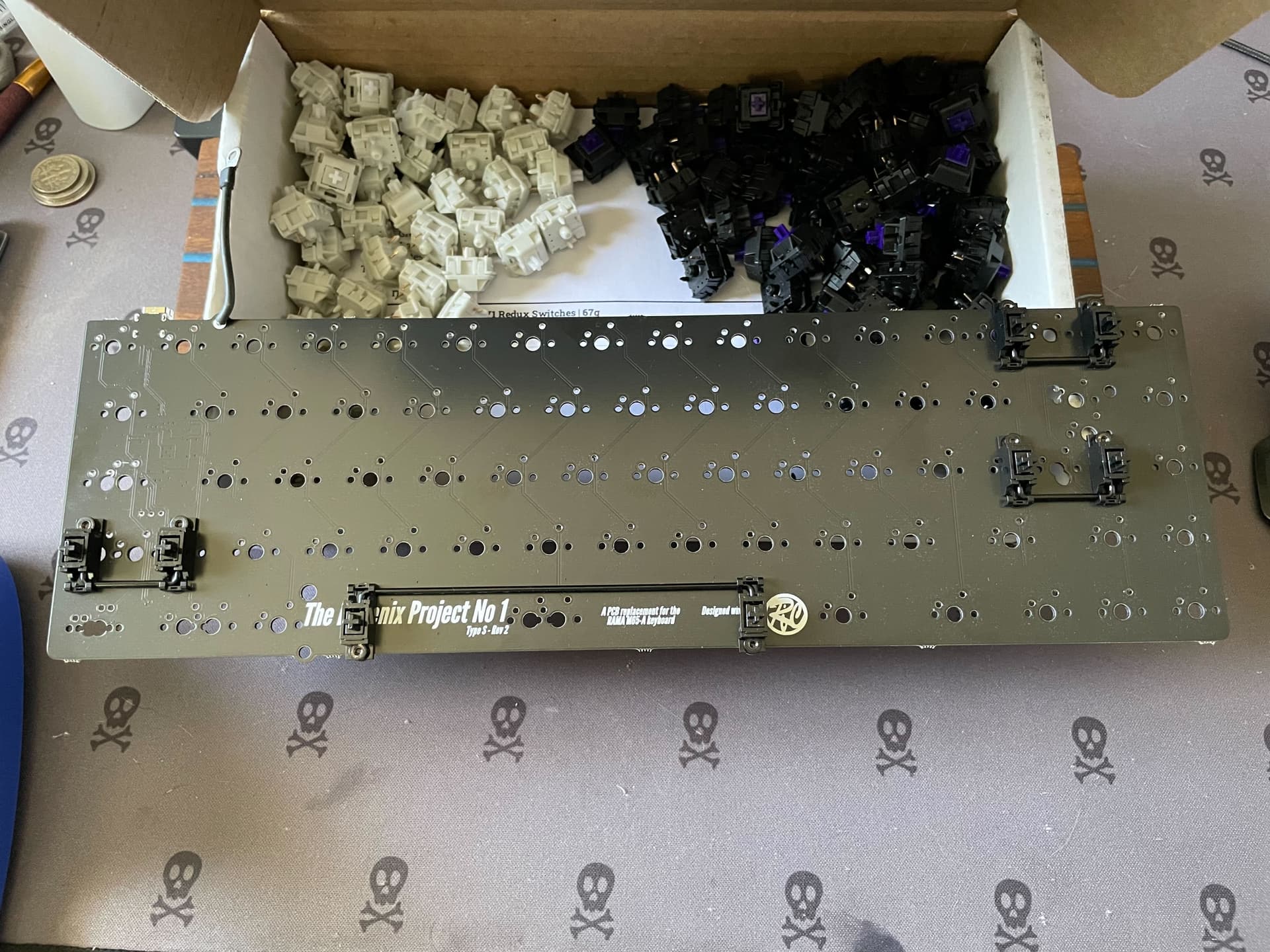

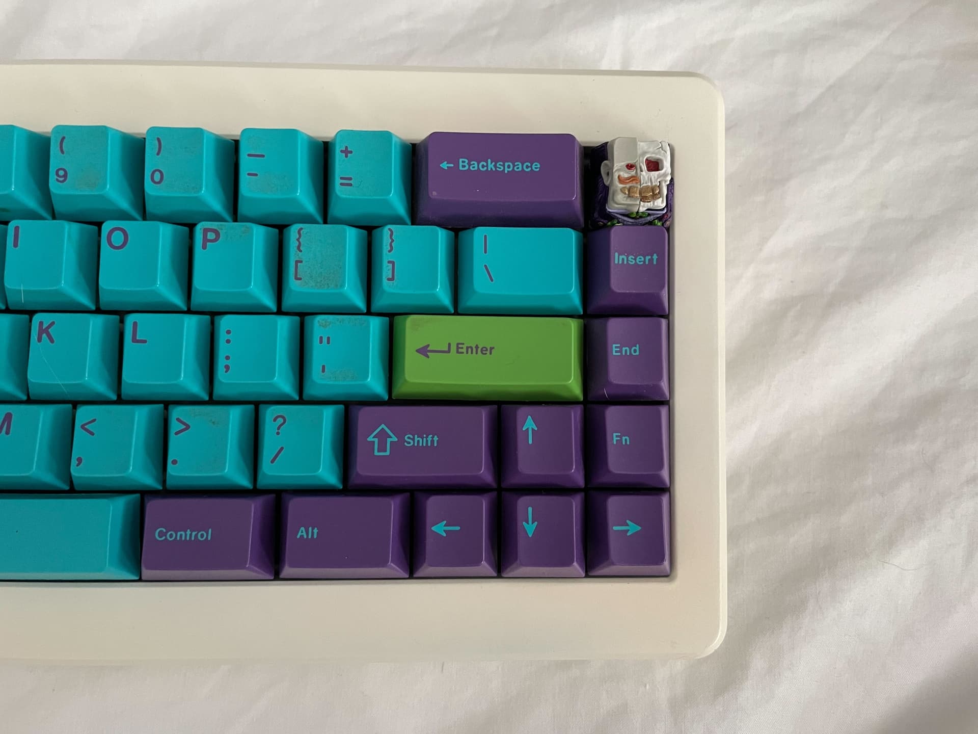

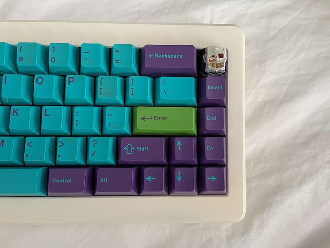

I’ve spent the last couple weeks prepping some new switches, and now I have one of the two PCBs up and running. I ended doing a stem swap between some V1 zealios and cherry clears. the new cherry body/zeal stems feels a bit mushy, but the opposite is so nice.
Anyways, thank you Rico for doing this run. Its nice to have a PCB with working LEDs again lol. The grounding wire is super nice, but since my case has been covered with cerakote it doesn’t have the same issues as the original. Its nice to be sure nothing is going to happen.
I messed up the bottom left control and had to resolder that, but otherwise everything went smoothly. Using VIA was super easy as well. I’ll report back again once I get the other pcb set up.
