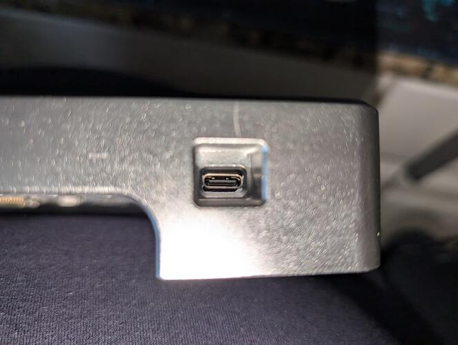

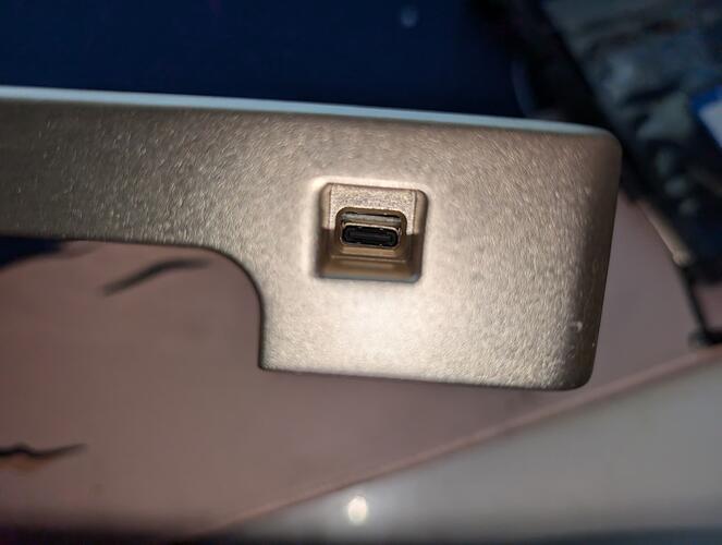

Not to be that person, but it looks like I found a PCB that will work with the original Aluminum plates, but not the new ones here. (See pics).
The Polarity Works BT65 which is a ZMK board that supports underglow and battery. There is a Vial-like configurator coming soon for ZMK, but that won’t be for another month or so.
The BT65 board isn’t very available and the fit is TIGHT (see) but centered as it supports older boards like the TADA68 of which our PCB’s were based on.
This is such a run of luck and the spacing allows for some rubber gaskets. Sadly though, it doesn’t support dual 1.5u bottom row on the right. :face_exhaling:
Still, for those who need something that “might just work”, this is an option.
Now, I just need to design a replacement bottom to have two! Also, my kids were super awesome today and dropped my Space Gray top from my desk to the tile below, denting my top corners. 7 years of no significant damage and it took 10min of something being on my desk for my kids to wreck it. Gotta love toddlers!
Fit check with BT65 and OG alu plate.
This also allows for an encoder.
When I say tight, I mean it. This is so tight you might question the fit.
