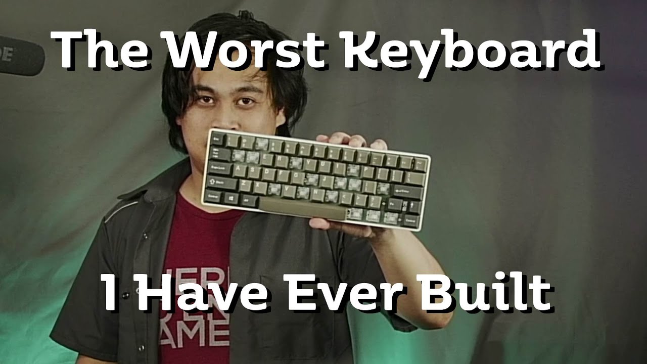

What’s the worst keyboard YOU can build?
Tbh I didn’t think it sounded that bad. Lol I have some early kailh blues that are nightmare inducing in feel and sound.
I love the keys falling off
Yeah the final swipe across the keys got me
Seeing all these keycaps falling made me laught hard
The keys flying off at the end, I’m dead
I bought that keyset
Ha. I had a cheap set of keycaps, too. Here’s what you do… build a cheap board but put love into it. Lube up the stabilizers. Put foam in the plastic case. Got caps that fall off? Put them on box switches to snug them up. Polish the turd. It will actually be a pretty nice keyboard. GIve it to a friend.

That was hilarious.
Just that sound alone communicates to me that isn’t a confidence-inspiring board. It sounds like the keys are bouncing up and down on the stems, which they probably are. Shudders noooo
