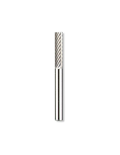

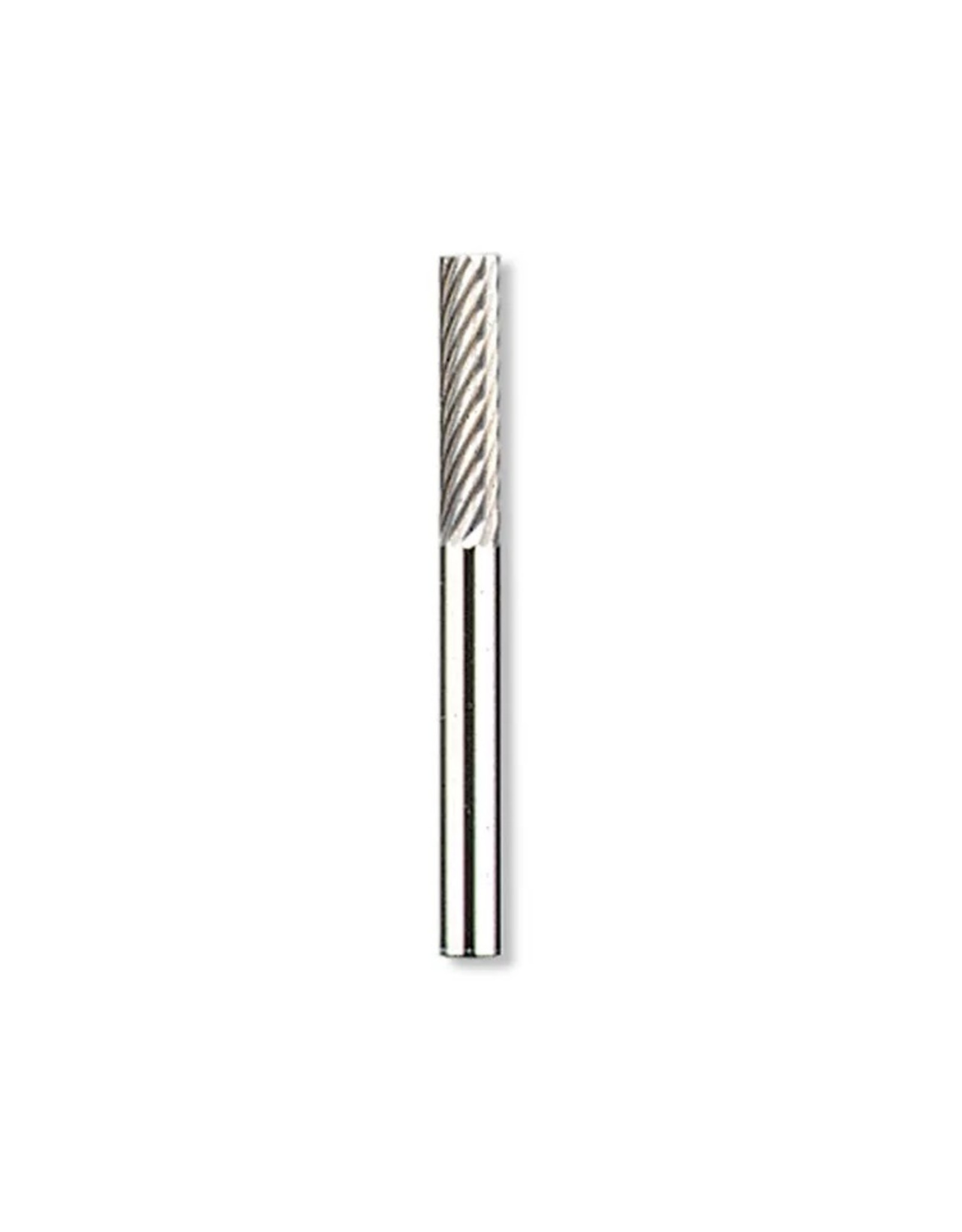

Dremel and plastic welder, might be your best option.
How I would do it.
  1. Cut out the stem from one of the switches, that you don’t use. Try to keep the key surface intact, so there is a hole only on one side of the stem. Note: you could also leave some of the keycap surface as a flange, to increase the bonding surface area.
  2. Use a carbide bit, to grind the twisted stem out of the N key.
  3. Use a hobby knife, to score the top of the donor stem and the inside of the keycap.
  4. Place the donor stem on the desired key switch.
  5. Clean with Isopropyl Alcohol
  6. Mix up a pea sized amount of plastic welder (Permetex, is my go to brand. I’ve used it on PlayStation 3 controllers and Sony Headphones, which I think are made of ABS, among other things.)
  7. Apply a small amount to the mating surface donor stem (Don’t want to over do it , because you could risk it leaking out and getting in the key switch, then the position the key cap on the donor stem. Note: The key cap will probably sit a little higher then normal.
  8. Remove the keycap, and shave the stem down, with the carbide bit or buy twisting it on a pice of sand paper, until the keycap sits at the same height as the other keycaps. Note: If the hole in the stem doesn’t go deep enough, you may need to surgically remove some of the material. A small diamond bit, drill bit, or carbide bit’s would probably do the trick.
Hope that helps.
