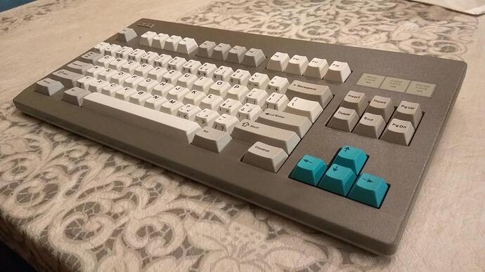

I’m looking for a thin custom cable for my NCR-80.
Bonus points if it’s affordable.
My stock NCR-80 cable keeps getting knotted up. So I’m looking for something that will retain its shape.
Thick cables are less desirable, since they take up more space. But a modest cable, say in beige + cream, about 1.5 - 2 m long would be fine.

The stock silvery-colour cable for the NCR-80 R1 is actually interesting. It feels like some kind of fabric/felt/woven nylon on the outside, and it’s about a half-CM thick. Pretty thin by custom keyboard standards.
Unlike many of the custom cords that are advertized as being tangle-resistant, the stock one gets knotted and tangled like a garden hose. It’s not coiled or springy like the ones that un-tangle on their own.
So I’m just looking for a reasonable 1.5-3m keyboard cable that doesn’t tangle. Since my NCR-80 uses beige + cream CRP, I thought it would also be good if the cable was beige, with cream ends/connectors, maybe the USB-A could be teal like the arrow-keys.
Yes, it would be a standard USB-A to USB-C cable. There’s no lighting on the board save for lock indicators.

IMO, you’d probably be fine with ye old cheap USB A-to-C cable. I emphasize the cheap b/c that will likely net a cable that isn’t as flexible and so less likely to entangle. Beige should be easy but the teal A end might have to be a DIY paint job.

I agree. A cheap solution should work.
I ordered a keyboard cable from AliExpress that sort of has the right colour. I think I might be able to combine it with another cheap cable, and it will match.
