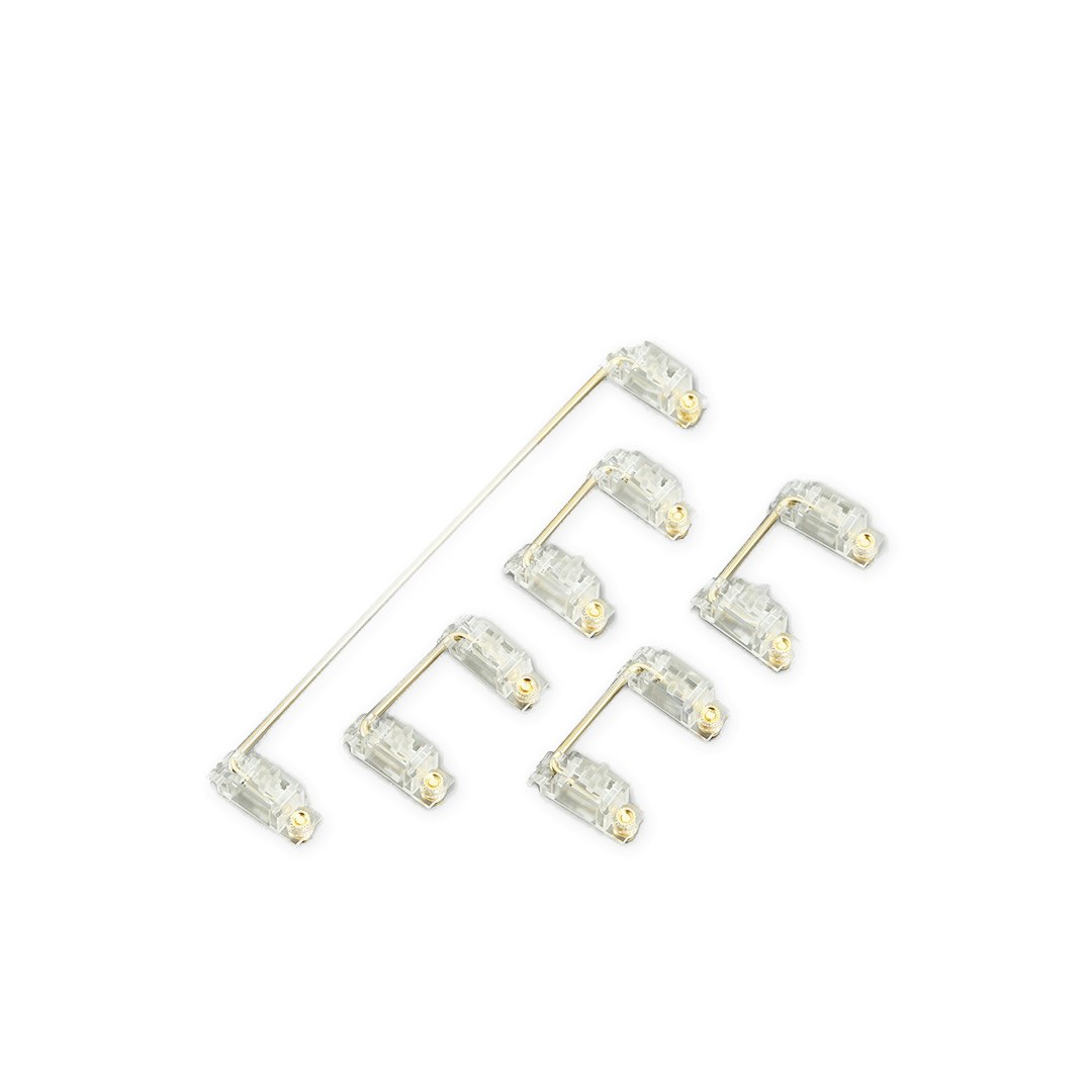

Zeal stabs on sale ~60% off - thatâs a big discount for a premium-marketed item. But hey! Zeal stabs for the price of reggo stabs, no complaints.
The original price feels way off for being V1 style stabilizers

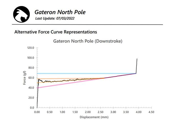

I concur, though I hadnât thought about it in those exact terms. I think I even have a visual that supports the ideaâŚ
When I reviewed the original switch, I noticed Theremingoatâs force-curve graph looked a lot more spiky than the switch felt to me - then I thought, hey, I might be looking at a visual representation of slip-stick.
Hereâs Theremingoatâs graph with some visual annotations I added:
Blue simply shows the bottom-out weight.
Orange is drawn from where the noise tapers-off, back across the peaks of the graph; this is a sort of âupper limitâ for the noise.
Yellow is drawn from the same point where the noise tapers-off, back across the valleys of the graph; this is a sort of âlower limitâ for the noise. The end of this line also represents where I think the switch starts moving under normal fast typing conditions as opposed to the slower speed of measurement; the device used for this graph operates by hand-crank and depresses more slowly than typing.
Pink is a straight line continued back from bottom-out through the same point where the noise tapers-off; this line happens to land on the factory-spec starting weight of the switch, 40g. I believe this is what the force-curve graph would look like if the switch were completely devoid of forces aside from those supplied by the spring.
I think whatâs between orange and yellow is the additive noise of the slip-stick effect, which I think might change with different measurement speed.
I think whatâs between yellow and pink is other resistance on-top of the spring; surface friction, oil viscosity, whatever it may be.
Where orange, yellow, and pink meet is where the spring force appears to completely overpower the other forces providing resistance.
The switch is supposed to start moving at 40g - but thatâs just the spring, and doesnât take into account other factors that happen to play a big role here. As measured (slowly), the switch doesnât actually start moving until nearly 60g before dipping back down into the 50s. I theorize that the practical starting weight of the switch with normal typing would be closer to 50g, which is still 10g heavier than the spring spec.
Thank for this extensive information, this confirms the feeling I had when typing on them !

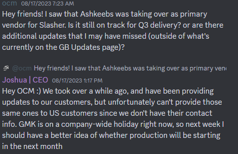

Just found this in Ashkeebs discord from the other day:
So something is def up with Project Keyboard. I wonder if Ashkeebs is fulfilling their GMK Slasher orders
They have been completely unresponsive for more than a year now. I have an expensive paper weight from them (custom keyboard without PCB) with no resolution in sight. They wont release the PCB files either so I could at least build one myself. Thereâs still someone on their discord that tells people to open tickets but then these tickets go unanswered.
